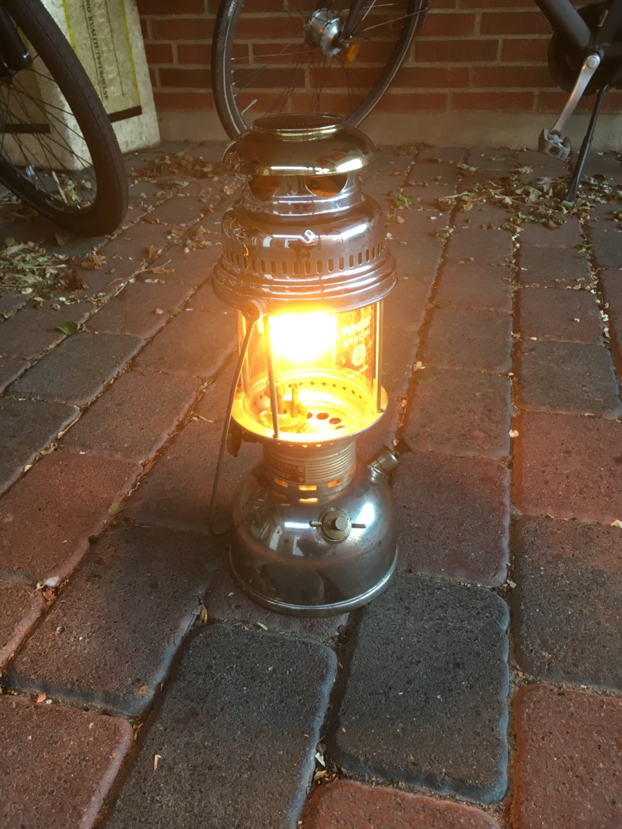

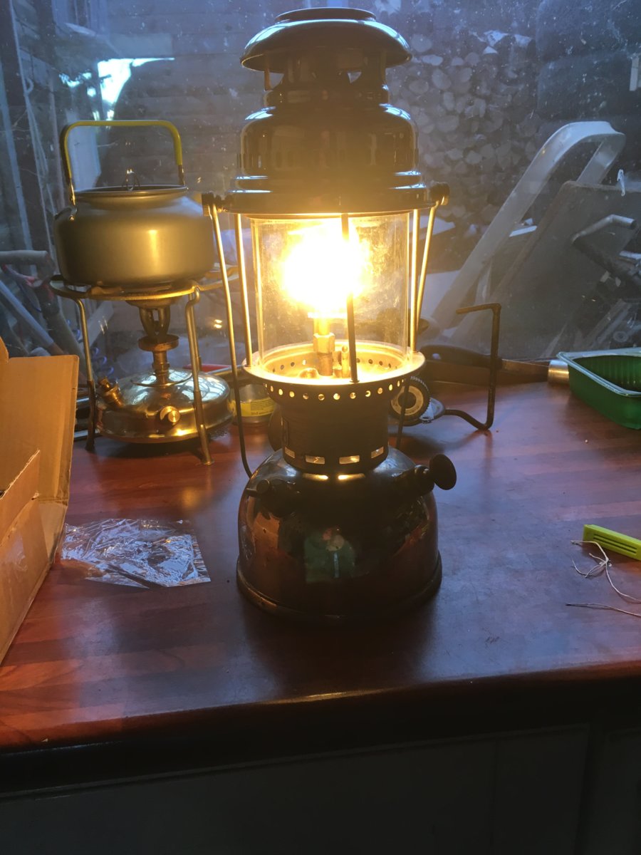

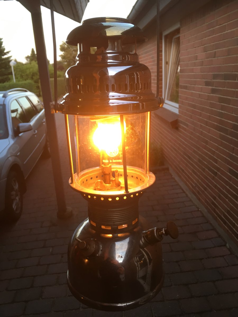

    HOUSTON - we have lift off!
    Filled it with Kero. Placed a 300-400 doublelocked mantel and lit it.
    Thanks to all the the great advice in here, I knew how to burn in the mantel, prior to starting it.
    Discovered that the lead gasket on NRV needed changing. Had one from a Primus stove which fitted nicely.
    Have tweaked the “paddle” in top tube to middle position. Otherwise it’ll burn to bright/White.
    It has been running nice and steady for the last 30 min.
    Now and then it’ll vagaely sound as a bit of a pulse. Nothing disturbing I guess.

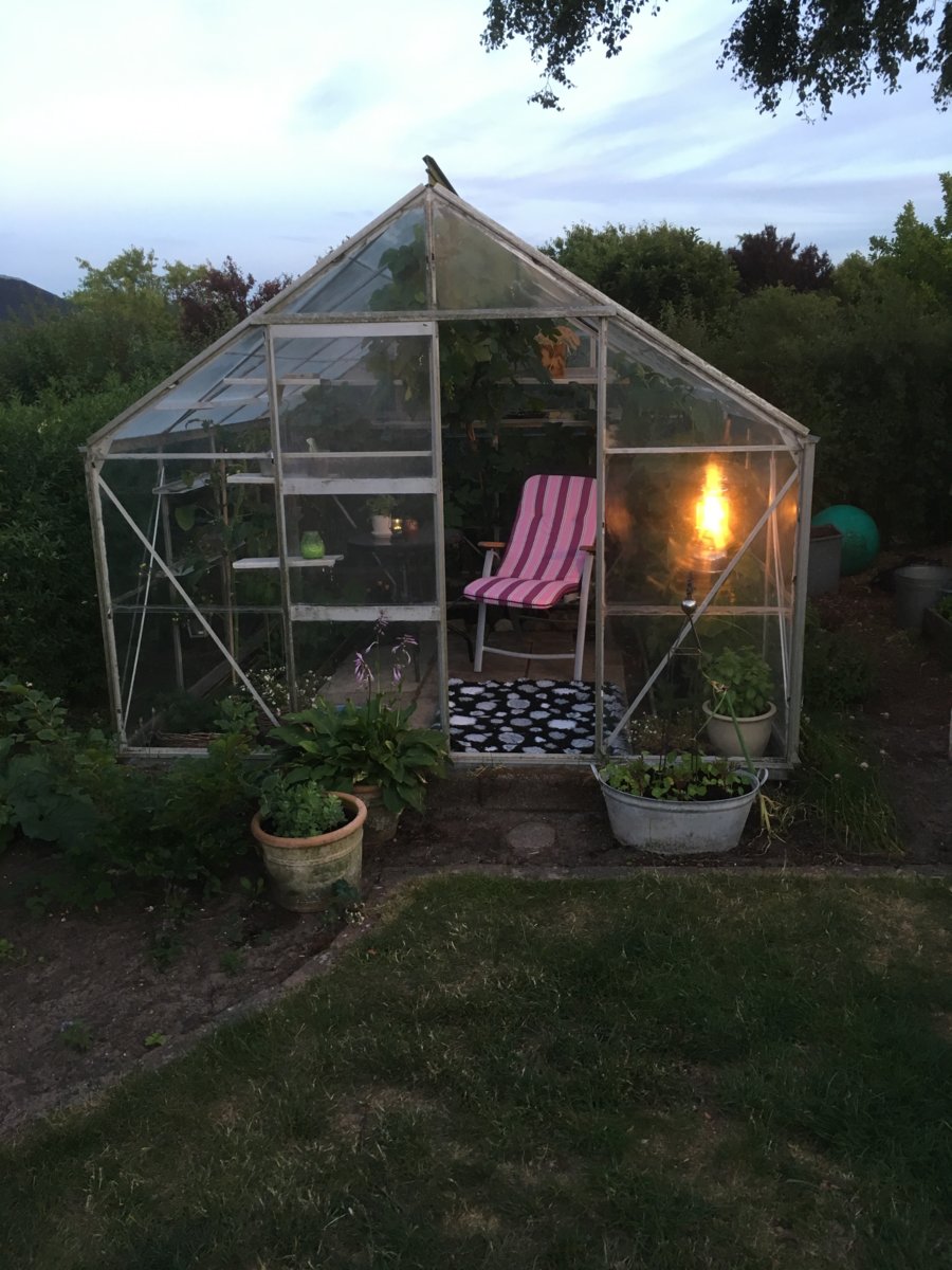

    Wife will test it in her little greenhouse tonight. Depending on the outcome, I might mount a 250 jet, needle and mantle.
    (It is brighter than shown on the pics)
    Thx for all your advice!

    Looking very good, and I like your wife's set up - a proper little home from home with plants and flowers.
