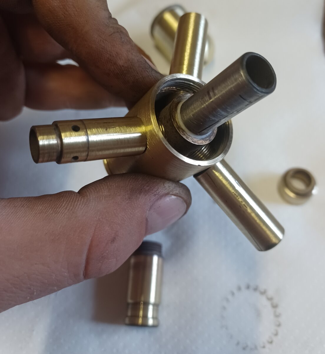

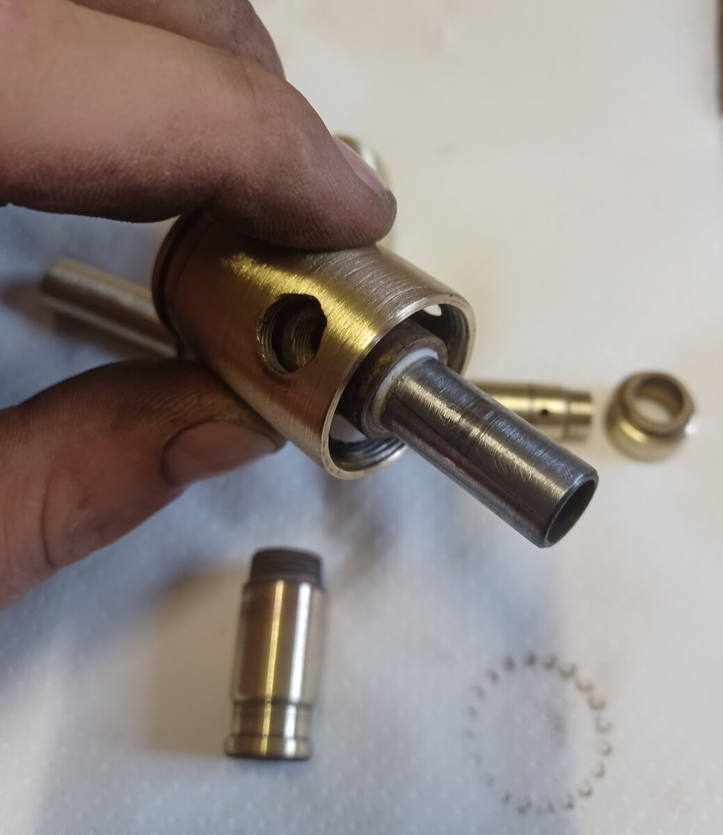

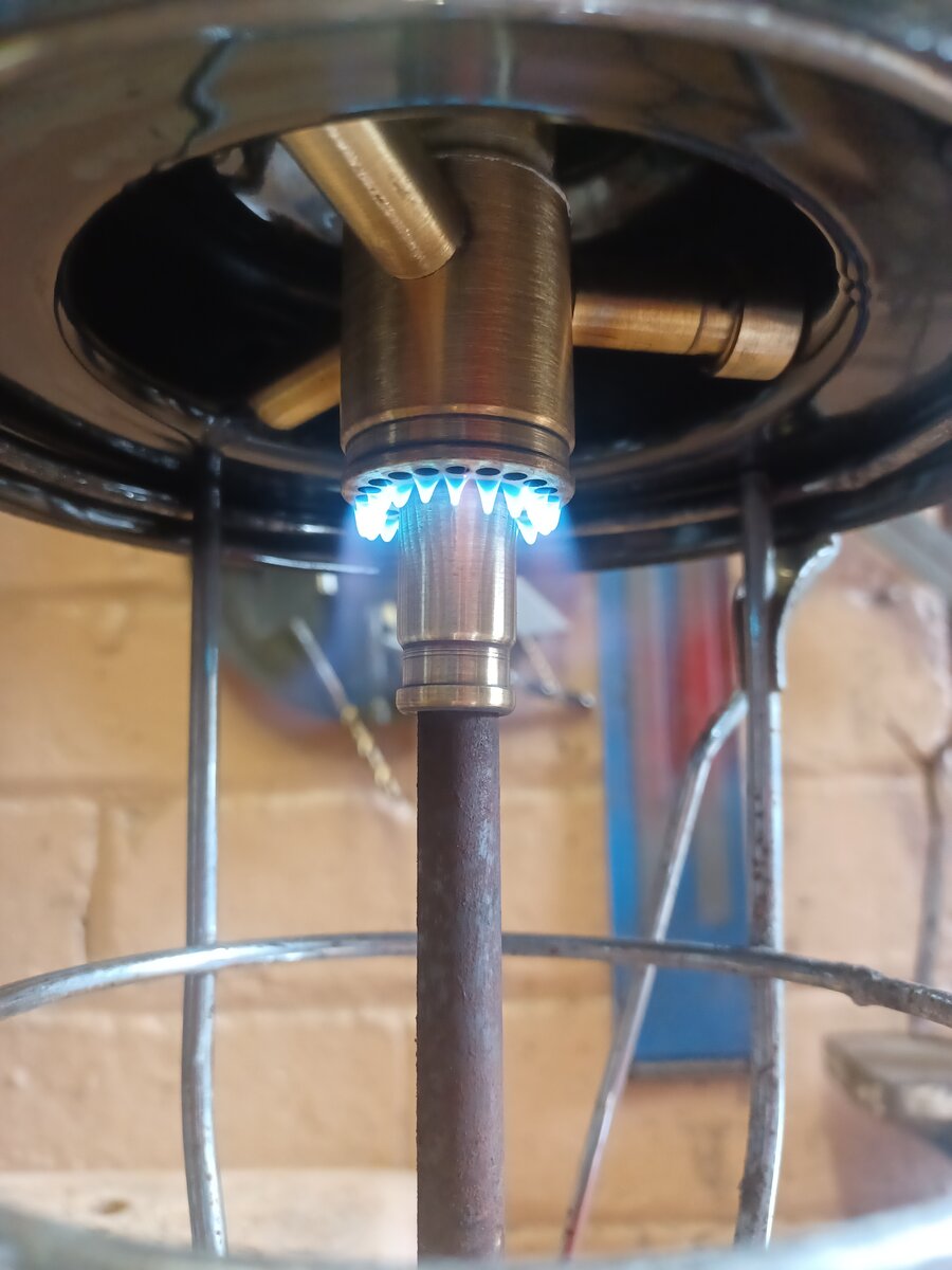

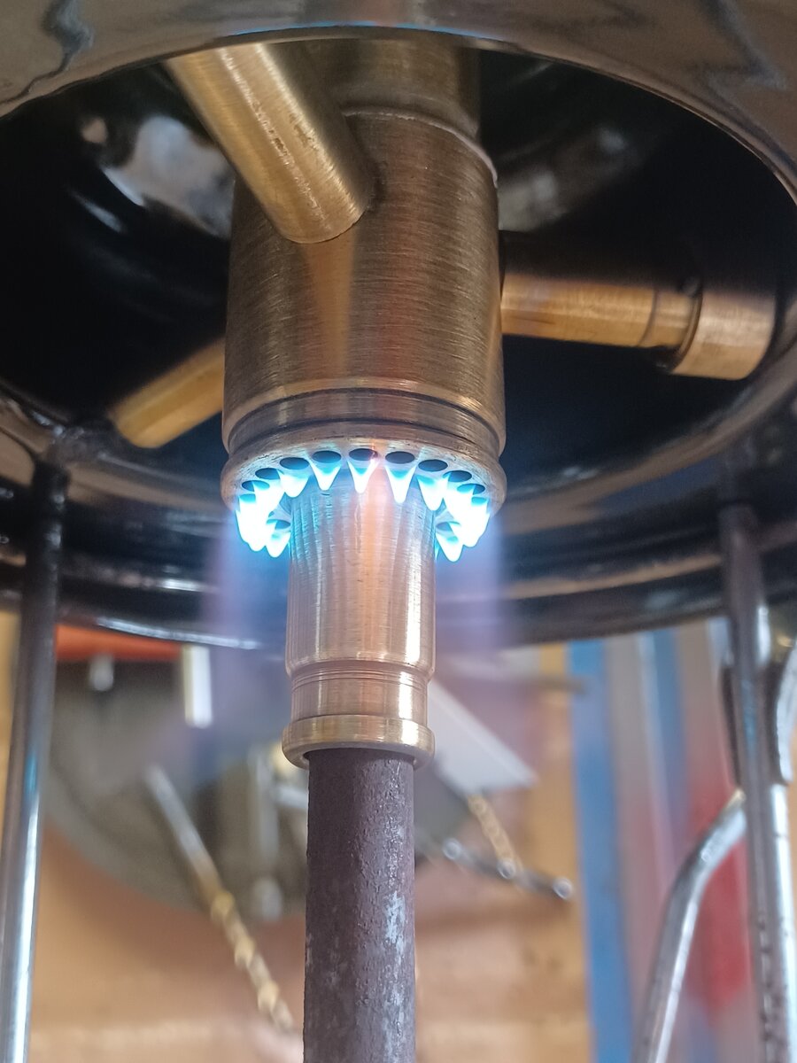

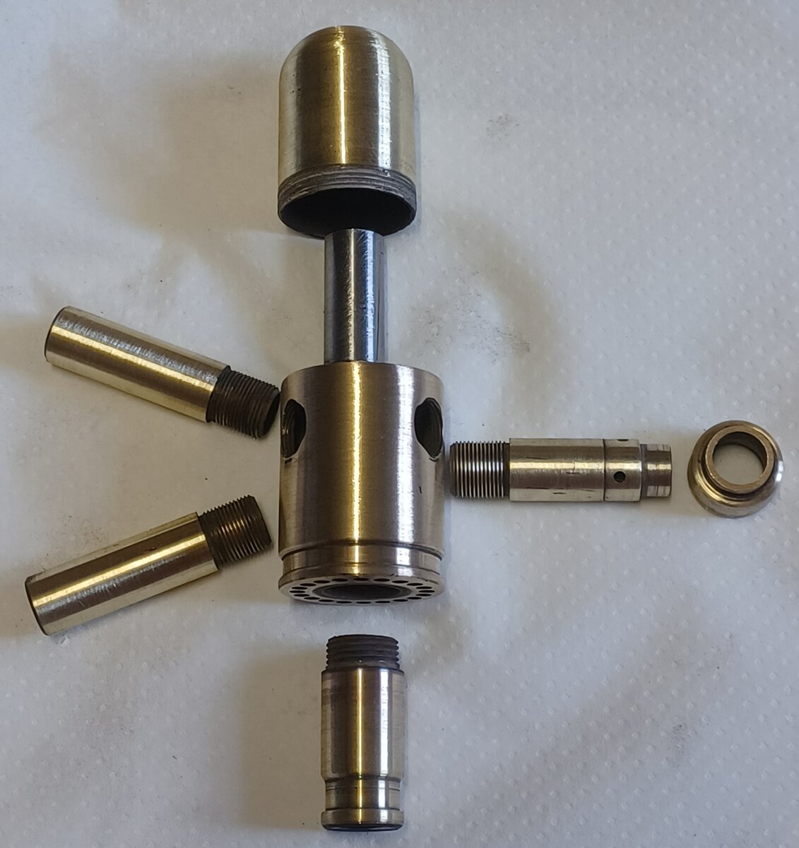

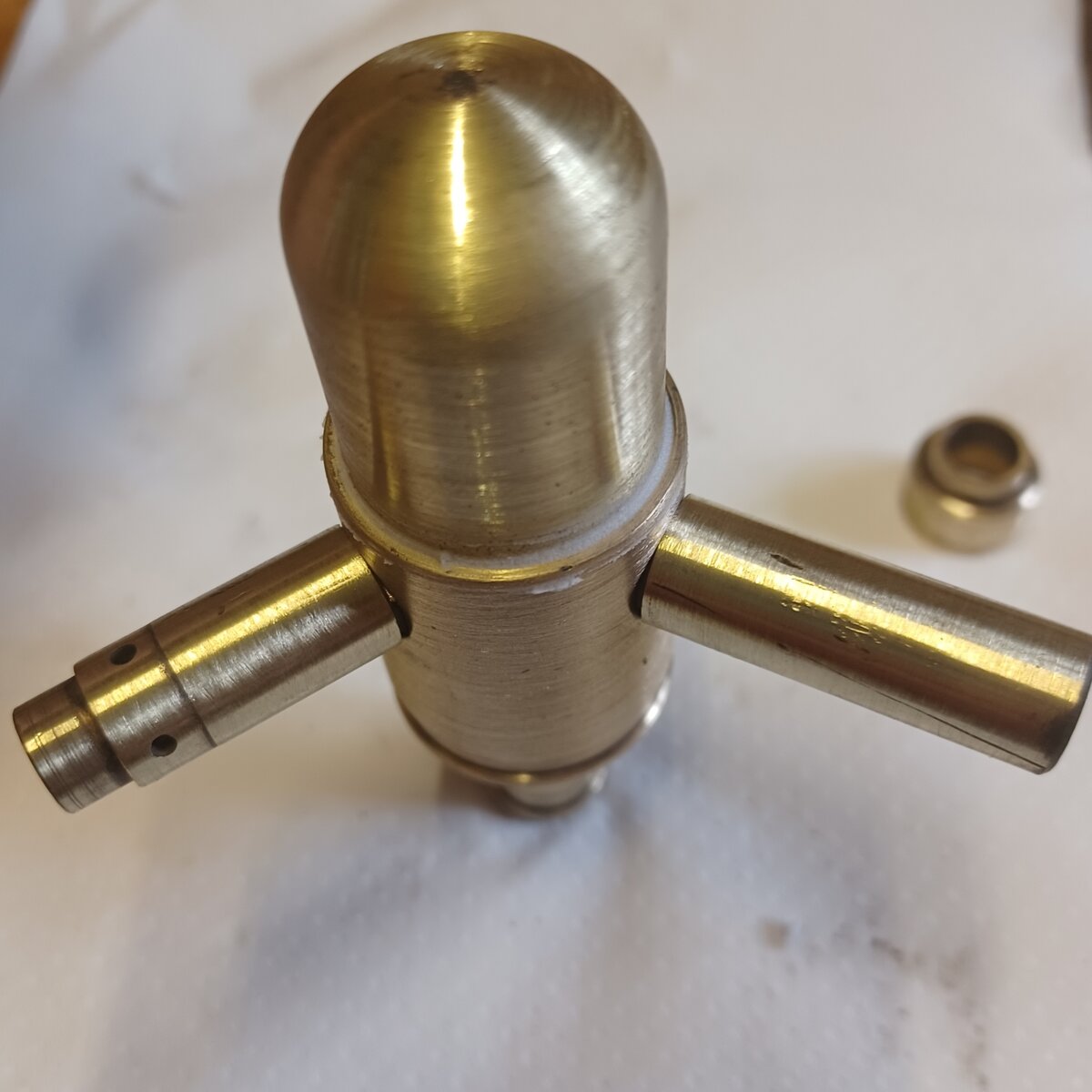

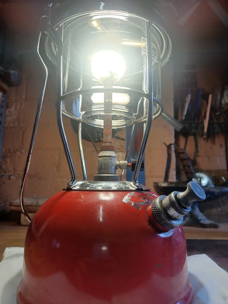

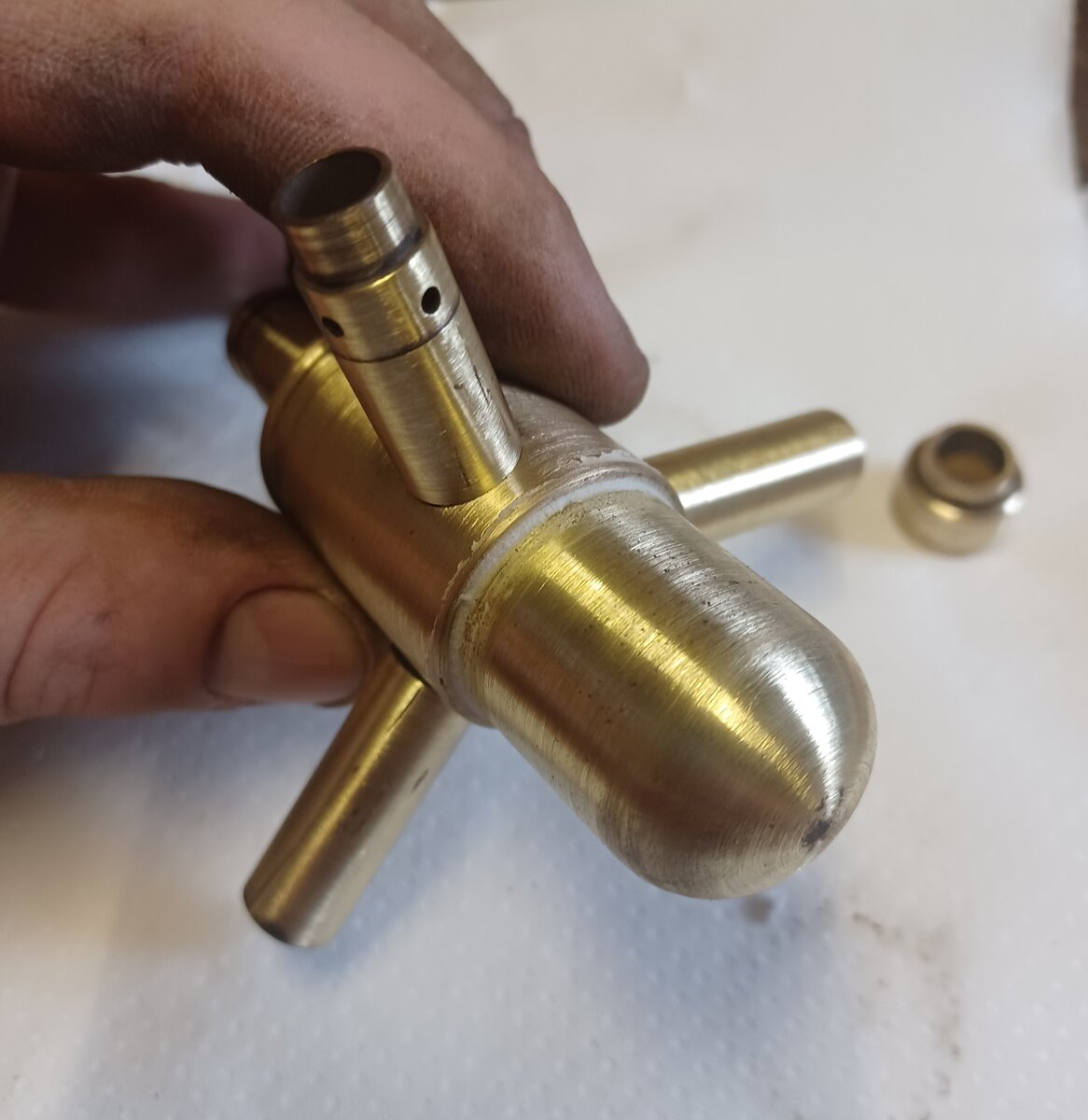

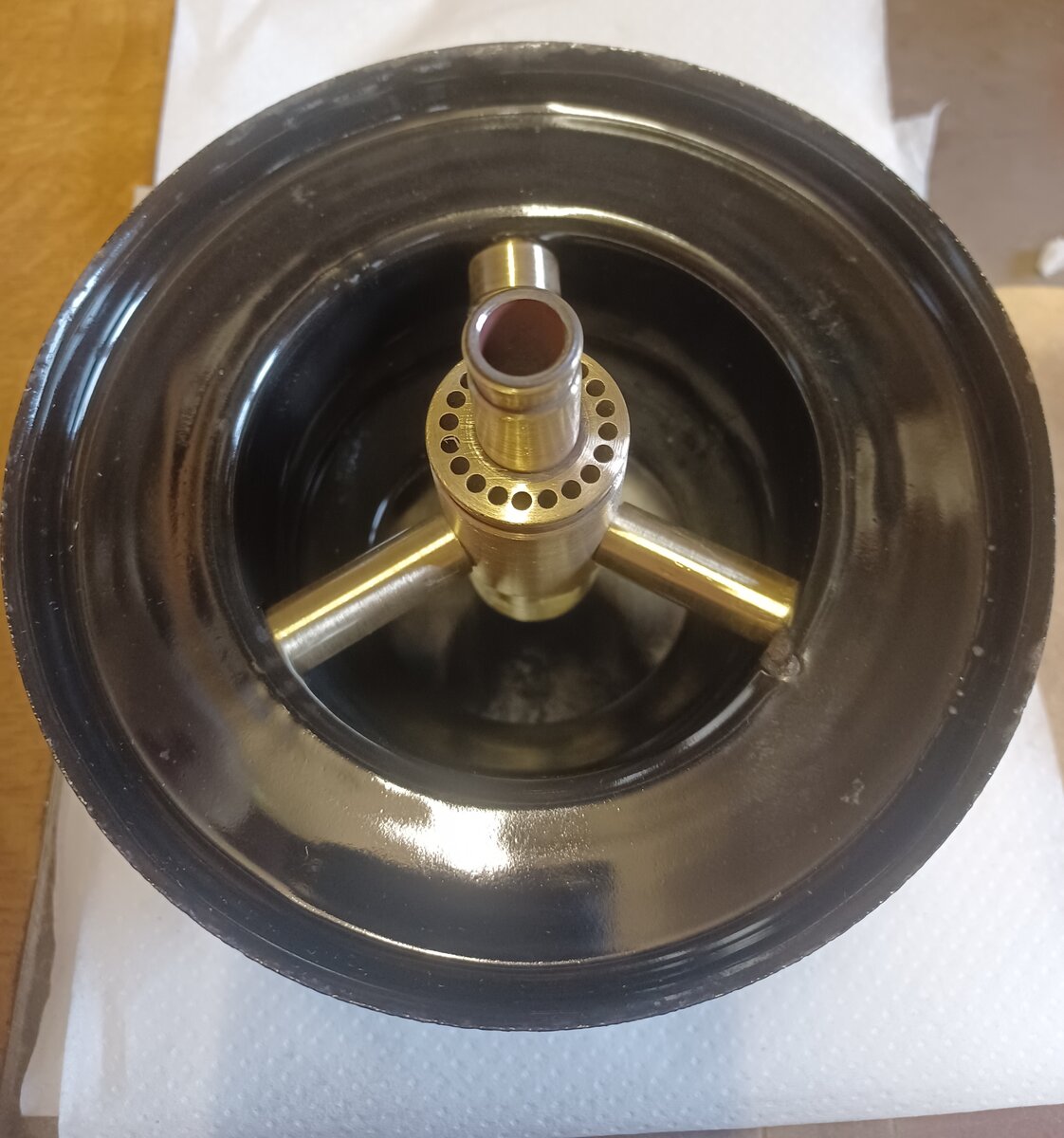

    Hi folks, maybe this has been done many times before, but I just wanted to report success using fire putty/cement in sealing the dome to the burner of a Tilley lamp. This latter was being used indoors, and having checked everything else, the source of smell seemed to have been pretty much eliminated with a very easy fix.
    The photo shows a thin fillet of the fire-putty where the old burner leaked unburnt vapour, causing a smell. I know of others who have silver-brazed this joint, and this may well be better, but not everyone has the materials tools and skill. I did this in 5 mins and so far it works well. IMG20230918145818.jpg IMG20230918150620.jpg

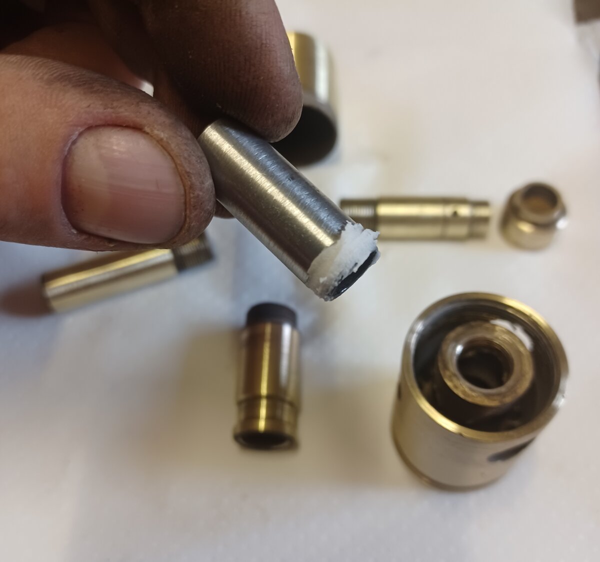

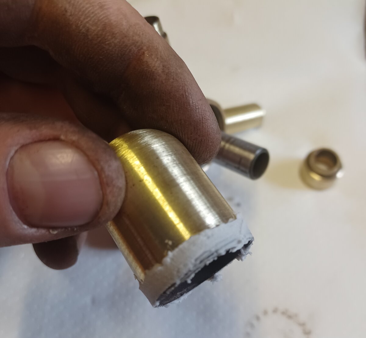

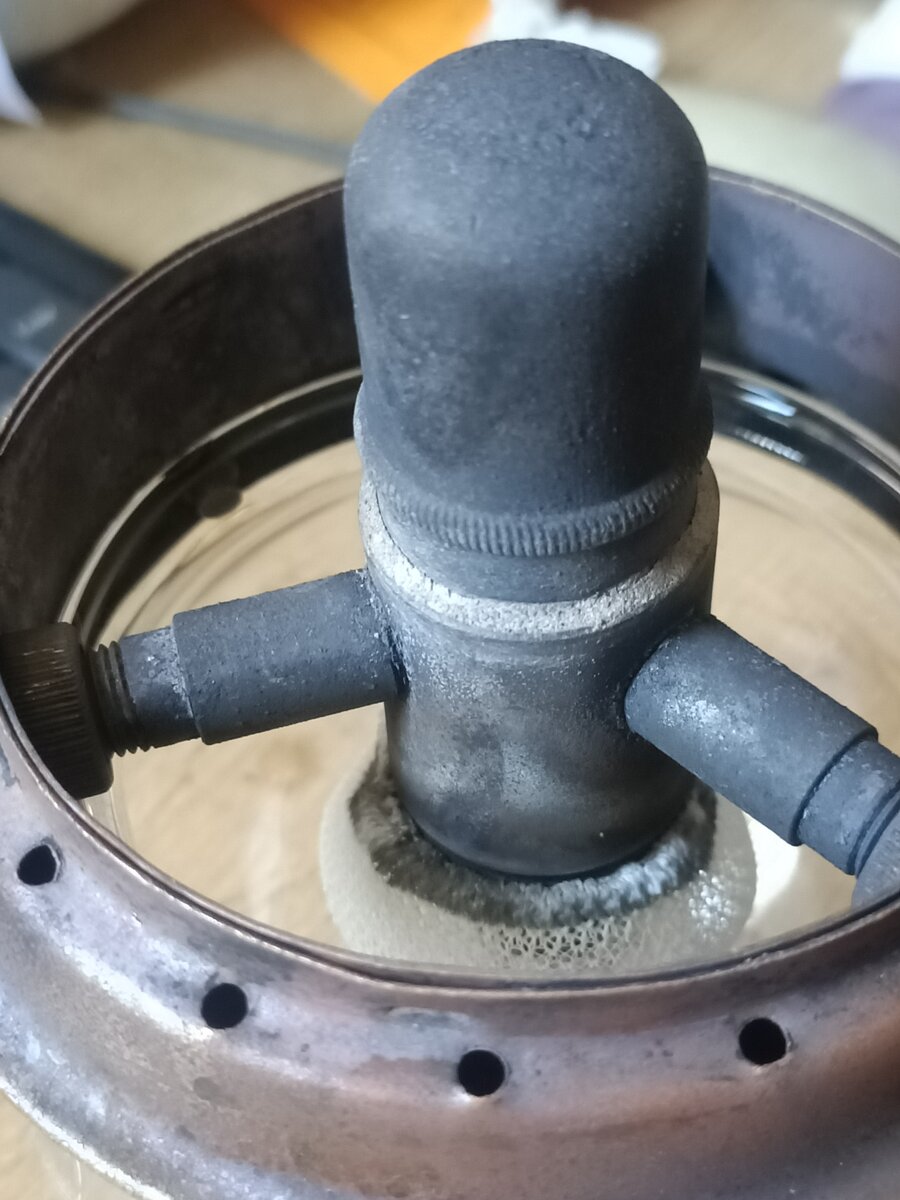

    This is how I always build Burners..

    I have some "refurbished" Tilley burners (ex Jim Dick) that have a red band around where the mixing tube ("dome", Tilley Part 211) screws into the burner body. It looks to me to be high temperature gasket glue as used on engines.
    US Coleman collectors are also fond of using gasket putty and the like for these kind of repairs (as seen on the Coleman Collectors Forum).
