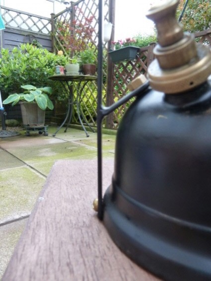

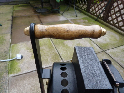

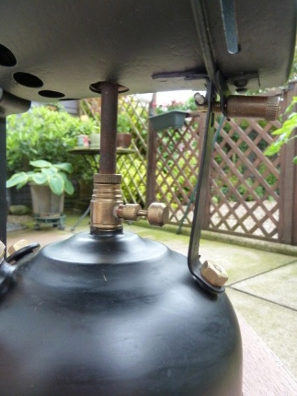

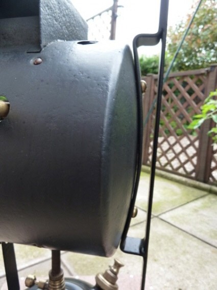

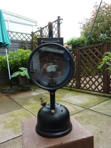

    A few words on the lamps. The Tilly AGM was consructed a few years ago for something different. A spare table lamp base and shot AGM lantern being the basis. A fairly simple job, a couple of adapters and a plate for the top to sit on and the job was done. Care must be taken when lighting as the two stage cock/tap becomes just an on off job. Preheating the vapouriser with a pencil blow torch before turning on is usually enough. Fuel is panel wipe or aspen.
    The smaller of the two lamps was made up from a PL 53 and one of the gas lights that fix to the top of a gas bottle. Again it was to be a bit different. A frame was made to support the lamp and is attatched to the tank at two points, an extra hole being drilled in the base flange. The burner and air tubes are home made, esier than finding originals. The most difficult part of the job was finding the correct position for burner and air tube exits. This lamp burns very brightly and gets a little hot in the handle area, I must put a shield on it. The original idea was for a lamp that resembled an AL 7 and for that reason I beat the round top into a squared off top.

    I have now sorted the image size out so here are a few pics. I can do more if you need more.

    Hello Len, that's a fine lamp and the photos show the construction very well. :thumbup: :clap: :clap: :thumbup:
    Did you convert a standard Tilley burner, or make a burner from scratch?
    You mentioned in an earlier post that the handle gets hot, a heat deflector would help to prevent that, but perhaps the handle could be fitted the other way, so that it points backwards rather than being located over the lamp, it's an idea anyway.
    Thanks for sharing the photos! :thumbup: Jeff.

    Hi Jeff,
    The burner was made from scratch and also the air tubes. It is not possible to convert a standard burner because of the air tube arrangment and the number of burner holes is different. I also made the complete burner assembly for my FL5. I have a good lathe and milling machine so this kind of work is not difficult for me.
    As to the handle arrangment, if I turn it round I would lose the balance, at the moment it is perfect. On a windy night outside its not a problem.

    Hello Len, I reckoned that you must have made the burner from scratch, as I could see the difficulties in converting a standard burner, thanks for the confirmation. :thumbup:
    The balance issue with the handle did occur to me, but I thought that there might be a way around it, perhaps by adding a support to the other end of the handle, but adding a heat deflector would be less work and solve the problem. Jeff.
