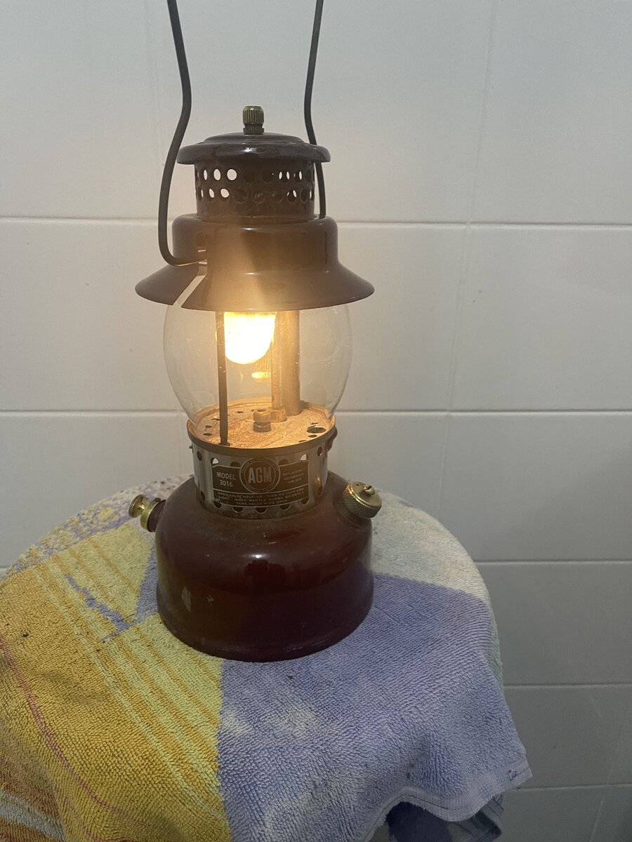

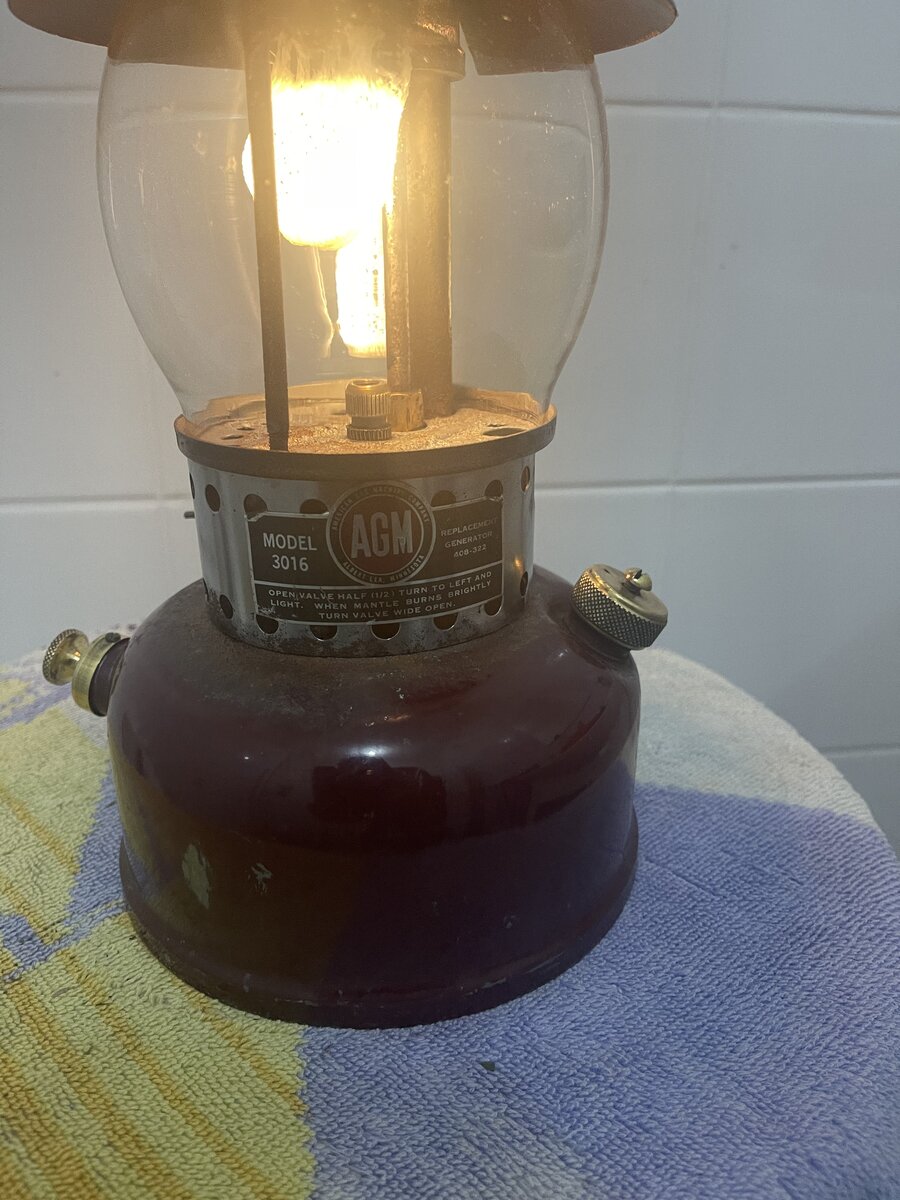

    Hi fellas this is my AGM 3016, runs on shellite. It a very bright lantern. It needs a fuel cap seal but all is good A9091142-8945-4D7C-AFFD-5E886C8D1E70.jpeg 88B3970F-EA59-461F-B692-10B5BF580B60.jpeg 3E741E62-435D-4485-9BCD-8FDBD4FFBA59.jpeg 195DA9C1-725F-4E60-AFCA-D5CE8CED5539.jpeg

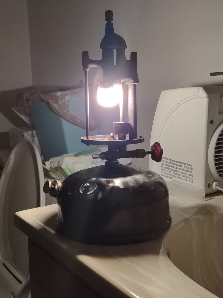

    If you are interested in converting your 3016 to kerosene it is pretty easy to do.
    If you use the jet from a Coleman 201 along with the pricker rod and wire it will run very well on kerosene.
    IMG_20220801_164342710.jpg IMG_20220801_164357998_HDR.jpg IMG_20220801_164504302_HDR.jpg
    Granted I have the wrong sized mantle but it will indeed work.
    There are way too many purist who get upset about this type of conversion.
    If interested PT me and we can discuss what needs to be done to make this work.
