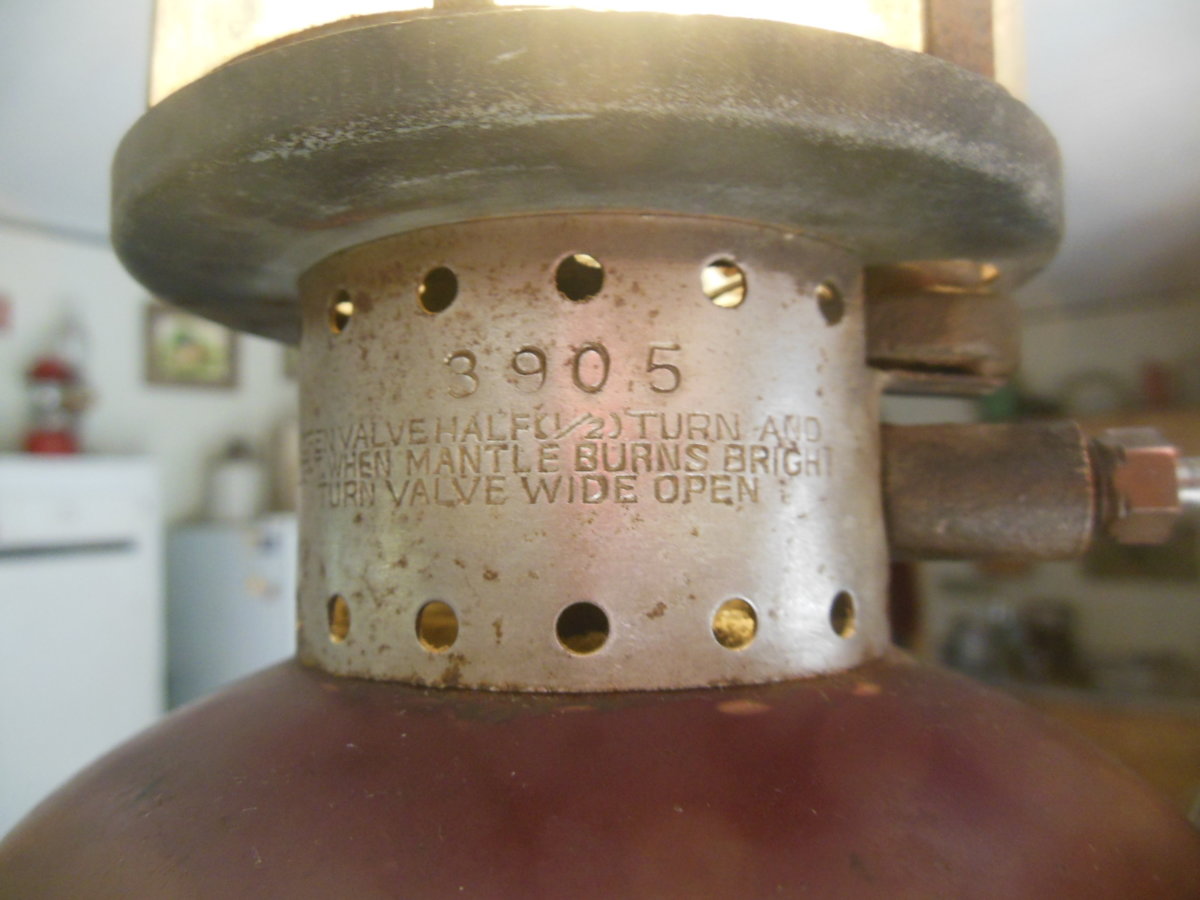

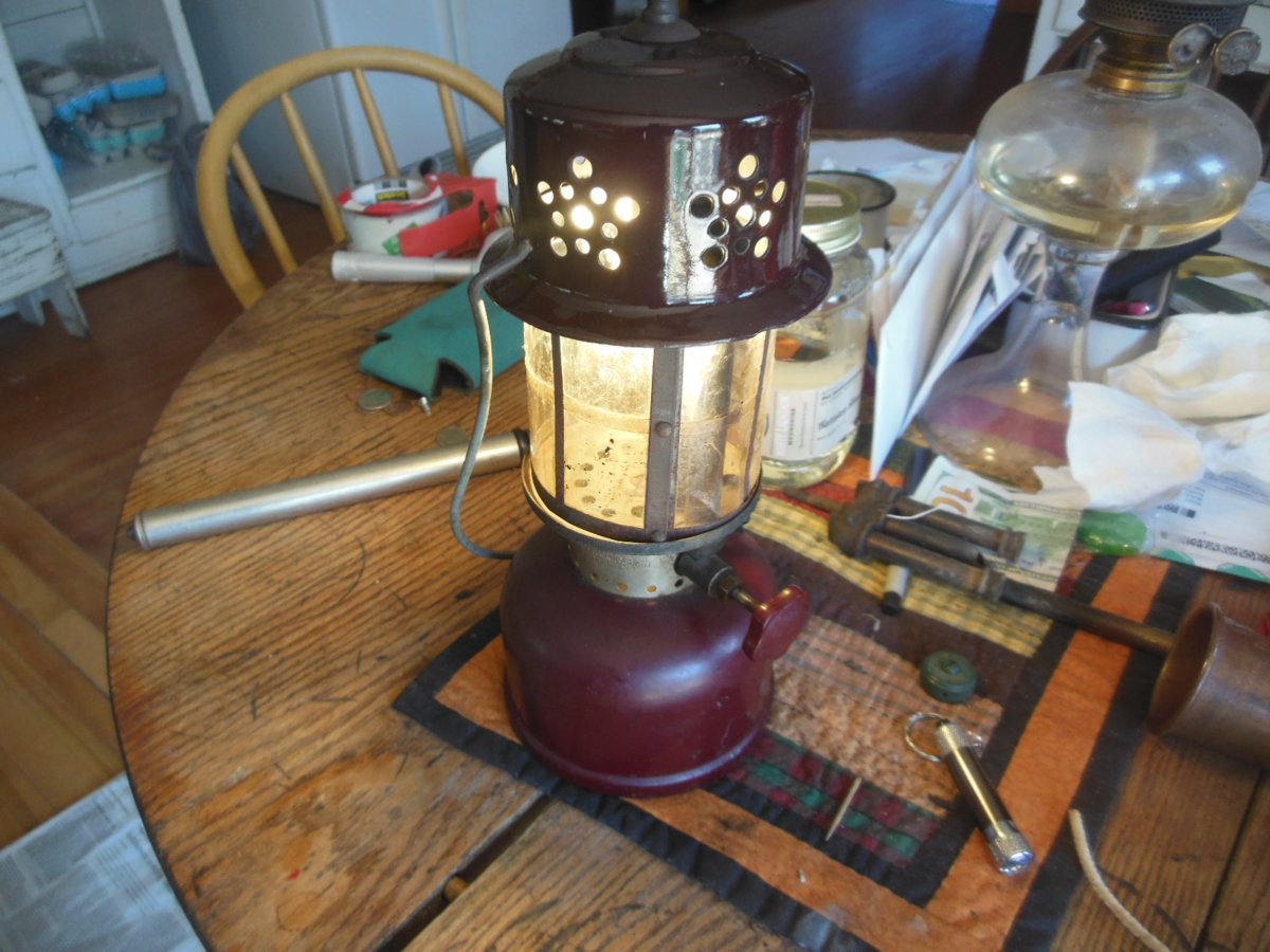

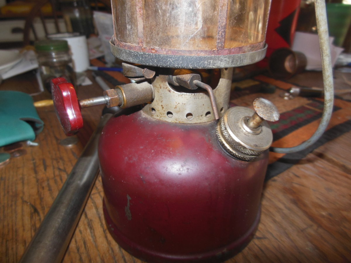

    I found this the other day, and had some time to look it over. I added new seals. there is a flap on the collar above the valve that covers the air inlet. it was running a bit rough, so I blocked the air tube with my knife 3905 AGM 002.JPG 3905 AGM 004.JPG 3905 AGM 003.JPG 3905 AGM 001.JPG , and it brightened and smoothed out. so I bent the flap closer, and its much better. this light has a steel fount. I had thought these were brass founts, and all cracked. I have had a few of the 3705, but this is my first of this model. It needs more cleaning.

    It should look good when it is cleaned up but it is running nicely at the moment. :thumbup:
