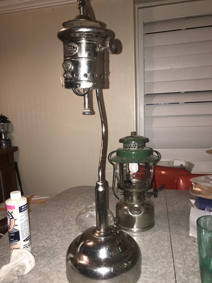

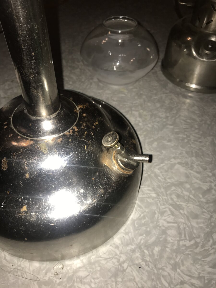

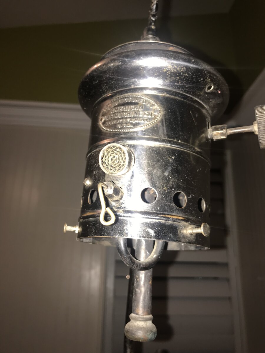

    Good evening I came across this Agm lamp a couple weeks ago at an antique store and brought it home. Couple questions is it a f66 ? What year manufactured? And how do I pressureize font i jabbed 3 Coleman lamps however this font is quite a bit different? B2E2E7F7-3D26-4461-9681-DADB3B8BCF6A.jpeg B38769DA-21BF-4DC1-BD0E-8575EBF30A97.jpeg B38769DA-21BF-4DC1-BD0E-8575EBF30A97.jpeg 12B9326B-2067-45E6-8778-BB0E1ABDC26C.jpeg B2E2E7F7-3D26-4461-9681-DADB3B8BCF6A.jpeg B38769DA-21BF-4DC1-BD0E-8575EBF30A97.jpeg 12B9326B-2067-45E6-8778-BB0E1ABDC26C.jpeg

    It looks like a P66 to me, love the design of these lamps. It’s an old lamp, closing in on 100 quick; and looks to be in pretty good shape.
    As far as pressurizing goes, it’s pretty straight forward, loosen the small screw to allow air into the tank and use an external hand pump to add pressure; tighten down the small screw and you are good to go.
    The original hand pump had a threaded end that would screw into the tube on the cap. It’s tricky but yiu can make a regular Coleman pump work, you’ve just got to line up the whole and hold it in place.

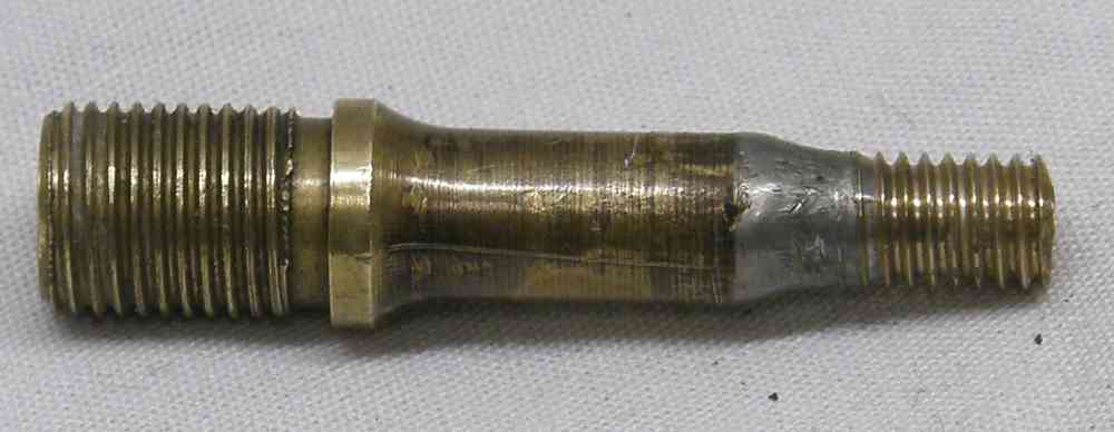

    You can make an adaptor by stripping the rubber from an auto tyre Schrader valve and cutting a thread. I think it's M6. It may not be a perfect fit but a wrap of PTFE/Teflon tape and it will be good enough so you can use a cycle pump. ::Neil::
