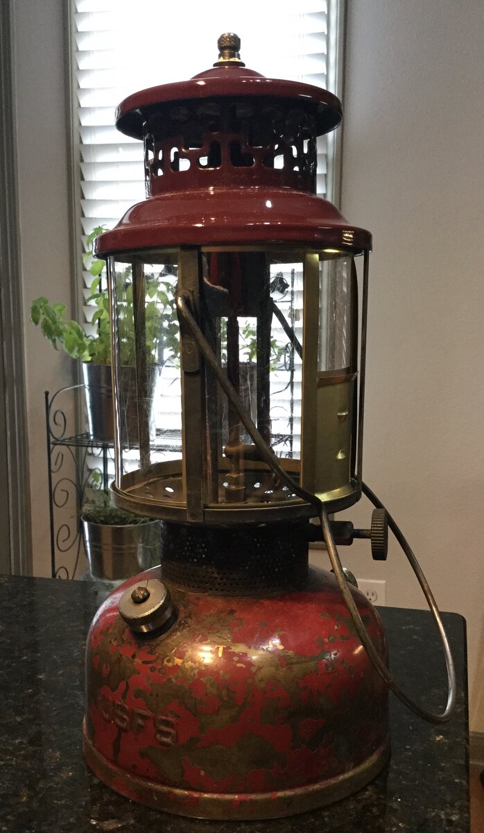

    Original paint ....the repair dates are still visible on the bottom of the fount.....
    And NO stress cracks in the fount which is really an added bonus on any AGM lantern.
    Fred Kuntz mica really adds a nice touch in my opinion ......

    That’s a very nice lantern.
  3. Alex Smith
    Jun 18, 2019
    974
    Central, UK
    That is in really great condition. A very good looking lantern.
    16,574
    A lucky find!:thumbup:

    I don't get envious of other peoples lamps very often but this is one of those times. Congratulations on a wonderful example of GPA history.

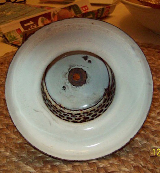

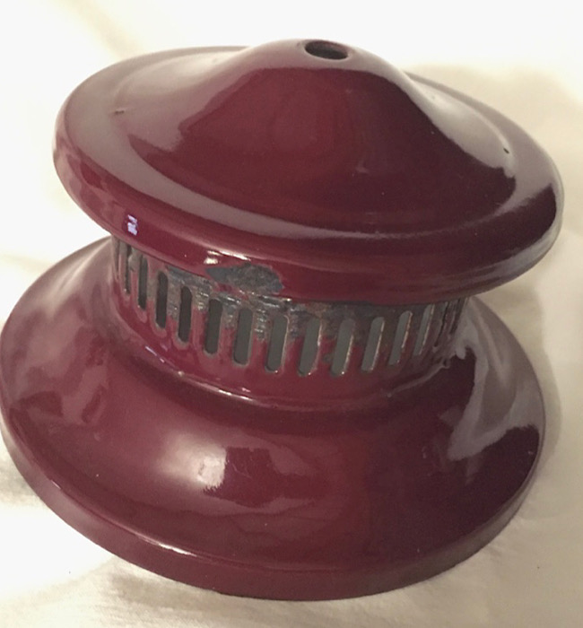

    Nice lantern, other USFS AGM and a few Coleman found with the red vent have a white enameled underside, does this one ?

    Now that’s a lamp that ticks all the boxes! Thanks for sharing.
  10. george
    Great find! As you say, a bonus feature, no stress cracks!

    Looks to be white in pic #3.

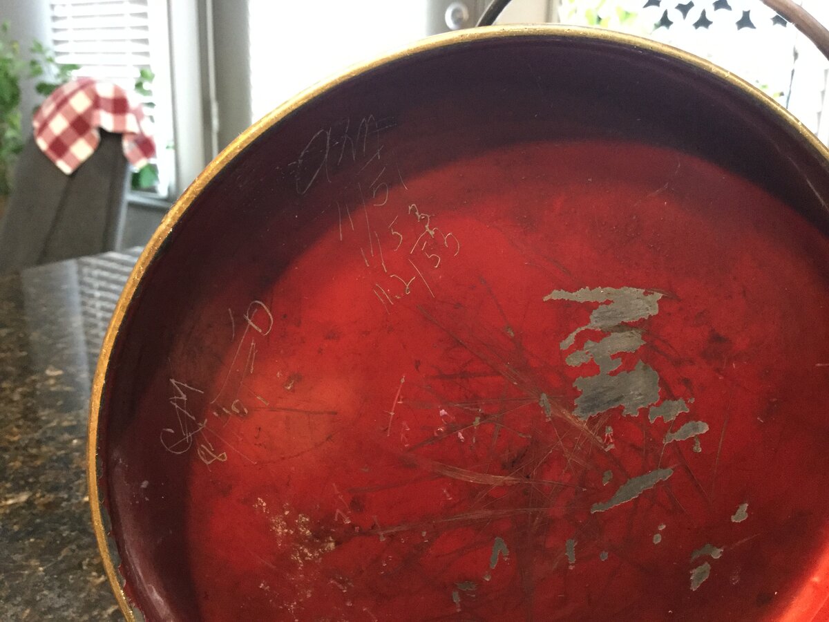

    Can you recall if the Coleman's are date stamped? I do recall finding an article on the fact that both AGM and Coleman had won tenders for Forrest lanterns. This lantern may be able to be dated from that article. It does look like there are some dates scratched on the base plate. Those dates could have been put there at anytime during the lamps history and I wouldn't rely on those dates to date the lamp.

    Matty, id be interested in that article if you don’t mind sharing....
    Yes this has the white vent underneath.....Coleman and AGM both have the red vents with white underneath.......
    Here’s a couple of my Colemans just to compare with CC35A169-F70F-4430-A69E-965BB0A05247.jpeg

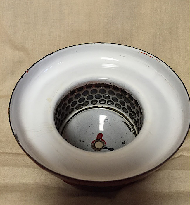

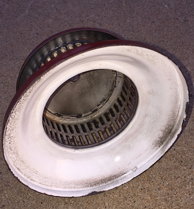

    Matty, the Coleman guide states the embossed type were from “May 1932 to October 1939”. There are other “FS” stamped or stippled type found earlier from “mid 20s to 1939”, the brimless red vents with white underside have also been found on eight lanterns not identified as FS from the mid twenties.
    AGM brimless red vents with white underside are found in both slot screen and art deco screen types.
    A brimless green vent with white underside has also been found on a Government SCS-FCW lantern dated 12/36.
    Coleman :
    AGM slotted
    AGM Art Deco
    Coleman green

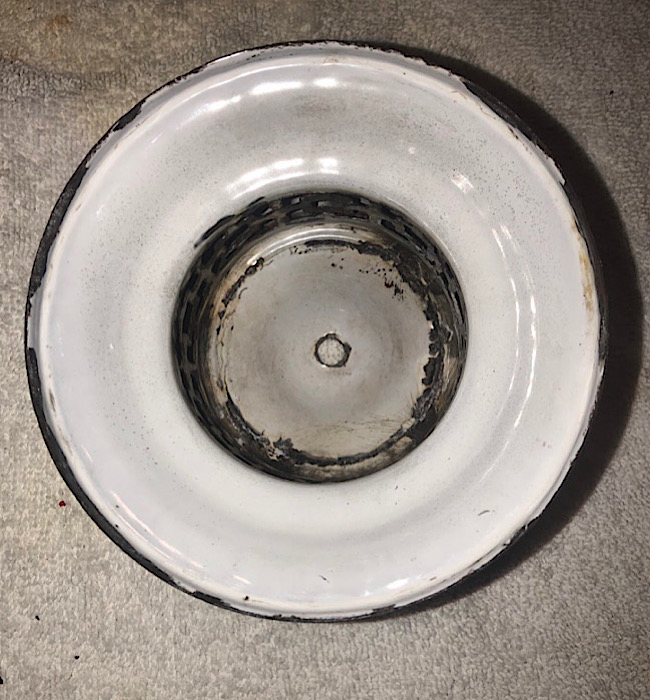

    Matty, There have been three examples found from the early mid 1940s US Model 237 Empire with white underside
    Sea foam
    Green
  19. Akeepsake

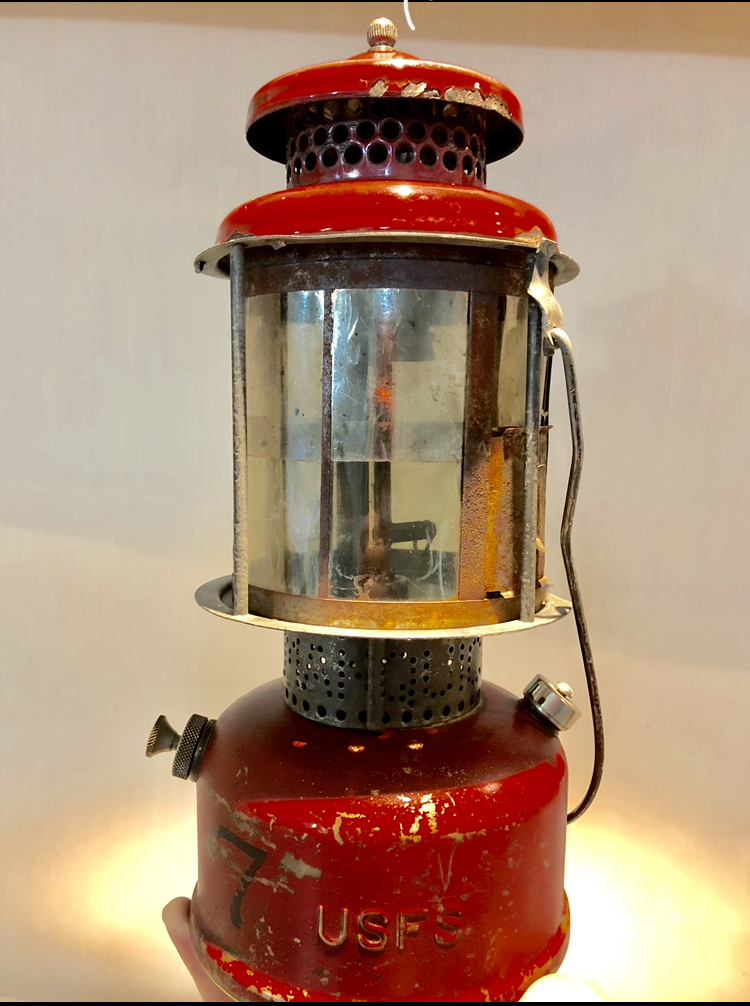

    Nice find Bill and high on my list to go with this one ( May look familiar) C54A9418-EF41-499A-B111-F634E27C9F39.jpeg

    Hi Bill hope all is well mate ! yes I’m surprised to see the #13 on your other USFS ! Did u find them together as they look to be the same style numbers ??
    Love to see what youve turned up
    I’m always keen
    Things are good here In Tassie COVID free for a long time now ... benefits of island living !
