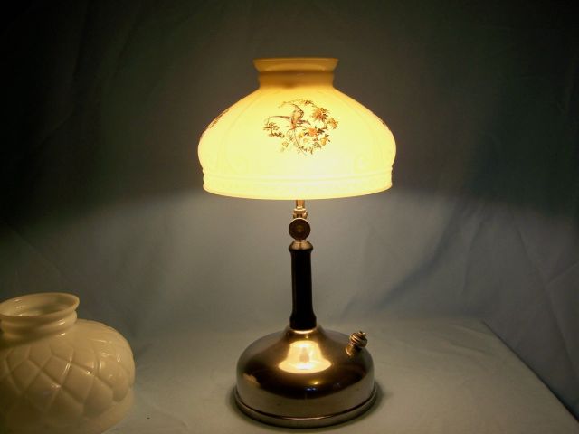

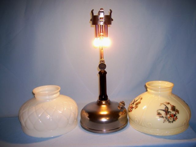

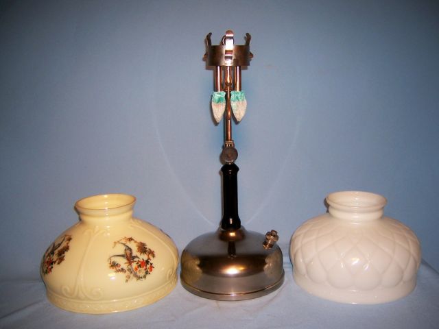

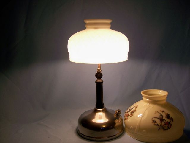

    This was Akron's version of the Coleman CQ. Its "S" generator was lit with a pair of matches much like a Coleman Q99. A separate pump is required for pressure. xIt's shown with a pair of shades that were available for it. The white "Diamond" and the Cremax "Peacock". Aside from the scarcity of the generator these are good running lamps.

    Very cool rare lamp and two proper shades to boot. Mike...

    It's a fine lamp and the shades are excellent! :thumbup:
