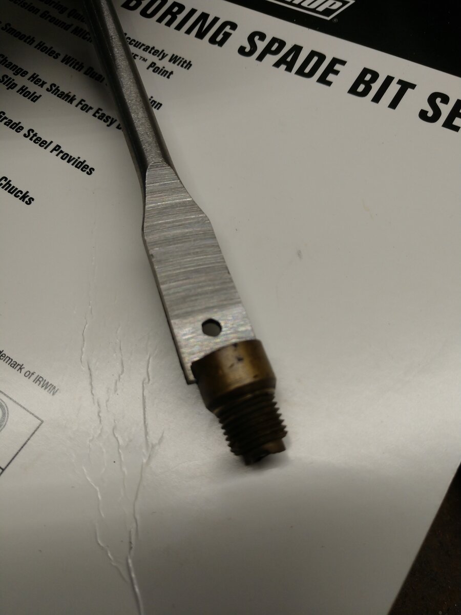

    Thanks guys. Any advice on removing the check valve.
  10. ColinG United Kingdom
    4,816
    You'll probably need to either buy or make a tool to get it out. I made myself one out of a piece of mild steel rod with a slot cut at the end. Here is what it looks like. The thing is, I'm not sure which type of NRV your Akron has? The 'regular' type looks like this:
    The other as used on Bialaddin and Vapalux lanterns looks like this.
    There may be other types too and Coleman use a different system altogether.
    Someone else made a tool for the slot type here...
    Hope this helps.
    Colin
  11. Tom Conway United States
    Jun 8, 2021
    34
    Minnesota
    Thanks Colin.
    Mine looks like the second one. I will have to make a tool like yours with a spade bit. I tried a large screw driver but didn’t get to wild because I didn’t want to jimmy things up.
  12. ColinG United Kingdom
    4,816
    I've tried using a regular screwdriver but it's very easy to chew up the slot which would be disastrous! I'm going to make myself a slot too out ofa flatbit like the one in the second link.
  13. Tom Conway United States
    Jun 8, 2021
    34
    Minnesota
    Well I modified a spade bit and got the check valve out without destroying anything! Next step is to clean or modify it to get it to seat. Seams like it should have a spring behind the check ball, but there is nothing.
