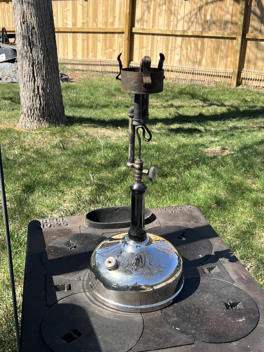

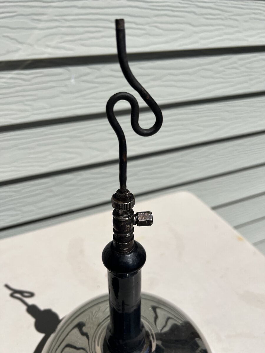

    upload_2025-4-20_11-38-52.jpeg upload_2025-4-20_11-38-11.jpeg upload_2025-4-20_11-38-52.jpeg Thanks for the reply—the Coleman Forum link doesn’t work. Ok i ungunked the check valve—it works. Tank is very clean with isolated corrosion pits. I’ve disassembled the mantle manifold. How does the generator come out? Here are some pics. upload_2025-4-20_11-38-52.jpeg

    Hi @Kevin Goyer and welcome!
    that looks very nice :thumbup:
    the generator on my lantern unscrews so I would gently try that
    regards
    pb

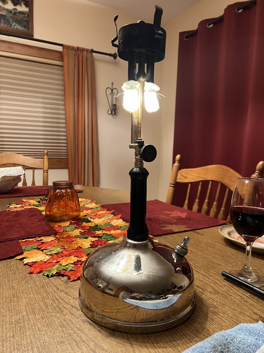

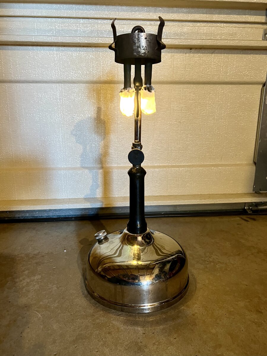

    IMG_9867.jpeg IMG_9862.jpeg Thanks to all replied to my post on refurbishing this original Akron Diamond 102G lamp. The original S generator was clogged and caused strobing of the flame, so i replaced it with a modern generator after i pierced the original trying to clean it. It works well but is not the lamp for me. I will list it on eBay in a couple of days, but if anyone on the forum is interested in it please pm me.

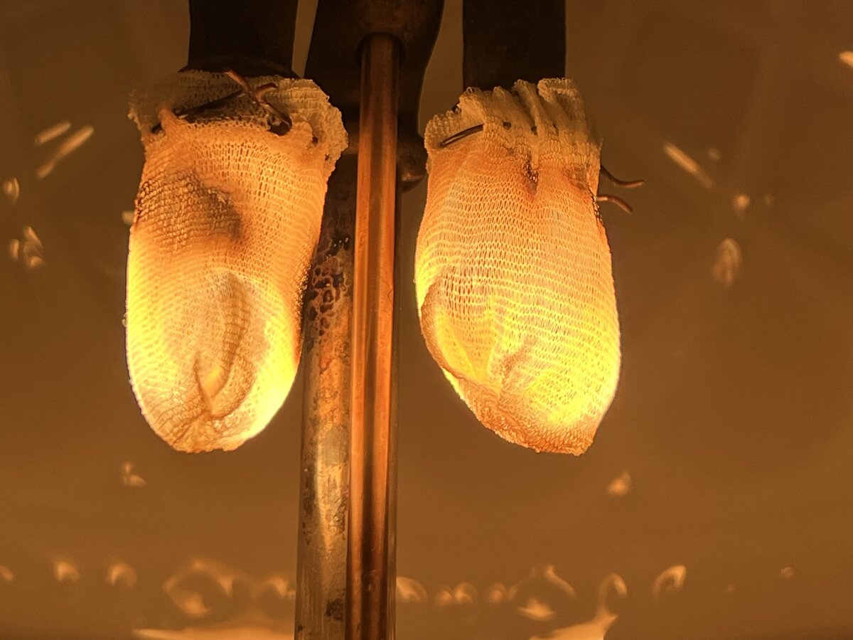

    I’ve figured out that the lamp fuel/air mix is burning too rich and flames are carbonizing the mantle. Part of the problem is strobing caused by irregular heating of the generator. The hotter the flame gets creates more heating of the generator, creating more gas, which creates more flame, heat snd more gas . My thought is to put a sleeve over the generator to confine the heating of the generator, create a consistent gas output and whiter flame
  16. Kevin Goyer
    Kevin Goyer United States Subscriber
    Apr 20, 2025
    41
    Ok a foil sleeve has helped stop the strobing but I’m still getting carbon on my mantles—too little oxygen i suppose. What mantles are recommended for the Akron lamps? Im using regular Coleman clip-ons—i removed the clip and tied on with wire.

    Is there something i should know about the needle valve? There isn’t much range to the regulation of gas flow. I am barely opening the valve and she’s wanting either to shut down or blacken mantles.
    I removed the foil sleeve that i used to modulate the heating of the generator I don’t think it helped. Installed tie-on -21 mantles. I pressurized to 28 psi and she didn’t like that—hissing, blackening the mantles and sputtered once every 100 seconds like clockwork for two hours. Now she’s at 22 psi and purring—for now.

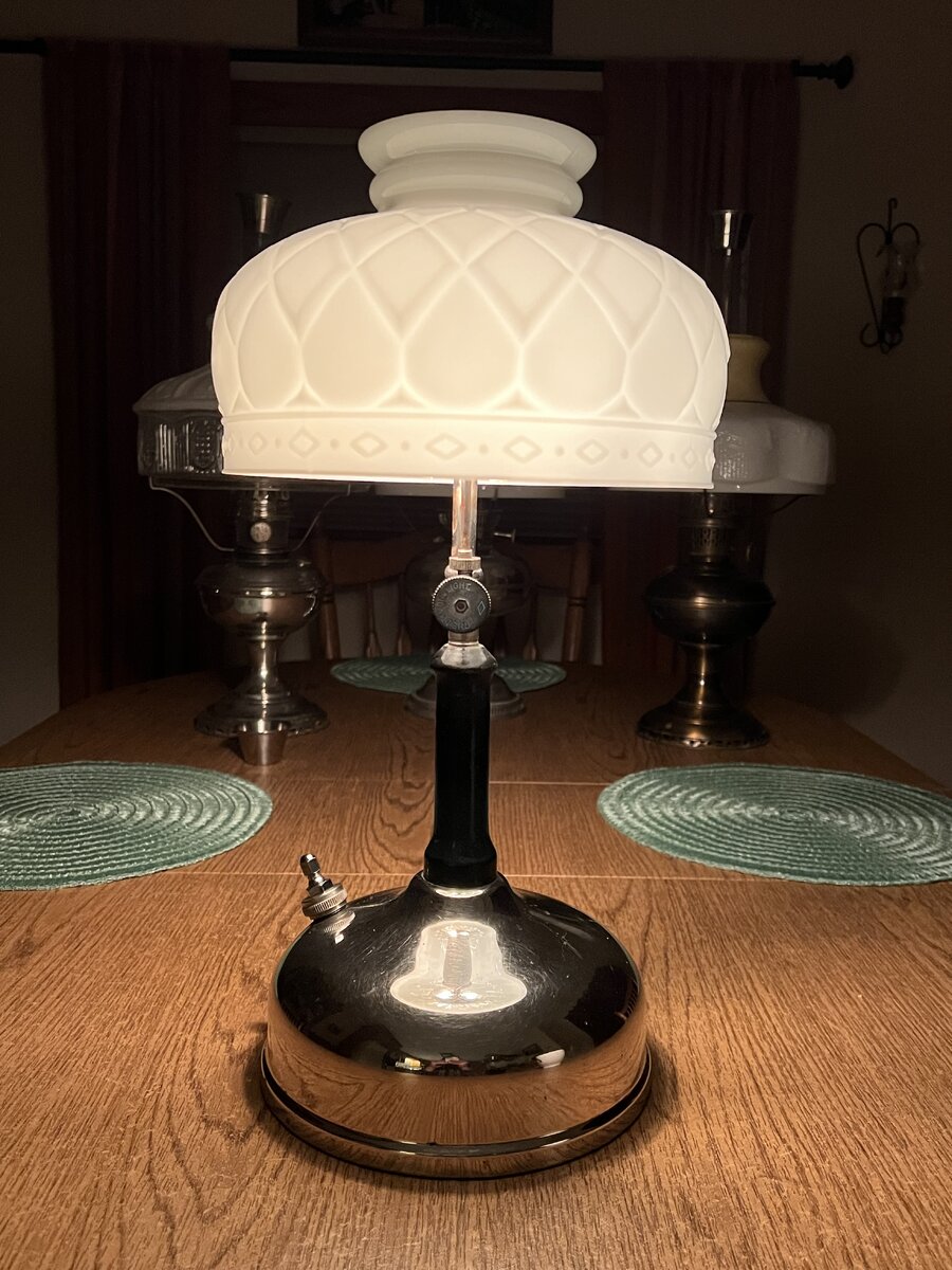

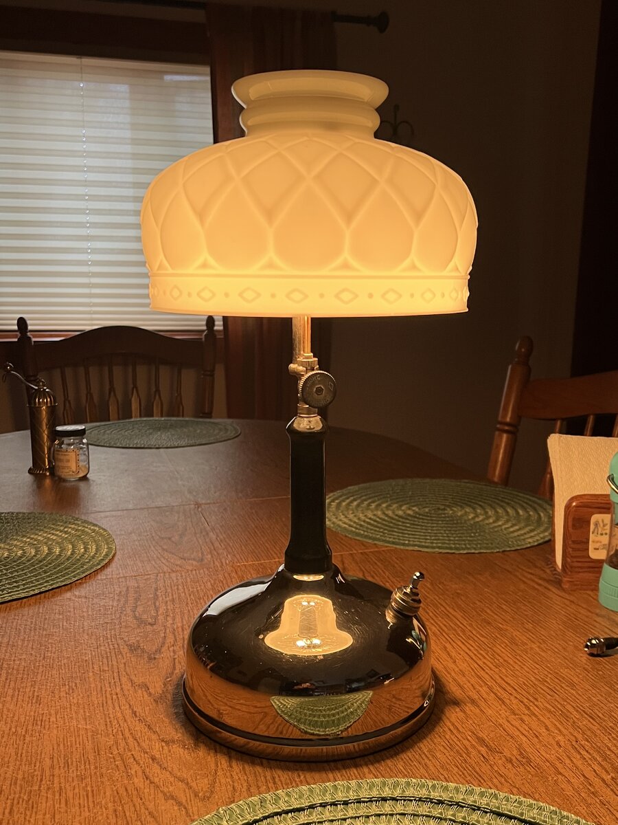

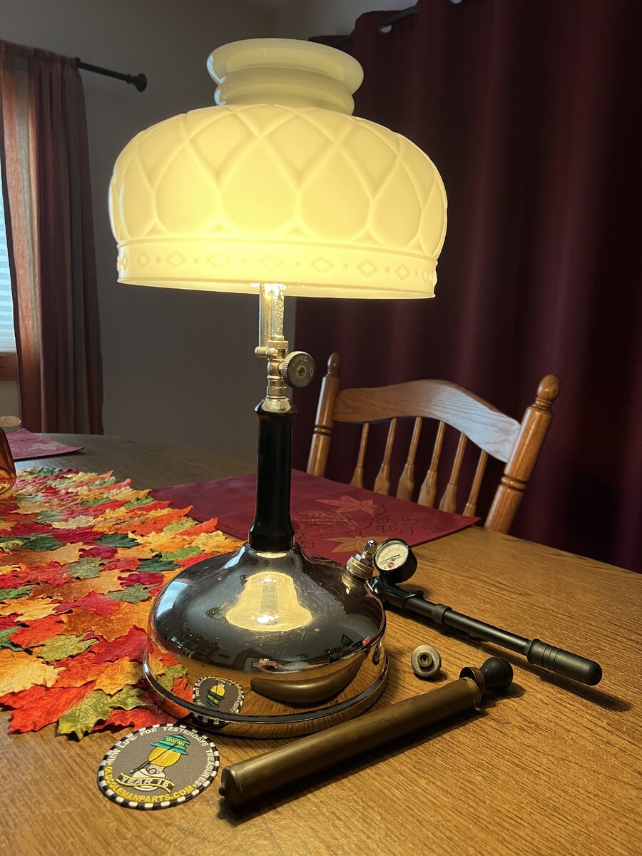

    This lamp is purring like a kitten. Very happy with it. I replaced the fuel valve and generator with parts from a second Akron. IMG_0191.jpeg
