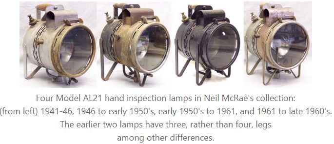

    Can someone fill me in on the history, time line and differences between the Tri and quad footed AL21.
    How much rarer is the 3 leg version? how does that reflect or does it reflect in their value..Cheers (AL21 virgin)

    Thanks to CPL Neil McRae I found the answer in an old article and pictures..

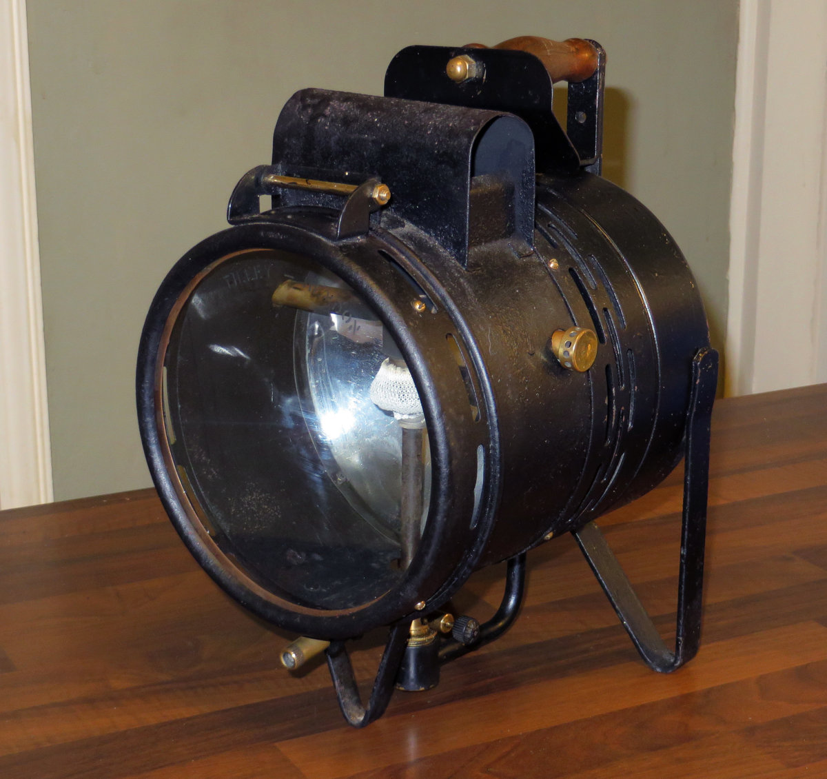

    AL21.jpg I was sort of asking as a prelude to acquiring my very first AL21 and from a member on here, so there may well have been a picture taken of this very lamp somewhere in the picture vaults. She's not immaculate but definitely perfect in my eyes! its funny how, on occasion, these lamps can just grab you! and I think the AL21 is just one such lamp.
    So I guess I ended up answering my own question in the end (well at least finding the information) and this three legged baby is 'second vintage' in the AL21 line up (1946 to early 50's)...and yes, I paid a little more for a three legged version lol only £20 as I bought a 4 legged version at the same time, which my buddy Shaun has now.
