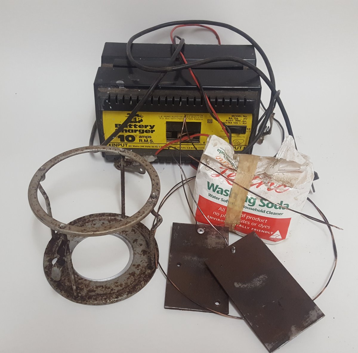

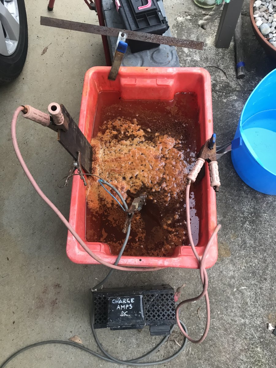

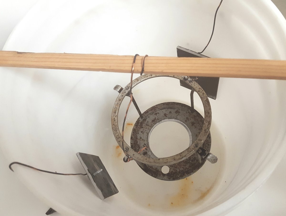

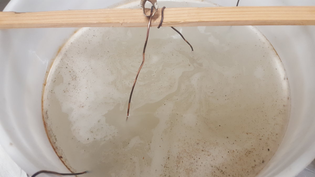

    Turned my eye to the rusty cage today. Have watched many youtube vids on electrolysis for rust removal so thought I'd give it a go.
    Needed a bucket, washing soda (sodium carbonate) for electrolyte, couple of steel offcuts for the anodes, old battery charger, some wire. Dissolved the washing soda in hot water, filled bucket, connected all up with the cage as the cathode. Now bubbling away so something going on. Will be interesting.

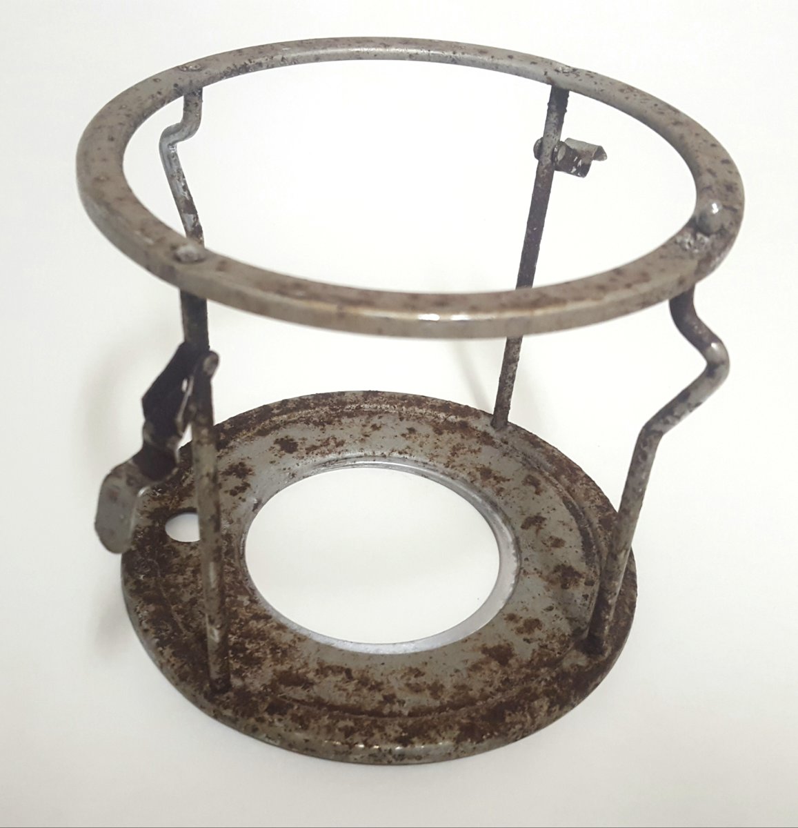

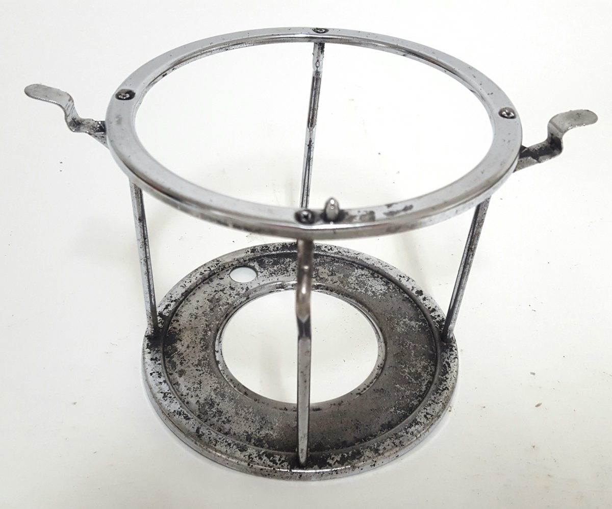

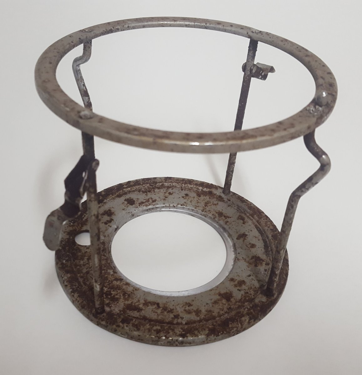

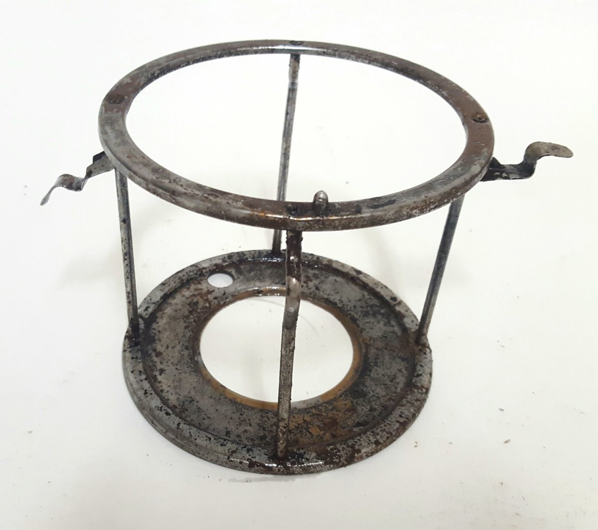

    So I took the cage out of the electrolyte bath after 18hrs at 6 volts. Apparantly the rust is converted to magnetite, which is a stable form of iron oxide. Gave it a quick scrub and pretty pleased with the results.
    Image 1 - before shot.
    Image 2 - as taken from electrolyte bath.
    Image 3 - after scrub down.
    Cheers Michael.

    I too have been meaning to try it for a long time but was worried about the setup. In reality it was very easy indeed and no really bad chemicals involved. Develops some hydrogen that you need to be aware of as far as enclosed spaces is concerned. Apart from that I recommend it and you can use it on any rusted metal. Just takes a little while.

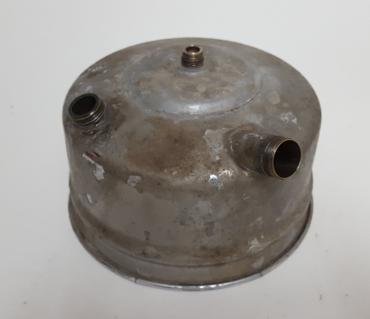

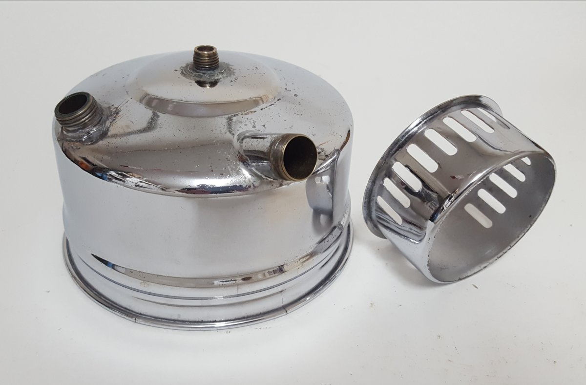

    Okay, I attacked my Aladdin fount and collar today. Removed the home applied paint job. Probably lucky it was on as protected the chrome quite a bit. Gave them a polish. Came up ok. Fount has some expected pitting on top and looks like it had a repair around the filler hole. Before and after shots attached.
    Cheers Michael

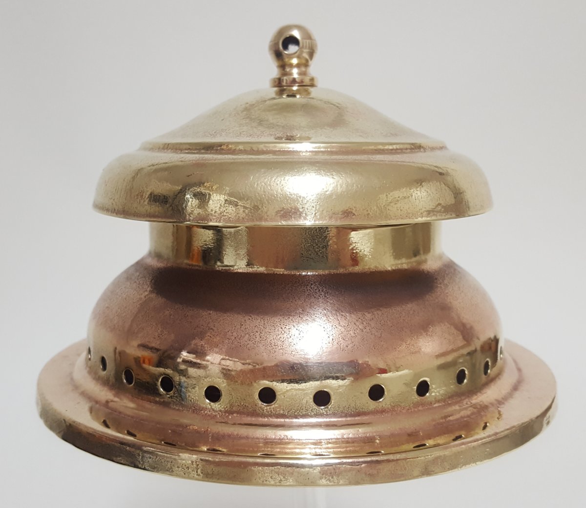

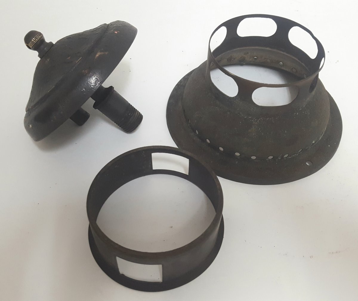

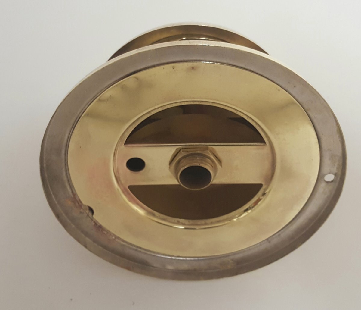

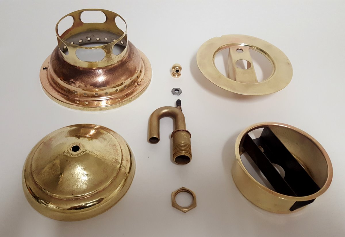

    Working on the hood today. On cleaning found the enamel was basically shot so decided to remove it. Well, one thing led to another. You know how it goes.
    Before and afters attached.
  20. Nils Stephenson
    3,410
    If the hood is brass then it wouldn't have been enamelled. To my knowledge, the enamelled ones were always steel. With a chrome (or nickel) tank it would have had a chrome (or nickel) hood as well. Maybe the chrome has been removed at some stage or this is an earlier top?
  21. Zigfire
    Zigfire Australia Subscriber
    Mar 20, 2020
    102
    Sydney, Australia
    Thanks Nils, that's interesting as when I fired the lamp up initially the hood poped and cracked just like an enameled hood does occasionally. As it was thick and crusty I assumed it was enameled, so perhaps it wasnt then. Definitely not chromed. Perhaps it was nickel plated, in which case I would like to get it re-plated.
