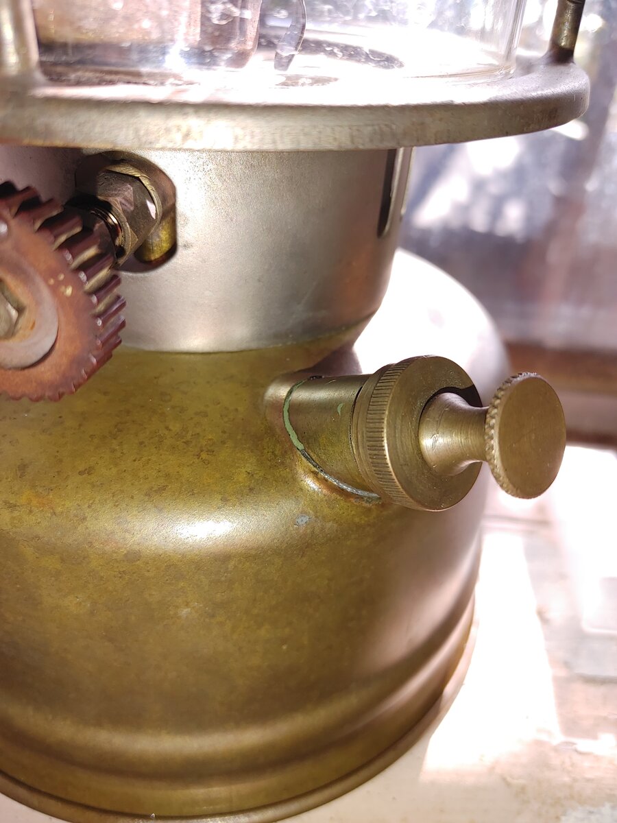

    Folks, have what appears to be a brass font on my Aladdin 1A:
    My issue is the pump tube is leaking where it joins with font. Can this be repaired by applying heat, removing pump tube, cleaning spotlessly and then re-soldering (solder on account it needs strength not resistance to excessive heat?)
    If possible, any tips and/or tricks gladly accepted.
    John
    You could try heating the area in situ and see if the solder runs & reseals.
    Otherwise, as you describe above.
