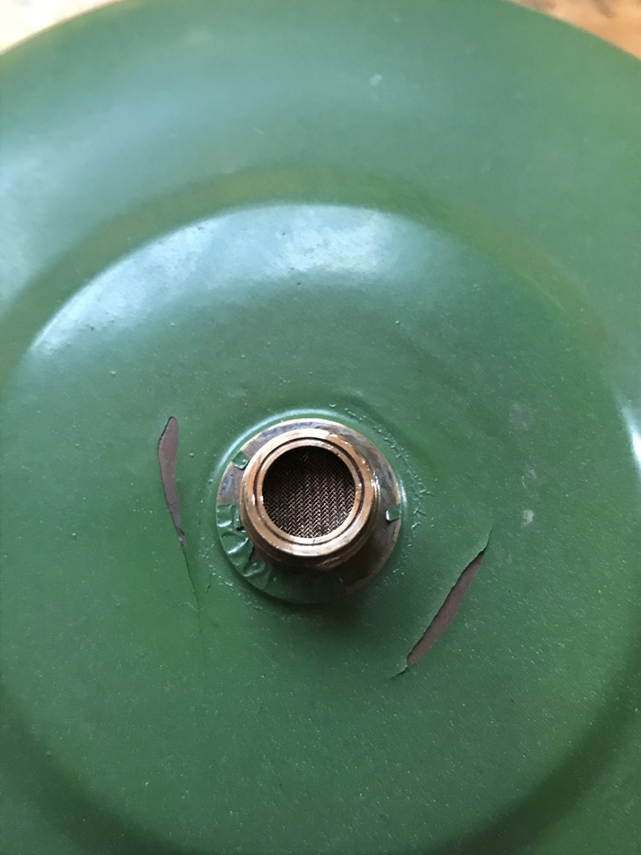

    In the top of the tank, under the valve manifold, there is a fine metal mesh screen. Maybe this is blocked and needs cleaning.
    The following picture shows the screen in its position.
    You will need to screw off the valve manifold to get to it. To remove the screen for cleaning, use a pin or a darning needle to worry it out, it’s an interference fit.
    The Aladdin 1A valve manifolds are usually installed quite tightly. To remove it, I upended the fount, put the valve body in the vice and then gripping the fount in both hands, unscrewed it. This method gives a better mechanical advantage.

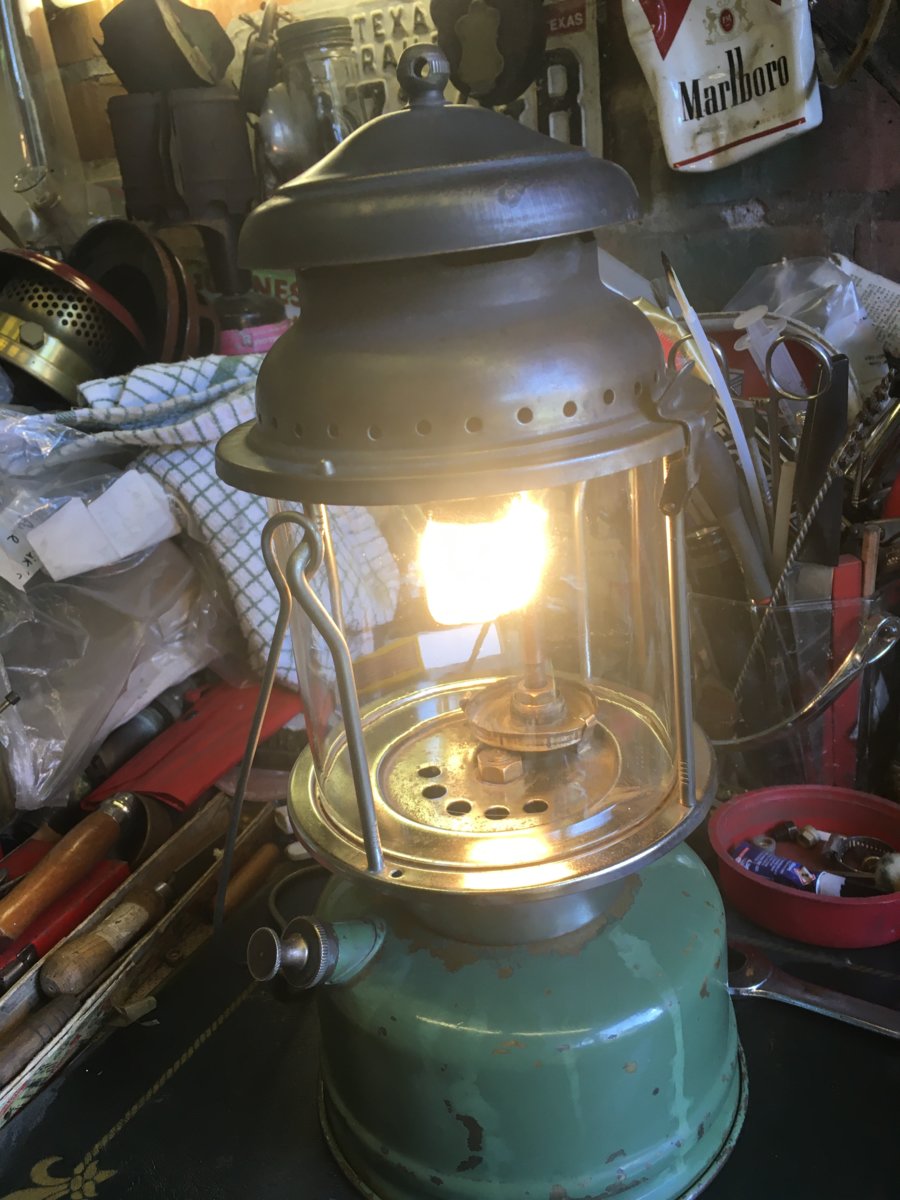

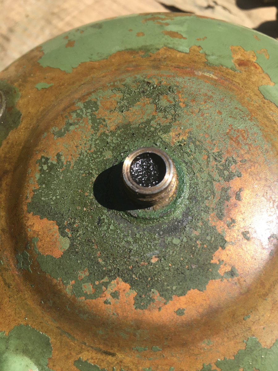

    D61144F9-874F-42DB-AE11-E437C7F8C121.jpeg Sorted Pete, thanks a lot for the advice the brass gauze was solid,it’s working fine now 8C34CDCC-482E-4811-A2EB-742433F7D140.jpeg
  5. AussiePete
    @Greenboy23
    Well done mate. I love the money shot coz it’s confirmation of a well done fettle.
    Congratulations.
    I’m happy to have been able to help.
