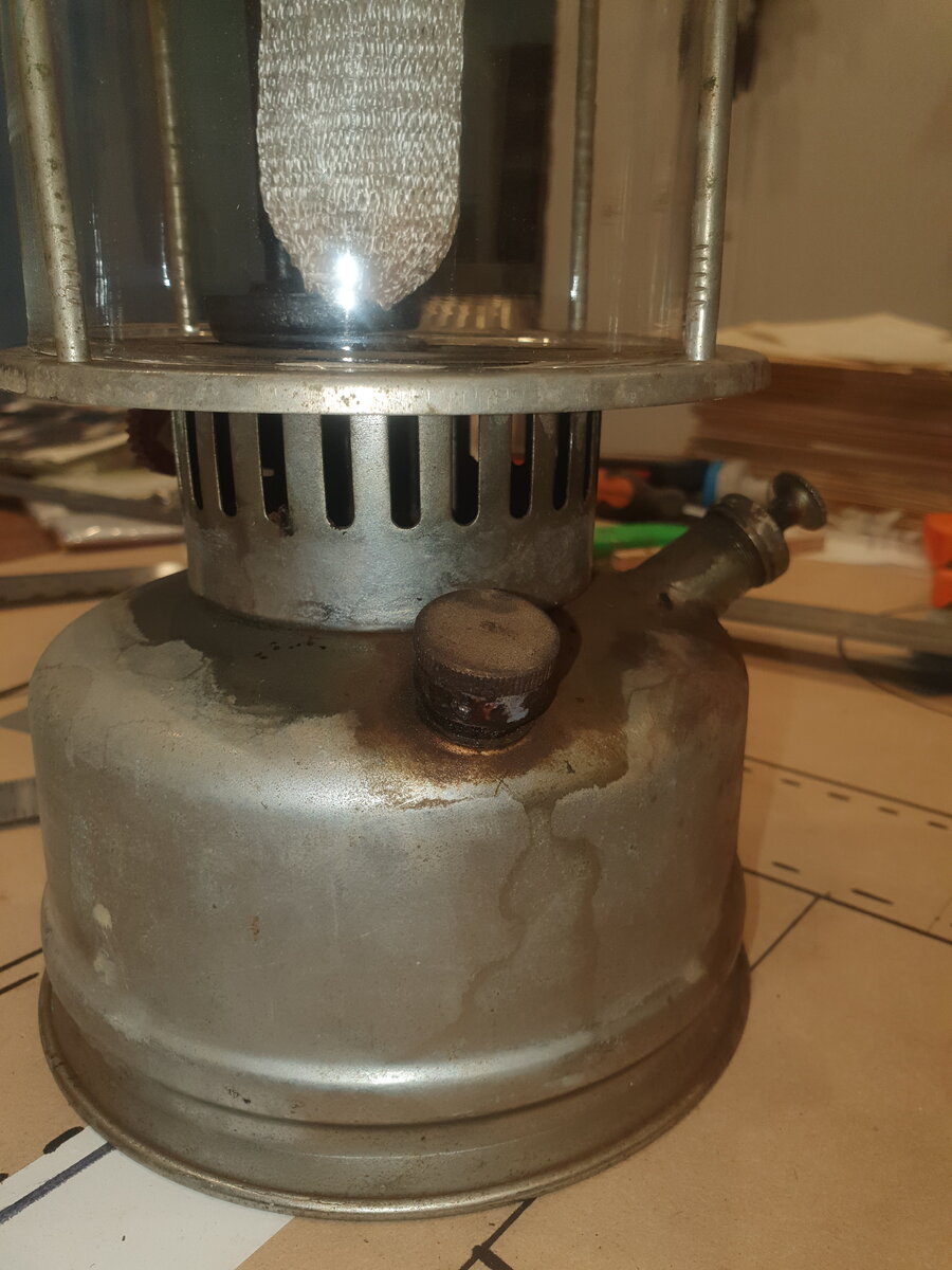

    Picked this up in an auction last weekend along with an X246B. (Sold as 2 x Tilley lanterns...)

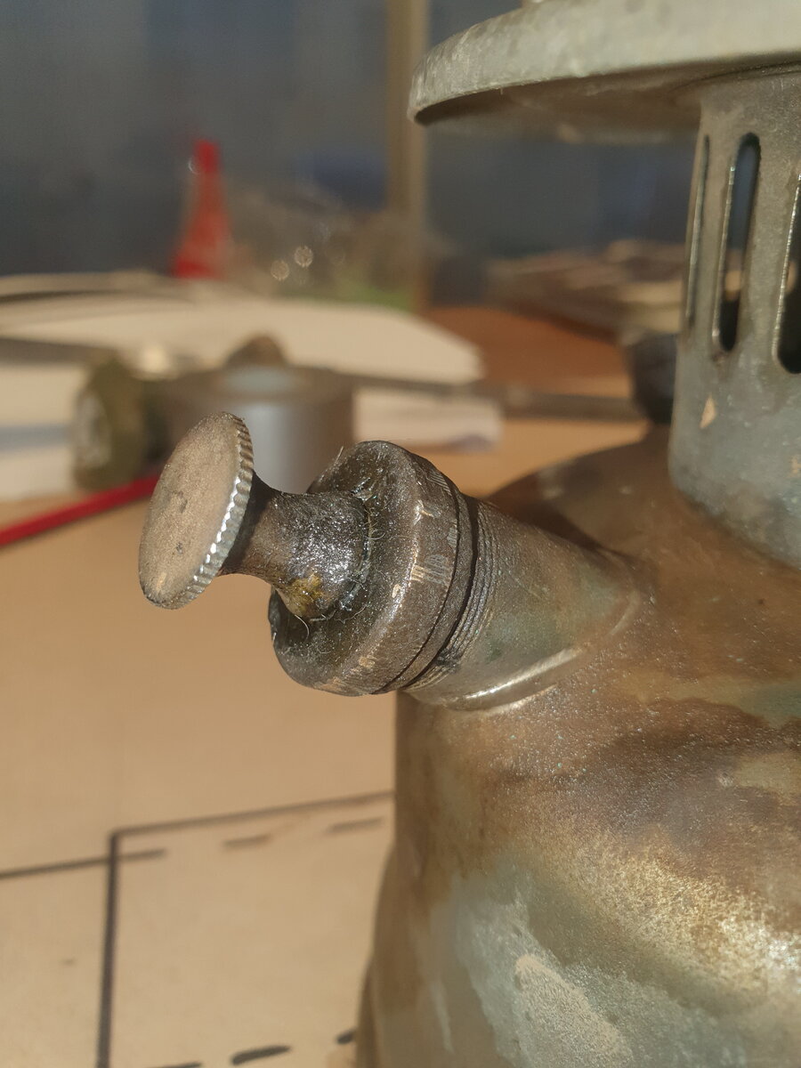

    Seems in reasonable shape except the control cock is all jammed up and have not been able to remove the vapouriser tube yet. Seems all brass construction with a nickel or chrome plating on top.

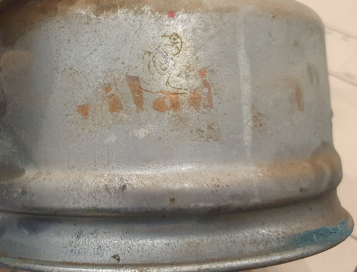

    Cannot find any engraving of a brand / model / date except the remains of the Aladdin decal. (I imagine that will disappear when I clean the tank. )
    Glass (globe) is branded Pyrex witha small crown symbol.
    More than happy to receive any tips and/or advice!

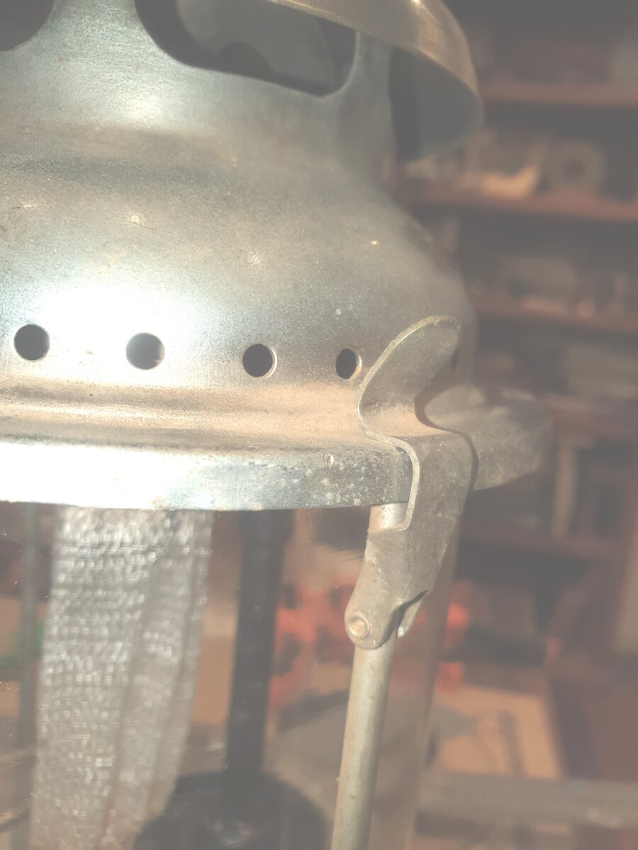

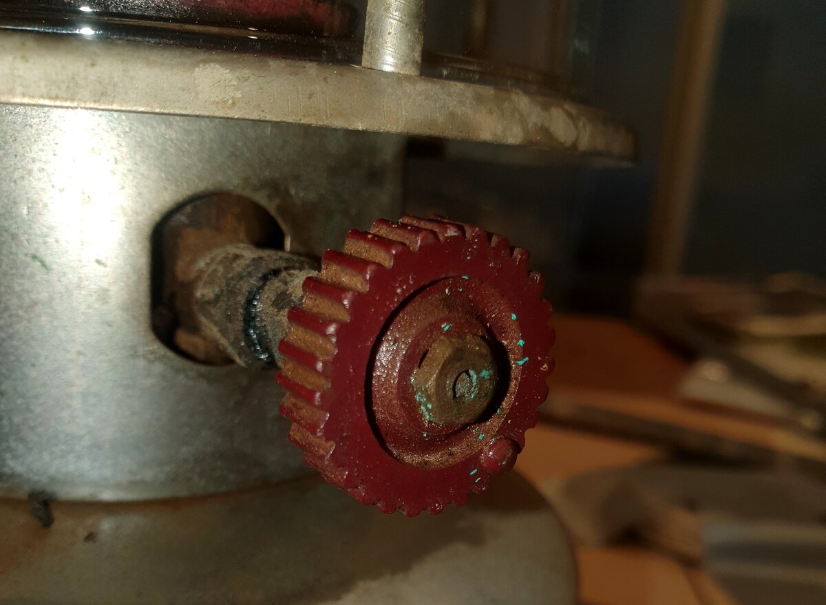

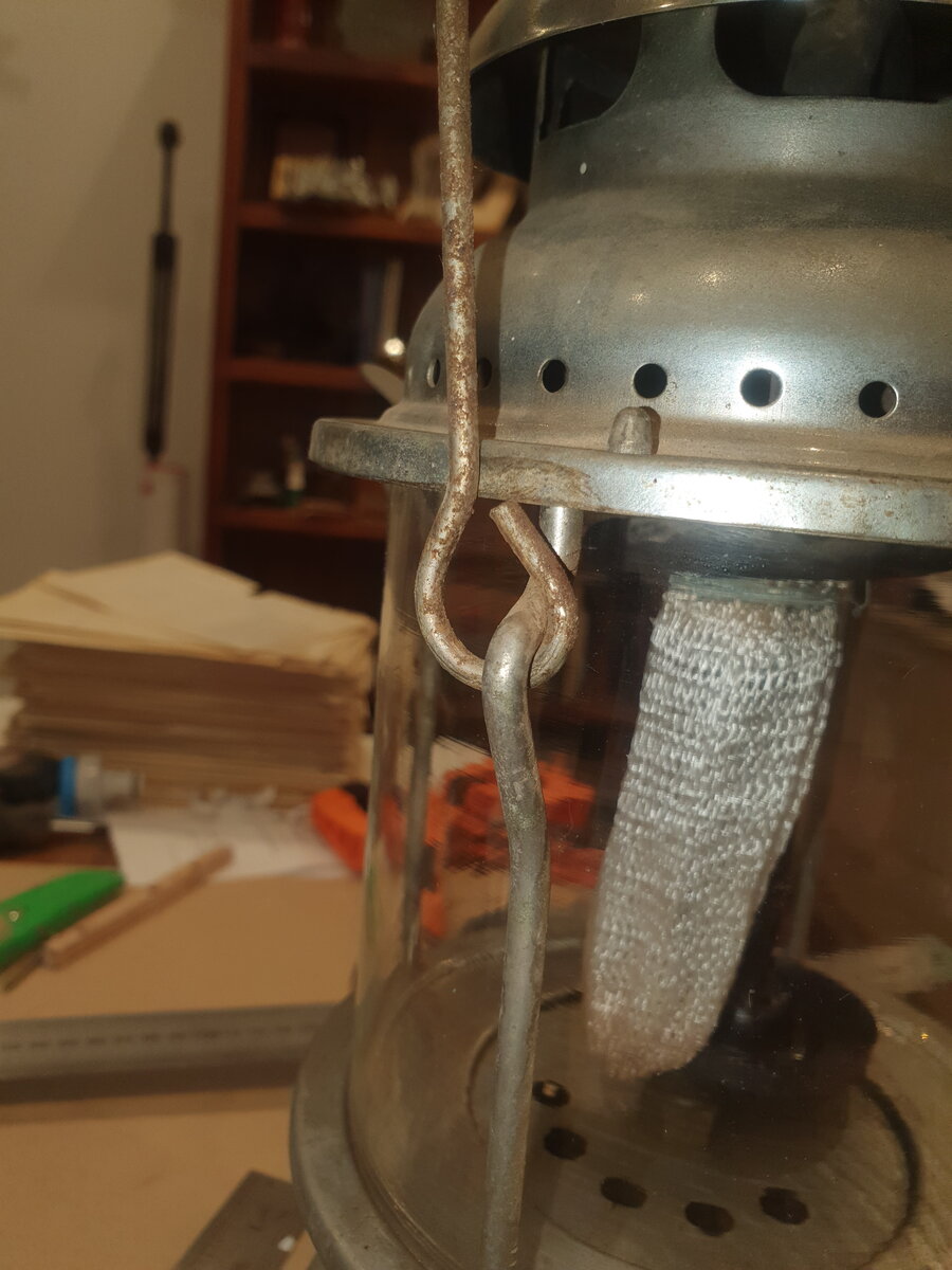

    Al;addin tank fill.jpg Aladdin bail attachment.jpg Aladdin decal remains.jpg Aladdin hood clip 2.jpg Aladdin pump.jpg Aladdin control cock.jpg

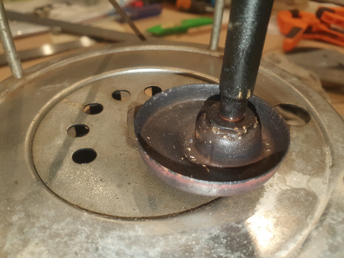

    Couple more pics...

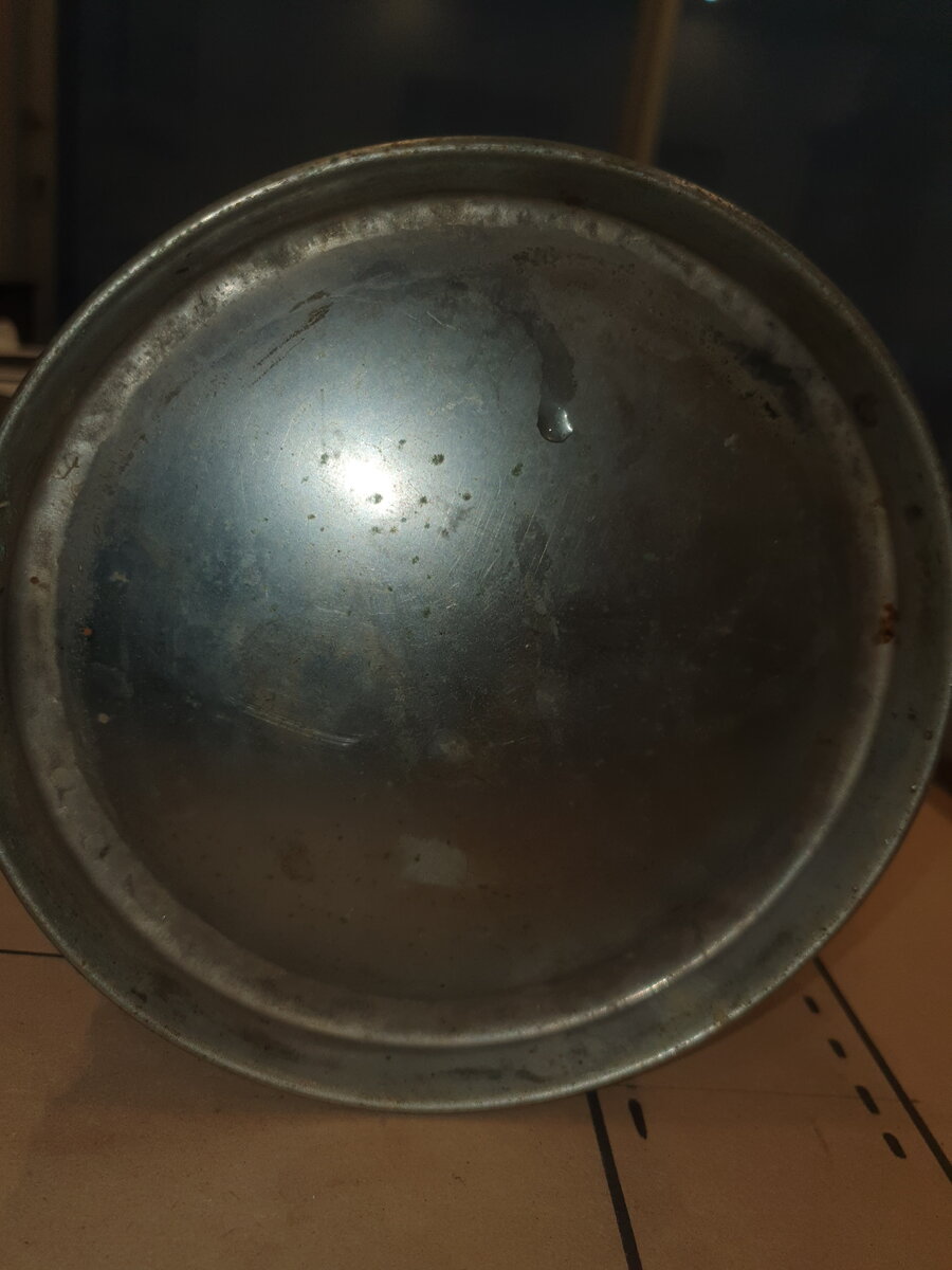

    Hello there @Graham-Melbourne , you have a Aladdin 1A probably 1970's,
    It will clean up well,
    The globe is original, the small crown is the last of the aladdin globes, cost cuts, the stencil on the tankmay stay if you are gentle, wash,
    Vinegar is good to clean everything, but dont let it soak too long, tend to it regularly,
    The vaporisor / preston loop can either be made of steel or brass, they work the same,
    Your control wheel is probably gummed up with burnt kero residue like tar. Do not force it.
    Remove the vent with the burner complete, you can deal with it later.
    Use a spanner to undo the flange nut on the vap, it may take a small amount of force, or if you have the tools heat and quench, repeat it will come undone.
    Be careful when removing vap not to bend or break the pricker wire / jet cleaner.
    The control wheel unscrews from the fuel intake as a single unit, it has a cam on the end that when rotated lift or lowers the pricker.
    The pricker rod with the ecentric can be removed
    If you look in the lantern reference gallery you will find a lot of information and pictures, you can look for some of my posts, @Darryl Durdin .
    You have a very cool lantern.
    One other thing check the bottom ring of your lantern for stress cracks
    Happy fettling

    This looks similar to mine. Try to preserve what's left of the decal. These are nice tidy lantern.

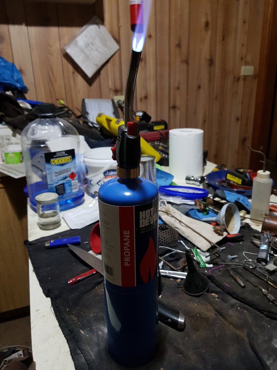

    Any luck removing the vapouriser tube? Mine is stuck tight and I need to replace the cleaning needle!
  9. Graham-Melbourne Australia
    May 27, 2020
    31
    This one came out fairly easy but I had one stuck very firm in my R1 radiator. Someone suggested repeated heat & wrench cycles and that did the trick for me.
  10. Darryl Durdin
    1,618
    I would do the heat and quench, repeat it a few times, make sure your turning it inthe right direction, lefty loosey/ righty tighty
  11. Buckaroo
    Buckaroo Australia Subscriber
    Mar 21, 2020
    447
    Wollongong, Australia
    Looks like I’m going to need a kerosene torch then!
  12. Graham P Australia
    Mar 3, 2012
    982
    Albury area NSW AUstralia
    A soaking with paint thinners around threads (wrap strips of rag to hold it) may be enough to soften dried fuel
    Or a gas mini torch should be enough used carefully to not melt solder on other parts

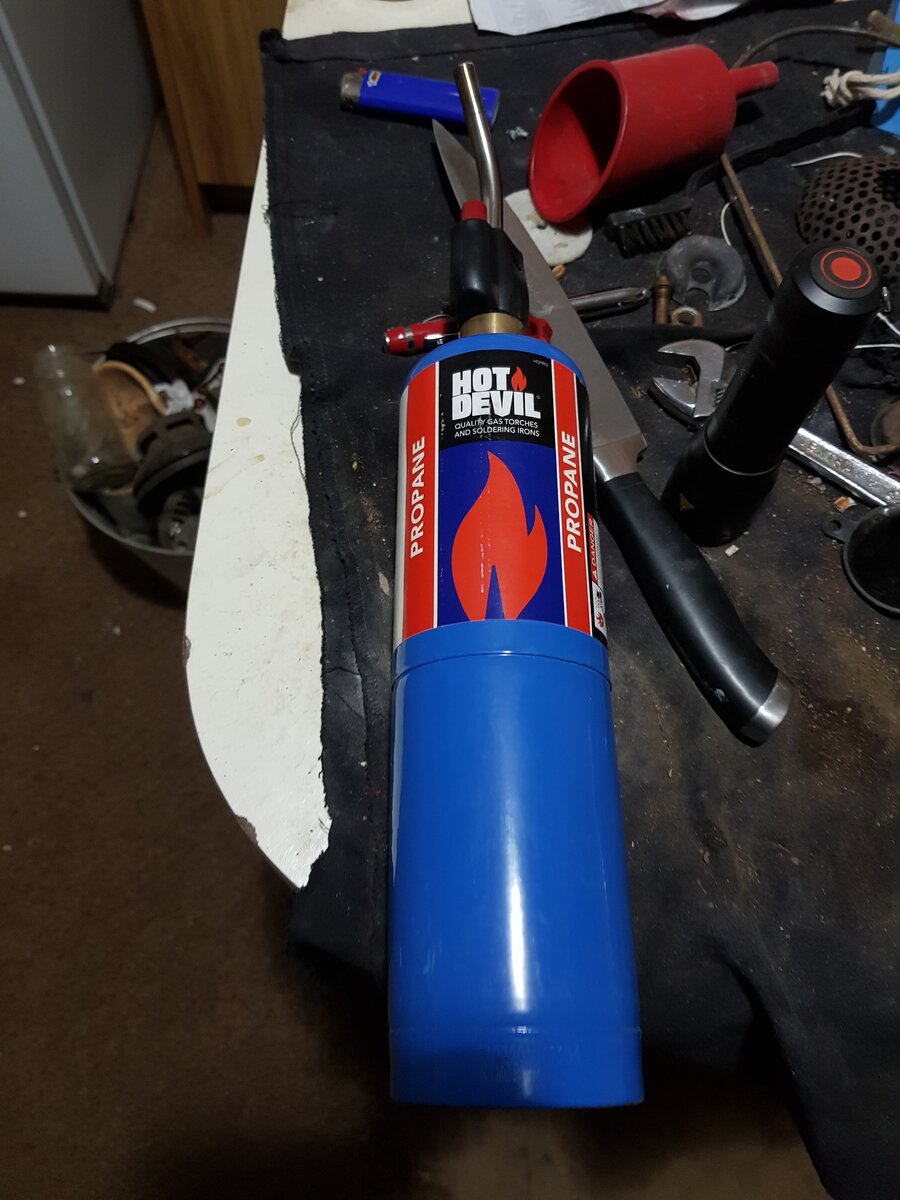

  13. Darryl Durdin
    1,618
    Well worth the investment. Plenty of other uses
