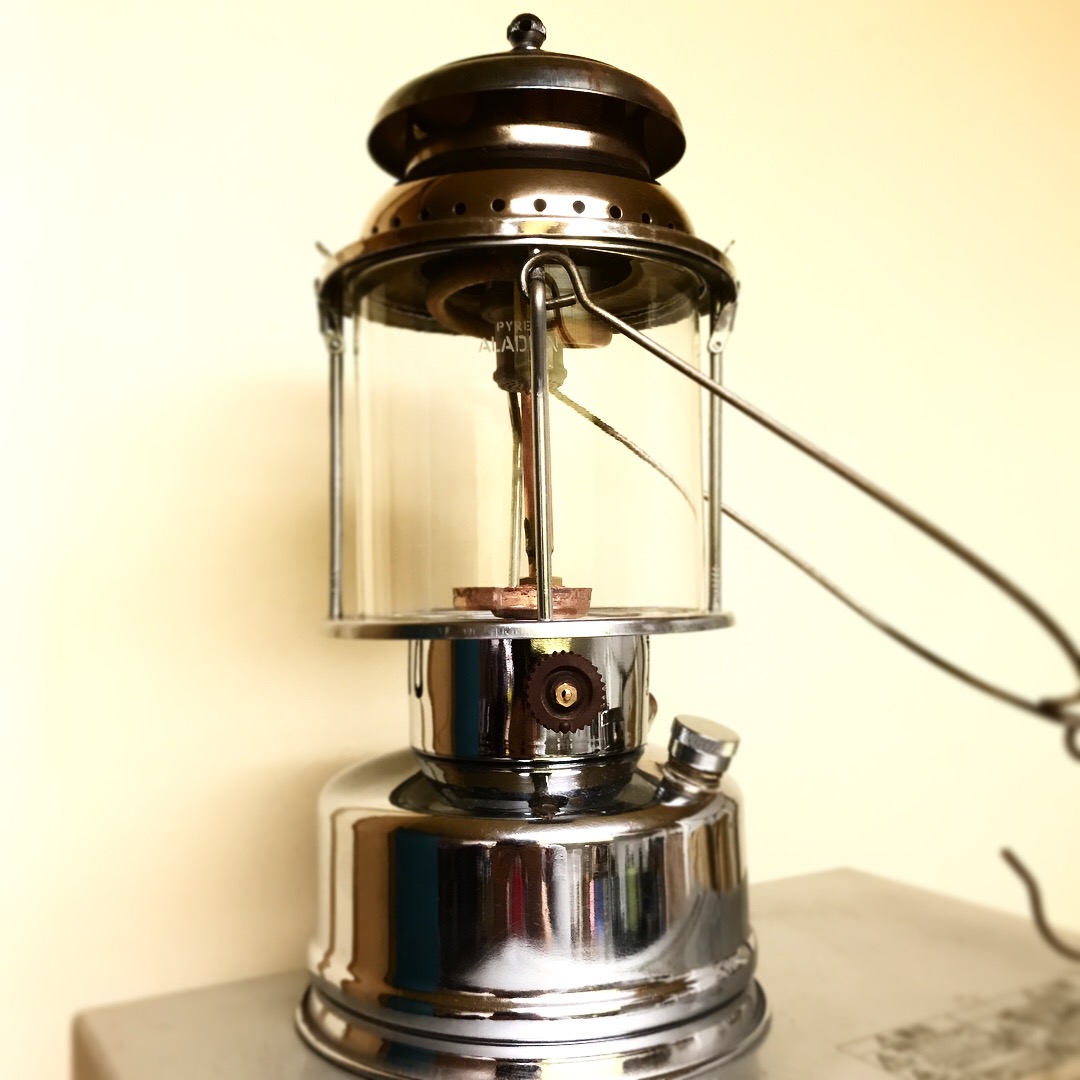

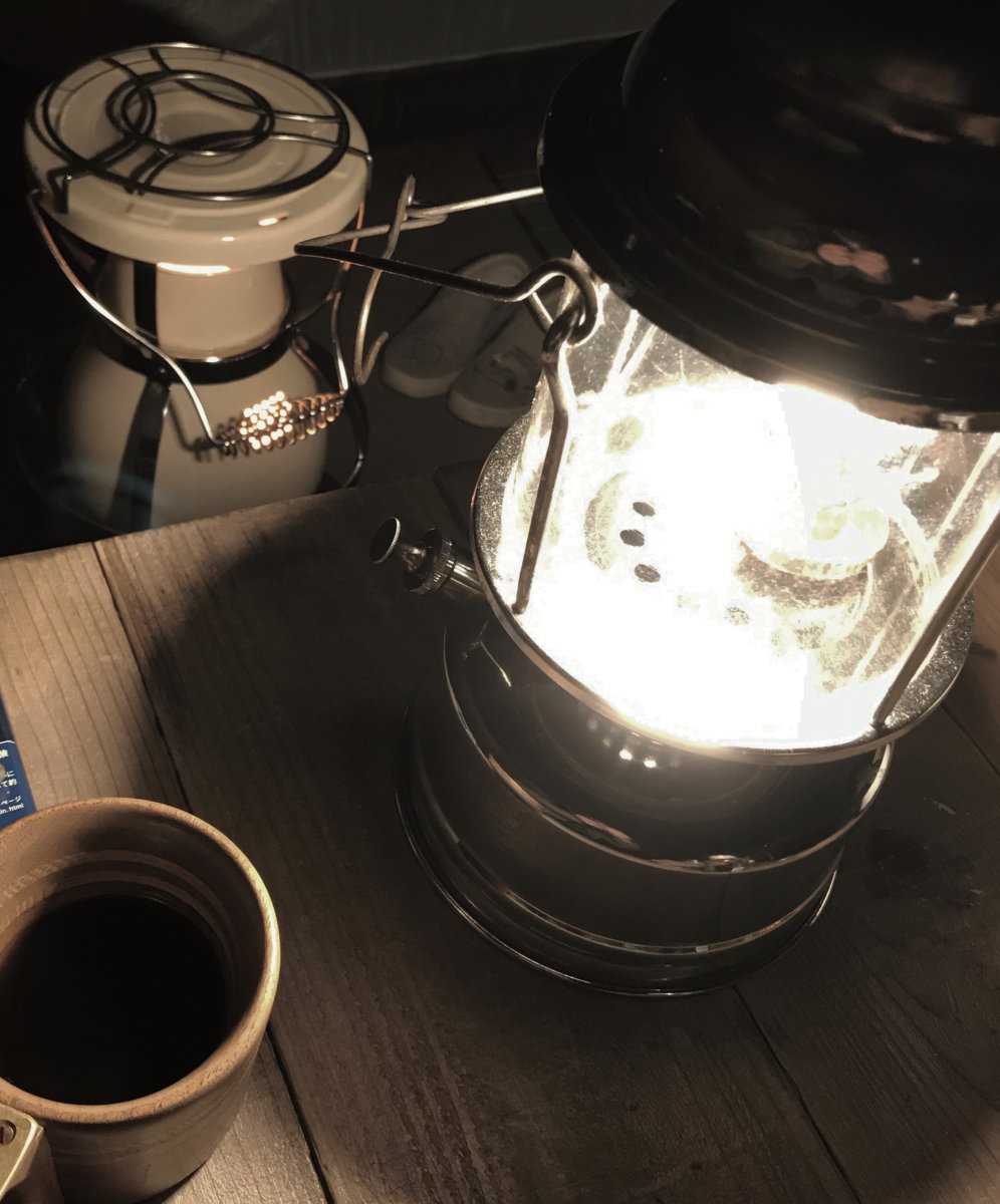

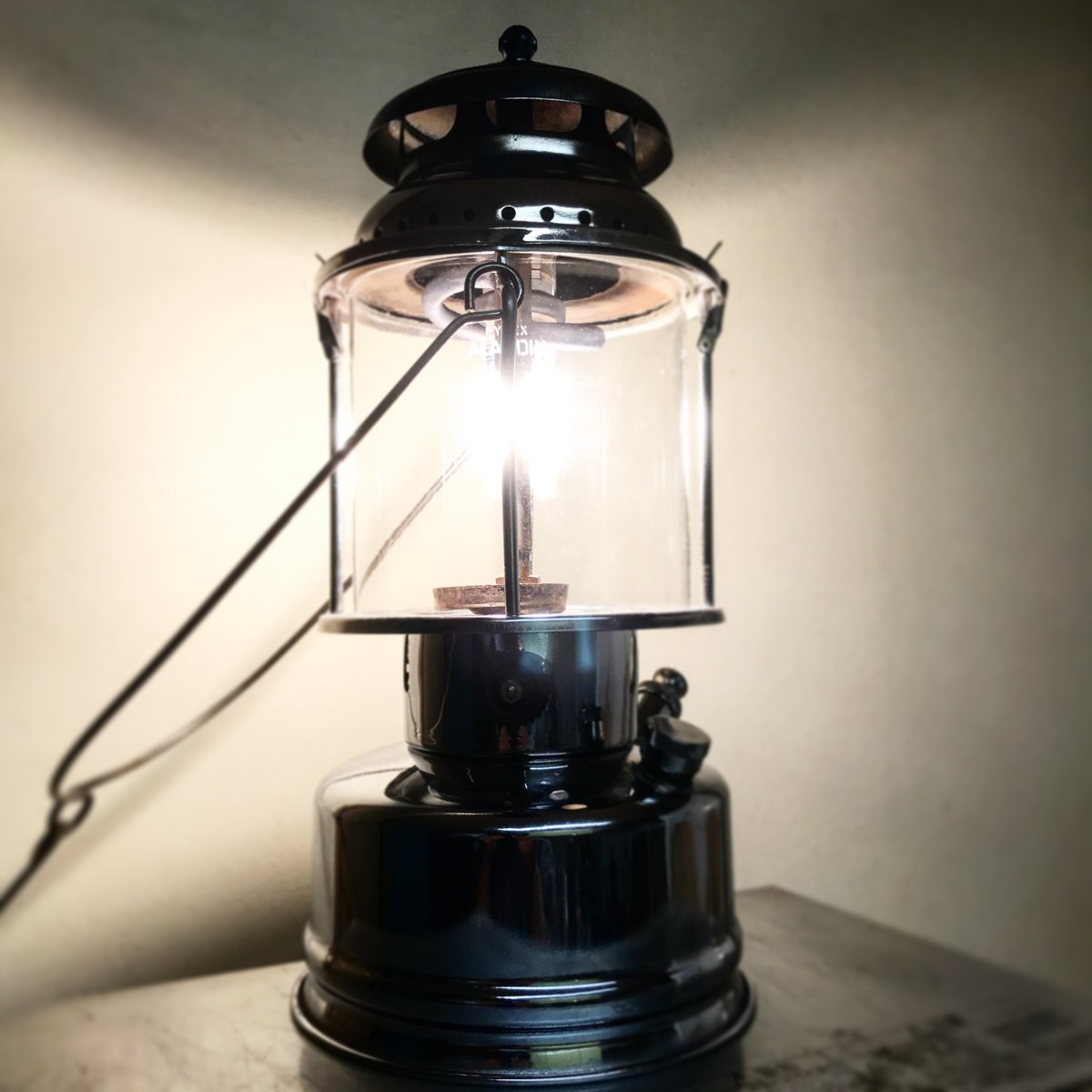

    Hi All,
    This is my first Aussie lantern.
    I recently completed repairing Aladdin 1A.
    This lantern is very nice!

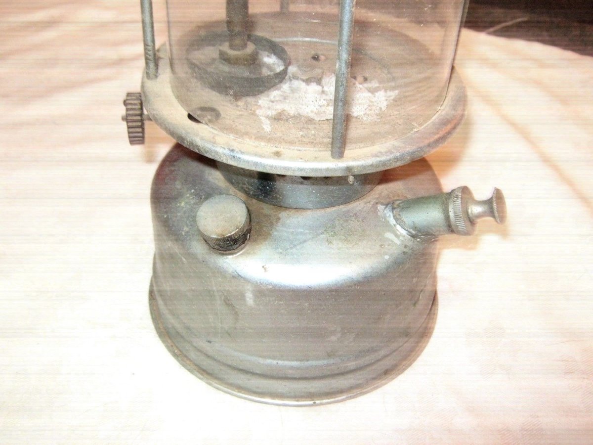

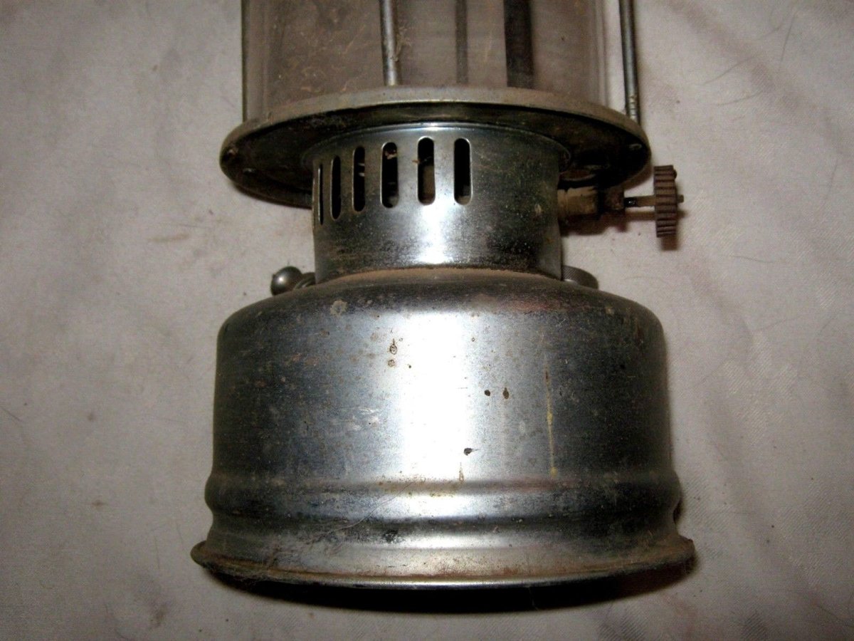

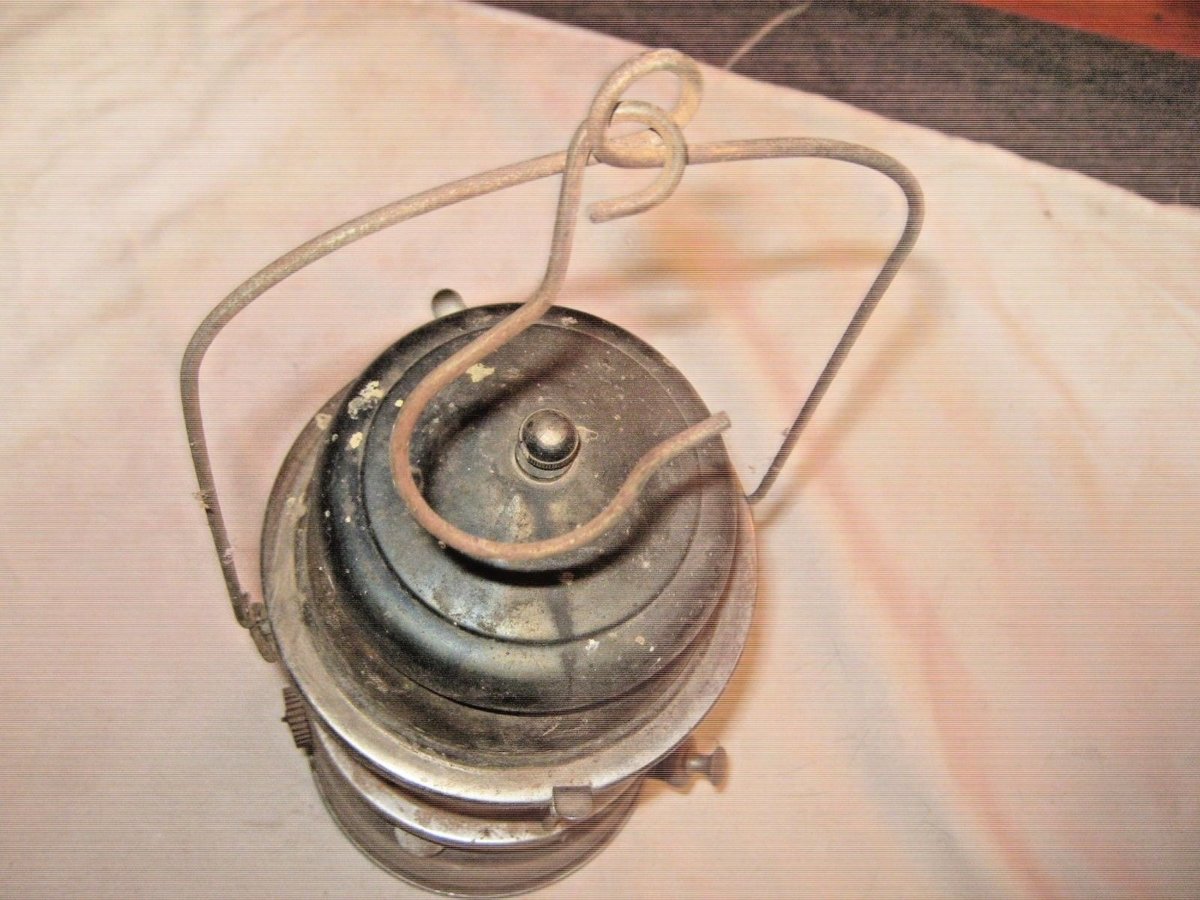

    The state when this lantern arrived at my hand is as shown in the picture below.
    Regards,
    YOSH
