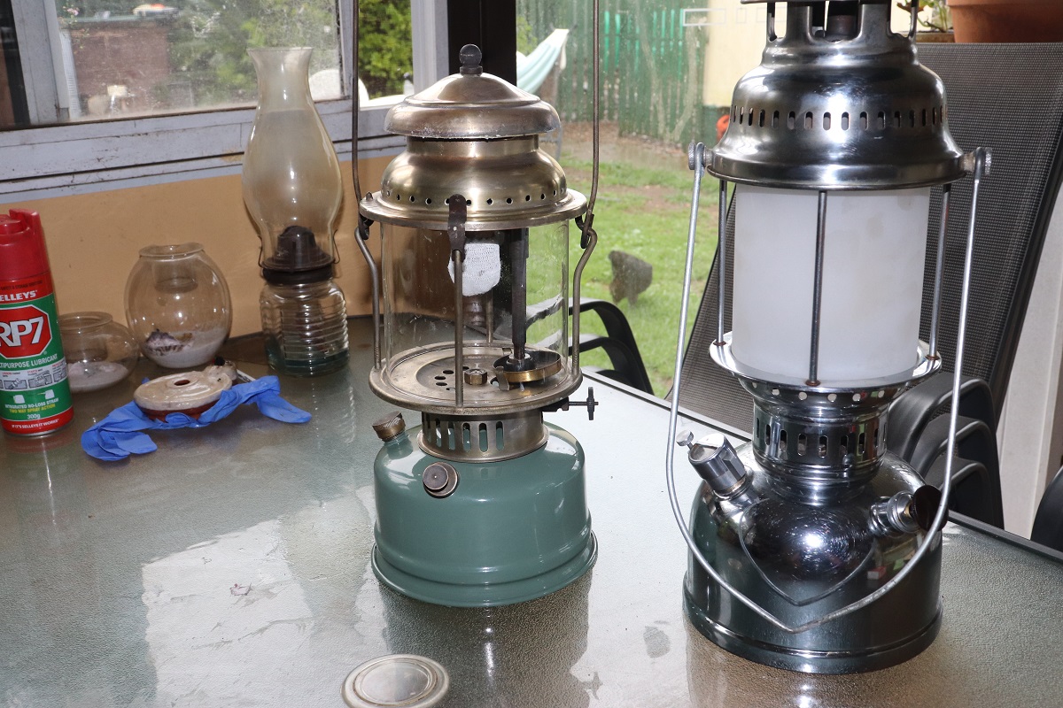

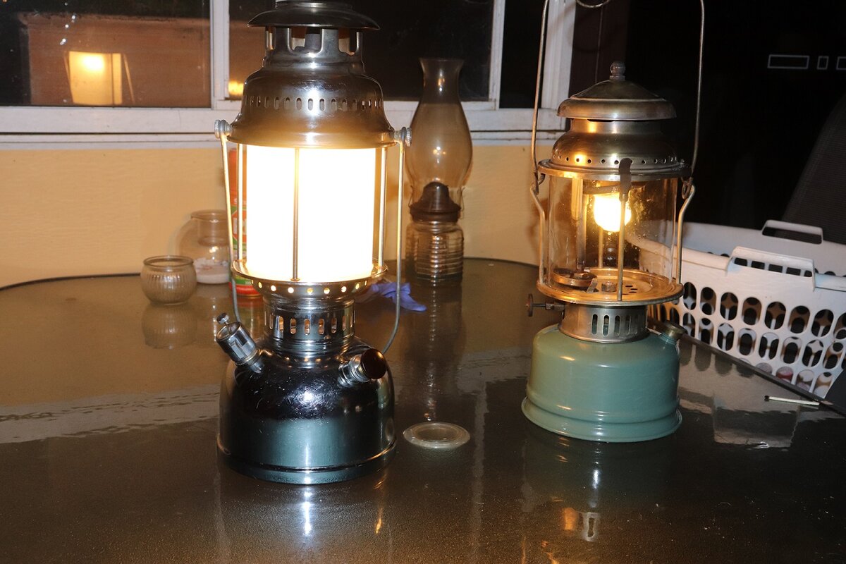

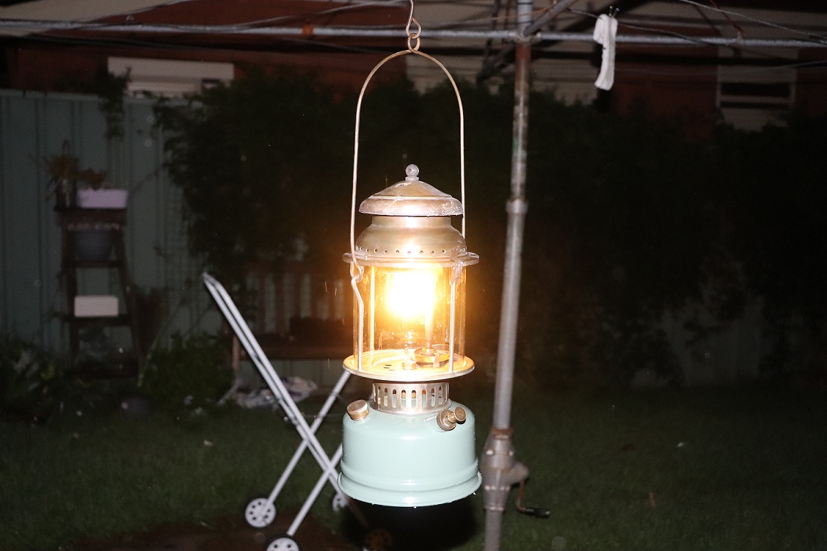

    Hi everyone!. I have been working on a Aladdin A1 which was a lot of hassles to get going. It started out with a reline of the font with fuel tank paint as there were heaps of stress cracks. I then had to clean out the generator which was blocked solid, then replace the jet which I damaged (Thanks Frank) and later the pricker (Thanks Vic). I also replaced all the seals. I painted the font in epoxy paint which is close to the original colour. I managed to damage the pricker rod putting it all back together so the pricker does not clear the jet so performance is down a little but I will sort that out. I also sorted out a anchor no 999 350cp which I scored for $20. It needed a glass which I scabbed off a gas lantern , replaced the plunger and the valve pip and gave the font a clean out with acetone and a few nuts and bolts shaken inside to get the crud out. The anchor looks like the older type that were of better quality so I'm happy. It puts out heaps of light too and wasn't hard to get going. Here's a couple of pictures Thanks every one! IMG_1006.JPG IMG_0997.JPG IMG_1004.JPG

    Well fettled!:thumbup::clap::clap::thumbup:
  3. ROBBO55
    4,408
    Excellent result, they have cleaned up nicely. Congratulations :thumbup::thumbup:
    11,092
    Nice work.

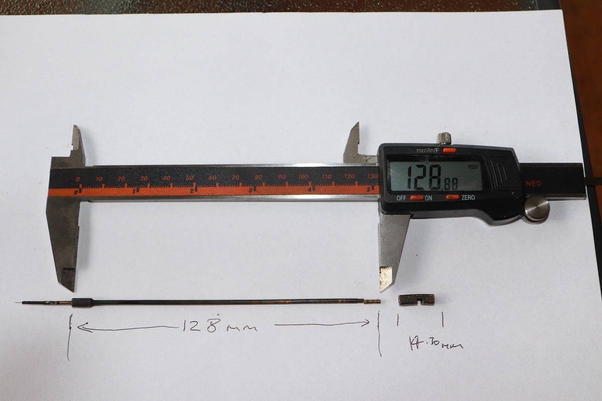

    Hi Tony , I mucked around with it tonight and will need a new rod as too much broke off so here's the measurements. How much do you want with postage to NSW 2147. Thanks Dave IMG_1013.JPG ave
  7. Tony Press
    11,092
    Ok… no cost
