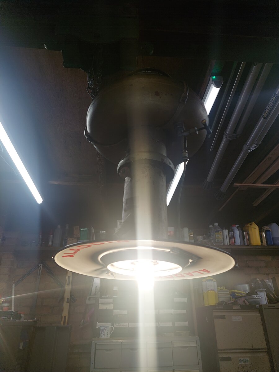

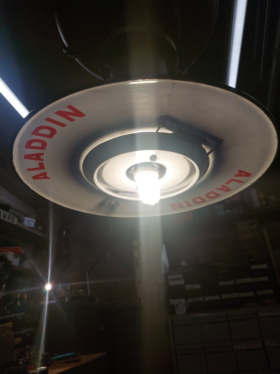

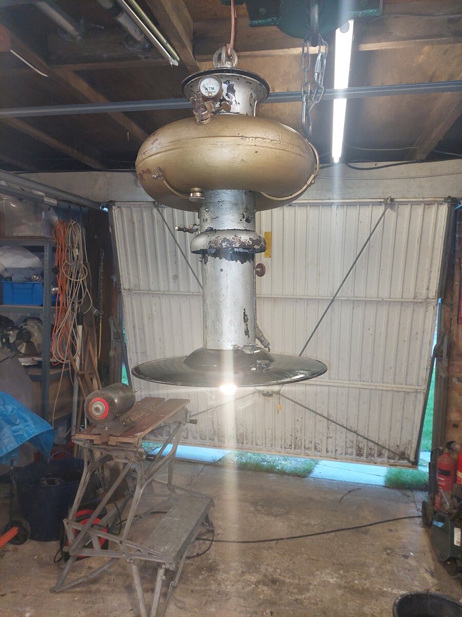

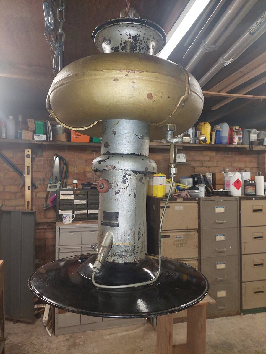

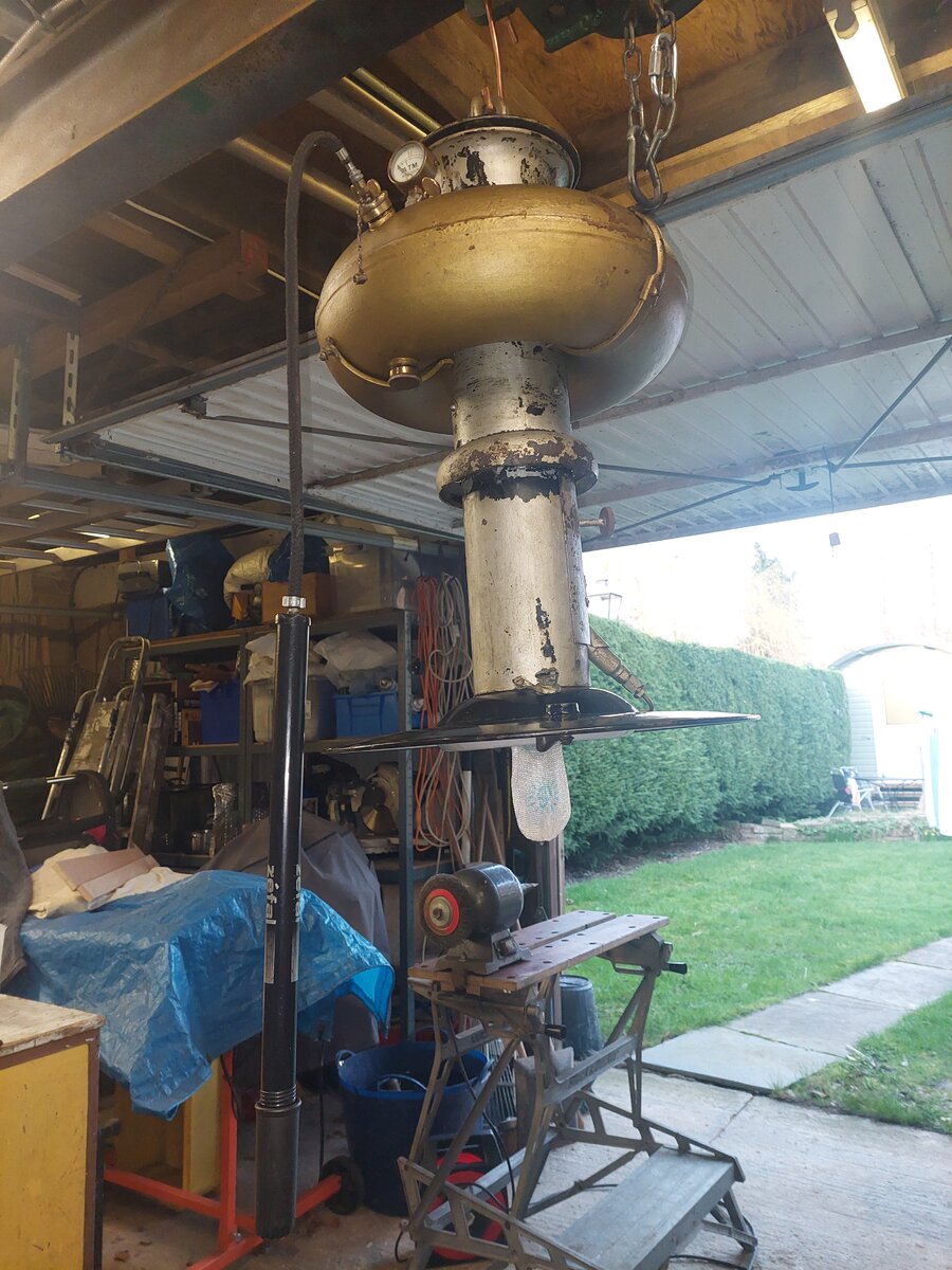

    This is a lamp i have known of for maybe 20years
    I remember mick walking down the runway with it on a bitterly cold day at swinderby antique fair after buying it off a european dealer. From there it went to micks home in harrogate then onto bolton abbey railway station for a good few years.
    After the covid years it returned to micks who sold it to dave in oxfordshire so its a well travelled lamp.
    Anyway it came to Leeds last xmas with a request see if you can get this monster going.
    Well this weekend it finally works again i reckon this lamp just needed a bit of tlc after all its been tho and all its travels.
    Its a big lamp must be doing 500cp at least put biggest mantle i had on it and it filled it with flame. Had to prick it a bit at first then run faultlessly for 4 hours
    Life in the old girl yet

    It's working well!:thumbup::thumbup:

    Thanks jeff yes its a bright lamp is this
