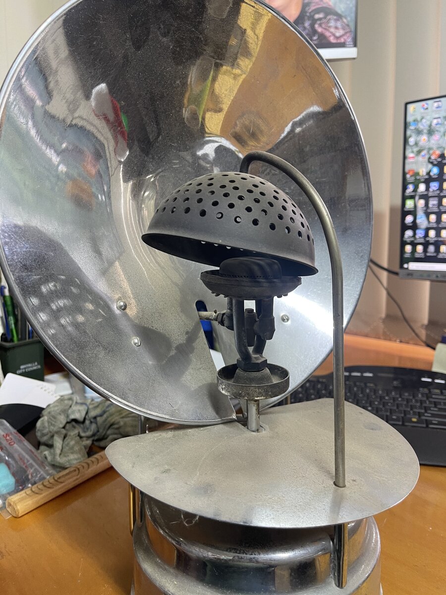

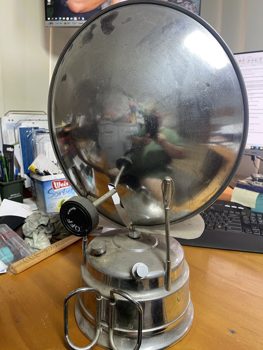

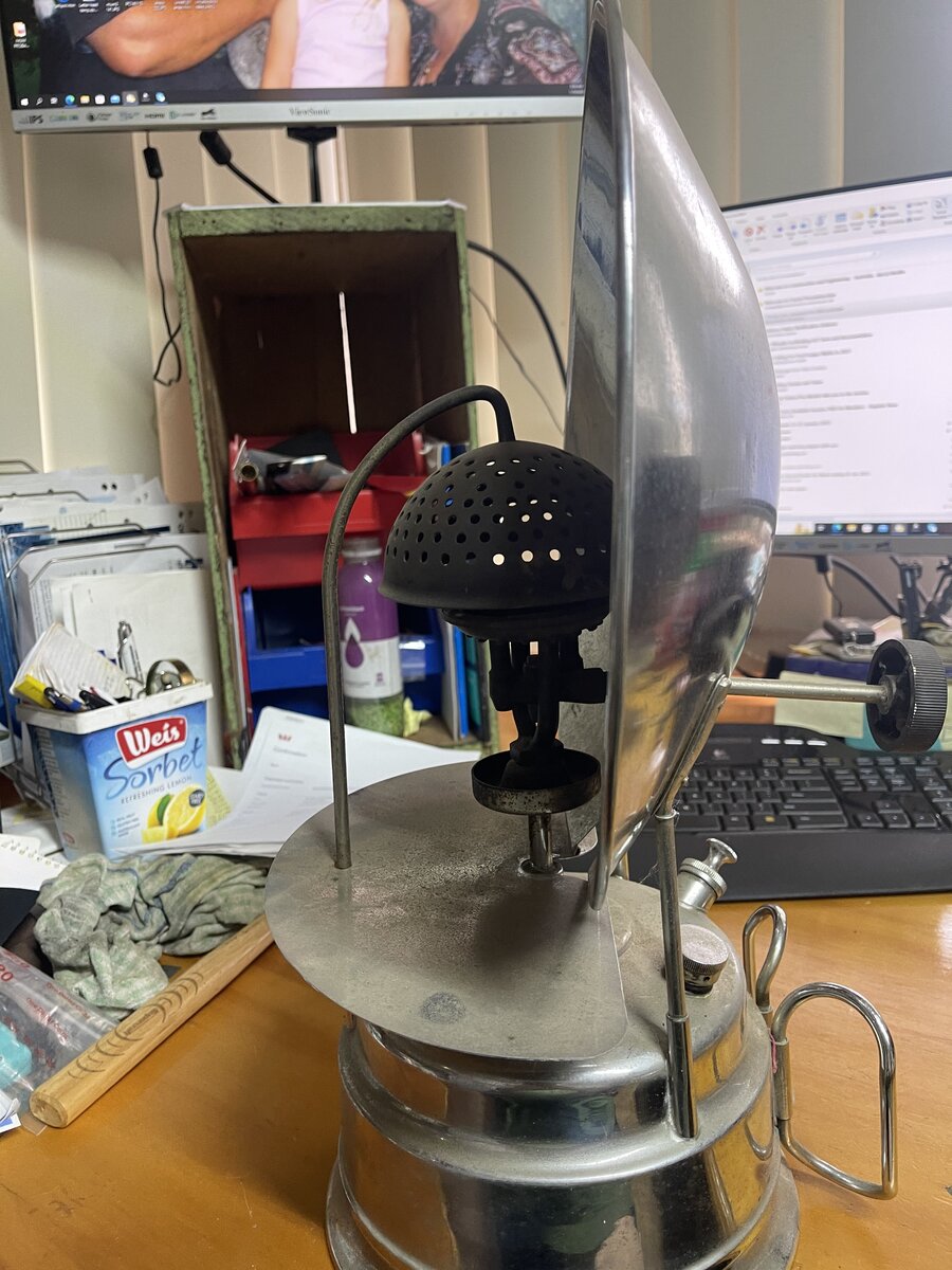

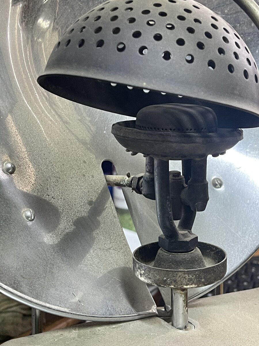

    Hi fellas, I need so information on this heater, I found a radius No31 in the gallery but it’s not like this. Tank is different. Any information please much appreciated 5E1413FC-89B2-46E7-966B-442222152A74.jpeg 5E859E4D-1ACA-4A8D-8069-E696DFFCB2CC.jpeg 2077D658-3137-4A3D-9DFD-F34F6F5A8FDA.jpeg 414AB4F4-1A7E-422F-86D5-59A380419CDF.jpeg 46371451-07E1-44B4-B224-688032FF22C8.jpeg

    Darryl, that's the Australian made Aladdin Heater Cooker. They were advertised as a heater with a stove trivet and pot supports for conversion to a stove.
    From what I have found on Trove, the Crome Australian version was advertised from 1949 to 1954
    The earlier 1930's version was an unbranded Radius 33. Nickel plated. Sold under the Aladdin brand.

    Darryl i have had a few of these over the years and they have a three fold use, a lantern as well, if you notice on top of the tank the raised ring for a lantern frame rest collar application, i screwed an aladdin fuel valve in plus vaporizer, fitted a collar and glass frame and it worked perfect as a lantern, they are a great unit
