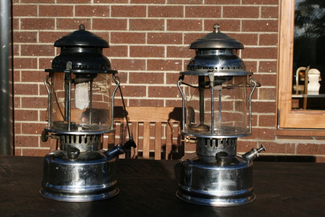

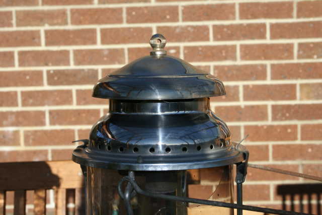

    I just finished fettling these two Aladdins. They are a bit different from each other and I don't know the period of manufacture for either so any help with that would be gratefully received.
    I had trouble loading images earlier (I had 15 loaded and the server timed out - I put it down to being at the end of a long length of barbed wire - so I will post the details of the fettle in another post.
  2. Nils Stephenson
    3,409
    As far as I know there is not much information on when the different variations were around. I can say that the nickel plated one on the right is the version which came after the green painted tank. My best guess would be 50's. The black enamell hood, plastic pump knob and no hook on the handle came later. How much later I don't know. I believe this variation also came with a transfer on the tank, but they are usually gone ages ago. This variation also came with a black painted tank with tansfer.
    Thanks, Nils.
    The lamp with the nickel plated hood that has the remnants of a red 'Aladdin' transfer on the tank. The one with the black hood does not - but it may have been, of course, polished off by a previous owner.
  4. Nils Stephenson
    3,409
    Maybe the Alladin transfer started at the same time as the all nickel lamp. Not something I've seen before, but the transfers are delicate and wash off easily. I don't have a complete transfer on any of that type.
    Now that I think about it, the black enamell hood type continued on with the next style of label which was a foil sticker with the Aladdin name. Either transfer or sticker could have fallen off over time.

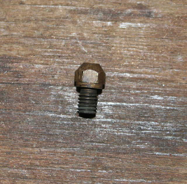

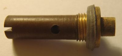

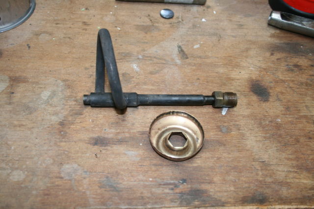

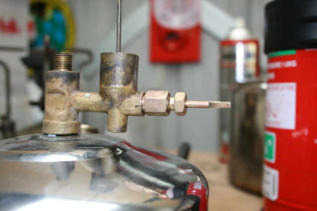

    Now for the photos of the fettling of the lamp on the right.
    It was very dirty and covered in a thin layer of dirt and mud, so the first job was to give it a soak in 1/3 vinegar and water.
    All the burner, cleaner and vaporiser parts were cleaned with Marine Clean and carburettor cleaner.
    The cleaning needle and shaft:
    The tank was cleaned with Marine Clean then rinsed with acetone and finally flushed with kerosene.
    New seals were made from viton.

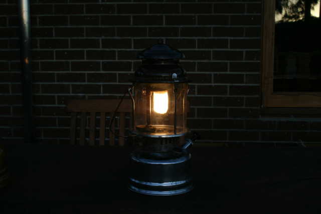

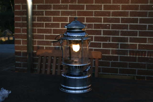

    And here is the black cap Aladdin. I just had to rinse the tank out, replace the filler cap seal, put a mantle on and away it went. I've been using it most nights to go down and lock the chooks up - a great lamp.

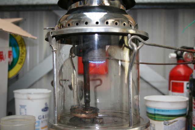

    Noticing your meth`s cup, all these that I have the wider side is toward the centre which will give more heat to the Prestons loop. :-k
  10. Tony Press
    You might be right... I did not take a note of the position of the meths cup in the nickel Aladdin before I stripped it down, so I looked at the black capped one and matched it. They could both be in the 'wrong' position...
  11. Nils Stephenson
    3,409
    The meths cup should be positioned with the widest part towards the middle. You want to keep as much direct flame away from the glass as possible. It could crack.
  12. Tony Press
    Thanks for that, Nils. One of my globes was cracked before I bought it, so I'm on the hunt for a new one.

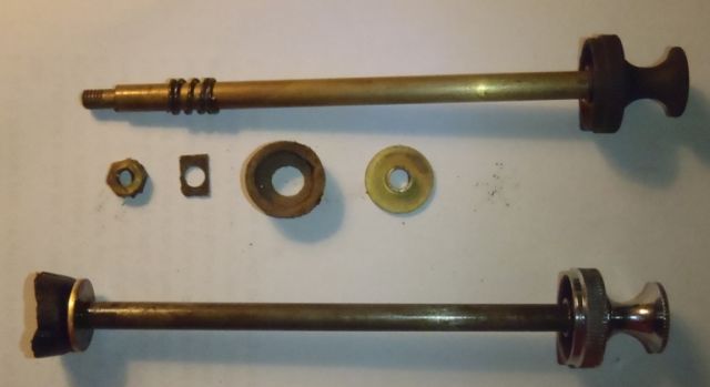

  25. ROBBO55
    4,437
    G'day Colin,
    Here is a picture of two pumps from Aladdin Lanterns. I have laid one out for you to see the components. The plated one is from a model like yours and the other is from an earlier model but the pumps are the same. As you can see the spring is missing from one but it operates satisfactory. I don't use loctite.
    Search this site or sister site CCS for details on removing the NRV and available tools.
    Here is my home made NRV remover. The slot is 5mm Wide x 5mm deep and the diameter is clearance on ID of pump tube.
    Parts are available online, ebay or The Fettle Box(see top LHS home page).
    Fettling a Lantern is not difficult but is very therapeutic.
    Good luck.
    Martin
