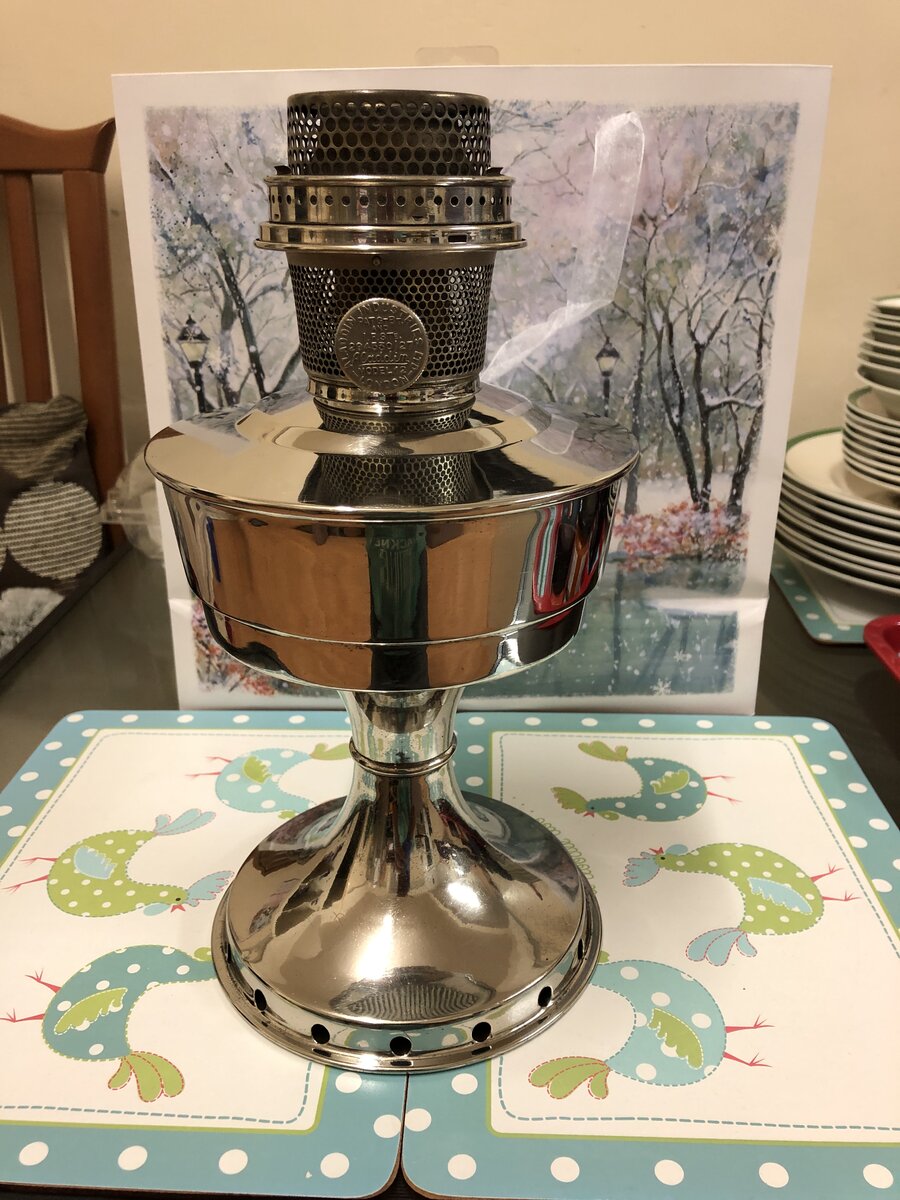

    Hi, I know a lot of you have Aladdins and other non pressure items so I thought I would ask a question. Is it still possible to find original period correct shades (glass or paper) for a UK made Aladdin 12?

    Hi Stuart,

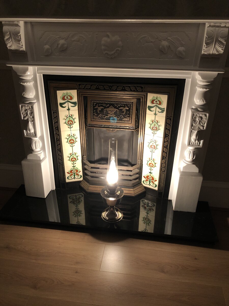

    That looks to be working well
    There are lots of glass shades on ebay .. you will need a tripod type holder but they are about too
    The fabric ones do come up as well
    if you want the exact one for the model you have then I’m sure other members will help out with sizes, I’m afraid mine are not to hand
    hope you get sorted
    regards
    pb

    @podbros @Anthony Thanks for the replies. Ideally I’d like a shade the same age as the base to maintain originality (if that’s the right word in this case) as much as possible. But as with many of our lamps and heaters it’s not totally original as I had to replace the chimney and fit a new mantle.

    The font is one of the last used with the model 12, so it should be from the start of the 1930s. IIRC, the 12 finished in the UK around 1933. I would expect that it would originally have been offered with a glass shade. If possible, find some advertising from that era.
