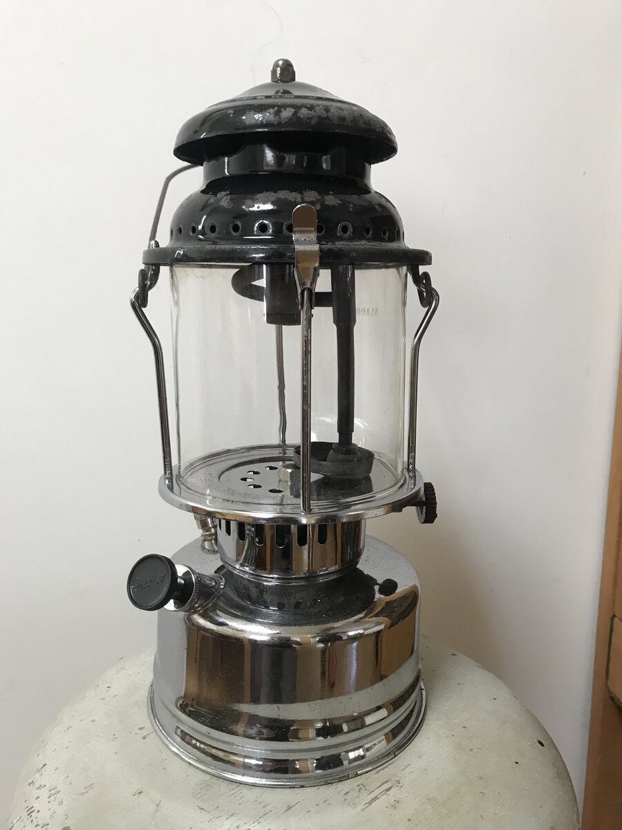

    Hi,
    I have just bought an Aladdin (model after 1A?) and discovered the NRV loose rattling in the tank. I believe it is normally part of the pump? Is it possible to repair? Otherwise it’s in good condition. Any help is appreciated.

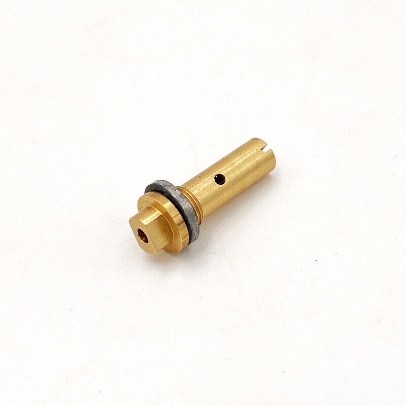

    Jock, this is the type of NRV that screws into the very bottom of the pump tube

    Hi outback boy. Thanks for the photo.That looks very much like what's floating’ in the tank. But I can’t see any thread at the pump tube end. I think Nils is correct by suggesting the whole end has fallen of incl. the NRV.

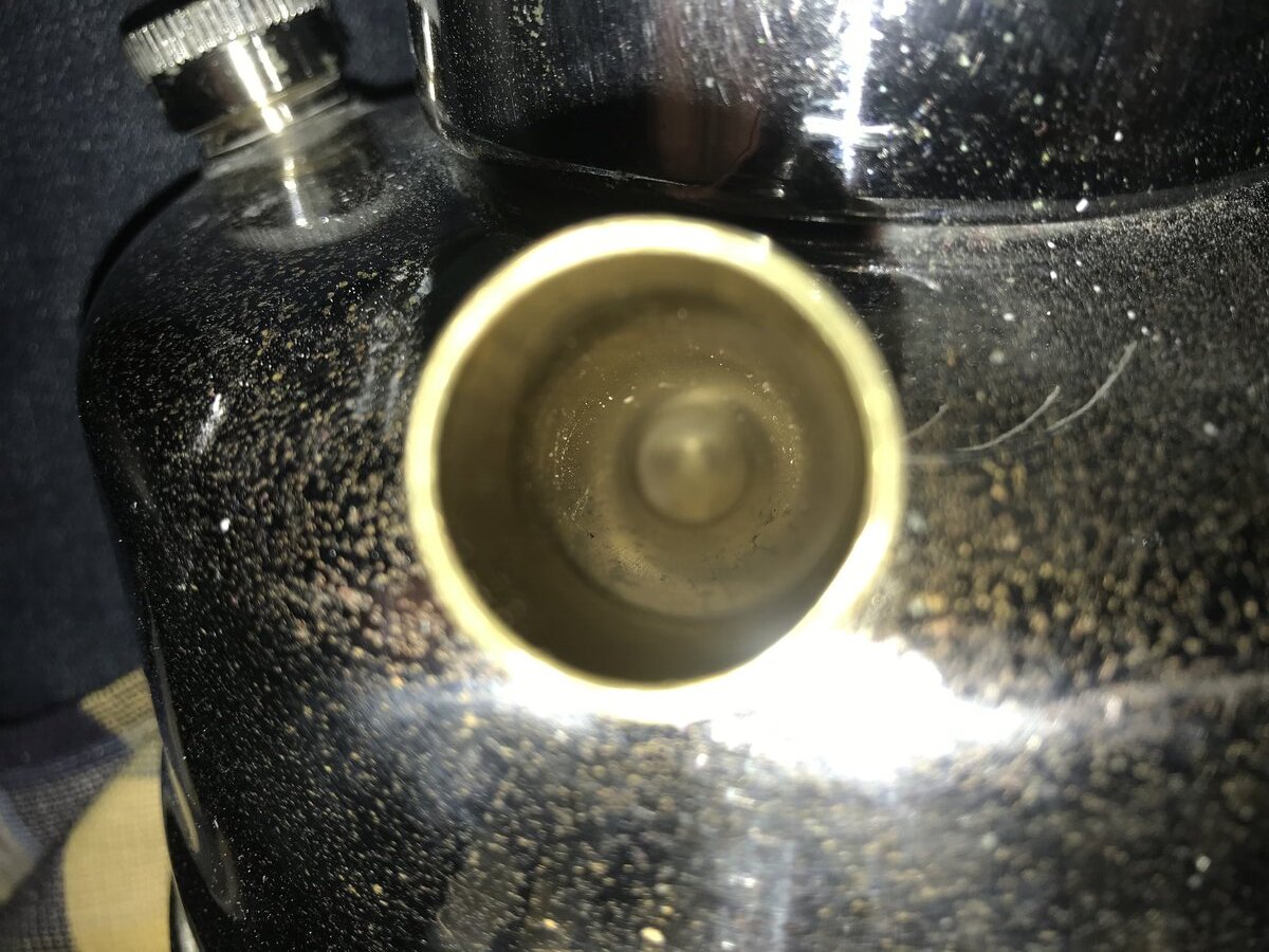

  10. Tony Press
    11,105
    Mmm… a photo down the pump tube?

  15. Tony Press
    11,105
    @Jock
    That photo does not show, to me, that the bottom has fallen off the pump tube.
    It appears to show a central hole on a plate at the bottom of the pump tube. Am I right?
    Edit: Alternatively, is there something lodged in the pump tube?

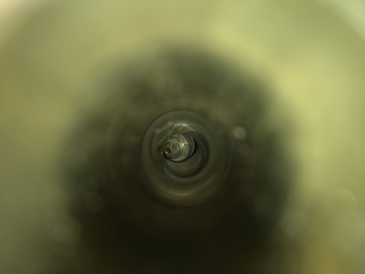

  16. Jock Australia
    Jan 29, 2023
    8
    Tasmania
    Hi Toni, I’ve taken another photo, hopefully a bit clearer. It shows the top of the NRV lying on the bottom of the tank.
    No obstruction in the tube.
  17. JonD
    JonD Subscriber
    Apr 15, 2014
    1,012
    Hertfordshire, England
    I think that might be a pump leather seen down the tube. It does look like the bottom has fallen off with NRV still in it.
  18. Tony Press
    11,105
    Yes… bottom of pump tube has fallen off. Damn!
  19. JonD
    JonD Subscriber
    Apr 15, 2014
    1,012
    Well there is a bright side. Assuming that the NRV and bottom plate won't pass through the filler neck the only way to get it out is to de-solder the pump tube.
    It should pass out through that hole no problem then the whole lot can be reunited before putting it back in the tank again.
