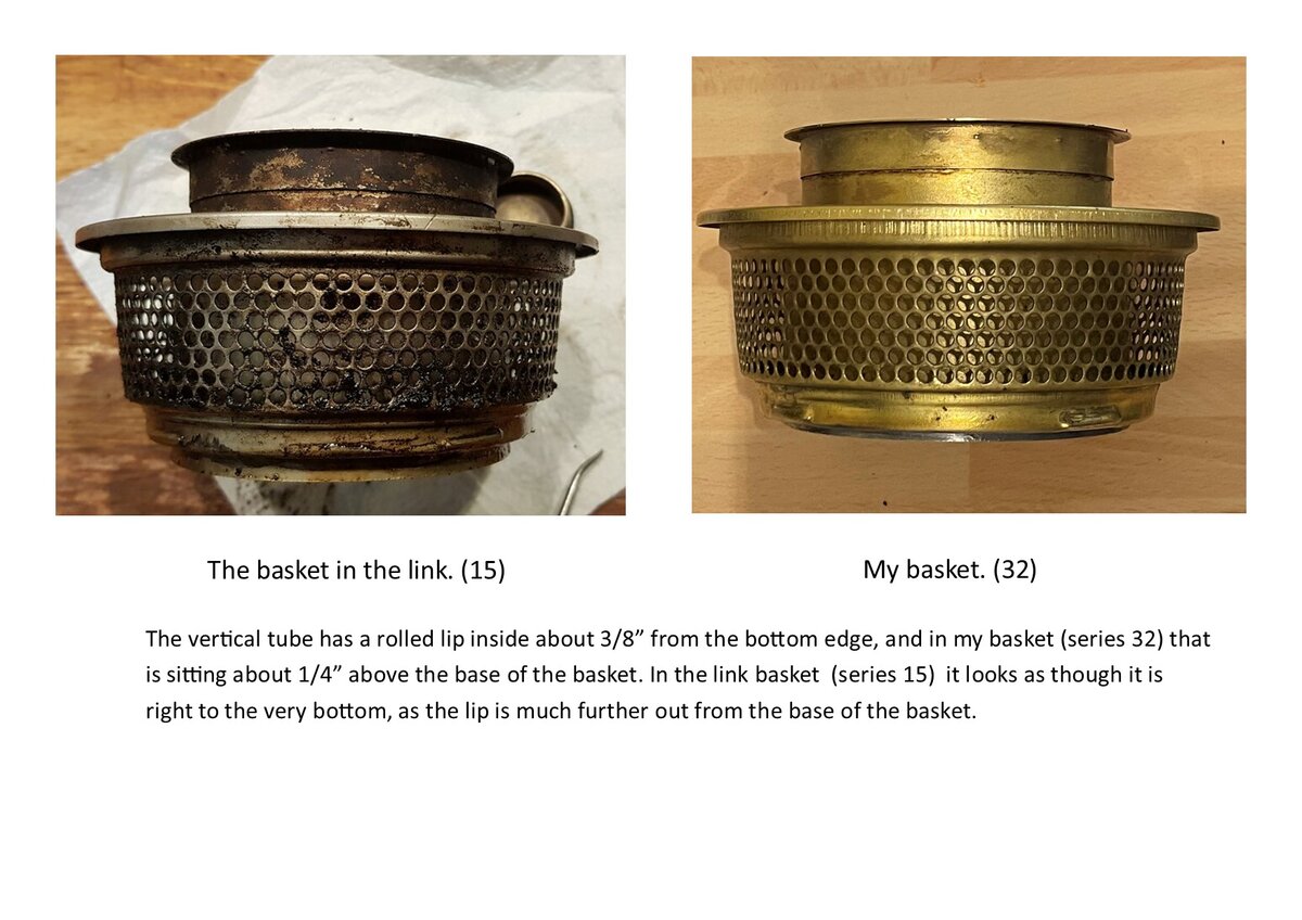

    Hi, Still getting issues with what appears to be fuel starvation after a few minutes, however, my basket seems to be a bit high. This post Aladdin heater - is this the right place? shows the basket having about 3/16" lip below the thread. Mine is much shorter and the inner tube seems to be set higher than the rolled ring inside it. The two are shown in compare baskets.jpg
    I wonder if it is worth warming it up with a blowlamp, and trying to push the internal tube down to the lip where I think it should be. Hattersley says that the basket is the same for 15,16,27,32 & 37 so presumably they should all look the same.
    I have a Valor heater and that looks as though the basket top is quite a way below the flame spreader, as is the case with Aladdin mantle lamps, which are a bit like a small heater with a mantle on top.
    Does anyone have a picture of a later model basket thay can post please, ideally with dimensions?
    I am reluctant to fit yet another new wick and find the problem is the same.

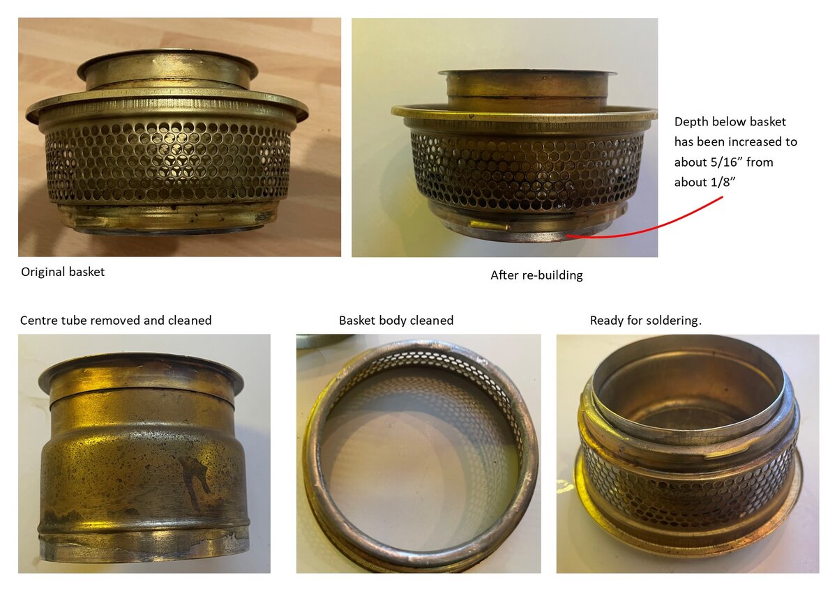

    Well, I finally bit the bullet and stripped the basket apart. The original solder was higher melting point than electrical 60/40 lead/tin, so after cleaning and polishing the parts with wire wool I used lead-free plumbers solder which is higher temperature than the old lead-tin alloy stuff, along with the correct flux. Once fitted back together the basket was washed in water as the flux can be corrosive.
    I now had about 5/16" of tube visible below the basket. I can only assume that it was always like this and maybe why it never got used much.
    The new wick had had some battering with removing and re-fitting and was now too short to rise above the basket by more than about 1/8", so yet another one was fitted.

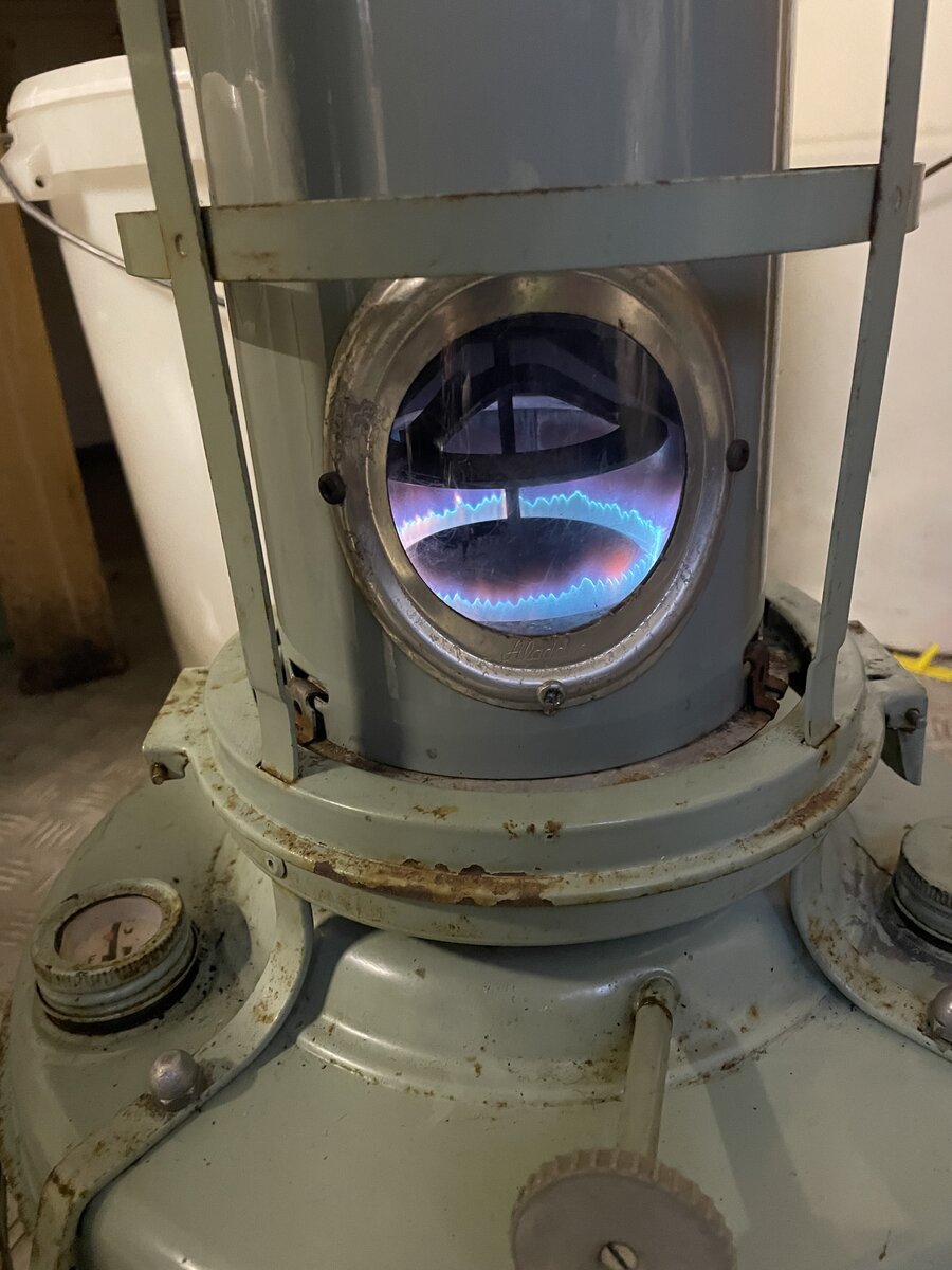

    It is getting better and after a while running and cleaning the wick, it now produces a lasting blue flame. What still confuses me is the fact that the chimney does not always sit square on the burner so has to be nudged sideways a bit to get a good blue flame all round. The is the next thing to sort out. Getting there!
