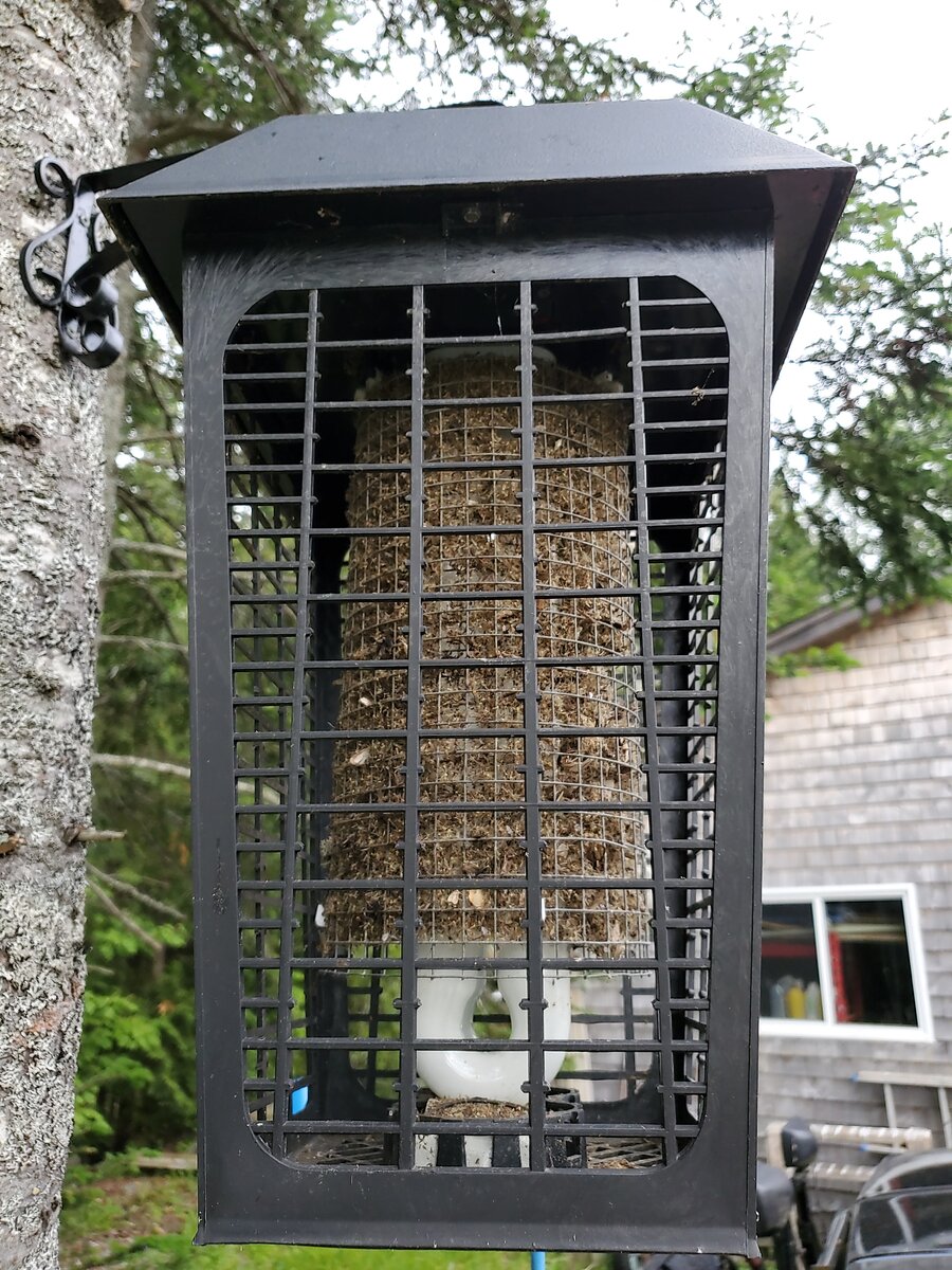

  5. Thomas
    Thomas Subscriber
    Jun 24, 2017
    209
    This is a nights worth of mosquitos at my home, I'm now anxious to get my hands on an amber globe and test this theory.

  7. george
    There's enough mosquitos there to carry your house away!:mrgreen:
    Think you need a flame thrower not an amber globe;)

    @Thomas
    Nice collection of mosquitos there...would be nice to know where in the world you are.

    @Blueflame
    I'm to your south in New Brunswick
  16. podbros
    4,092
    Hum... A few more bats might help as on average they can consume up to 1400 mosquitos per evening, that's just one bat!
    Good photo!
  17. Thomas
    Thomas Subscriber
    Jun 24, 2017
    209
    We used to have loads of bats until the white-nose disease wipe most of them out. For now we make due with screen tents, smoke and DEET
