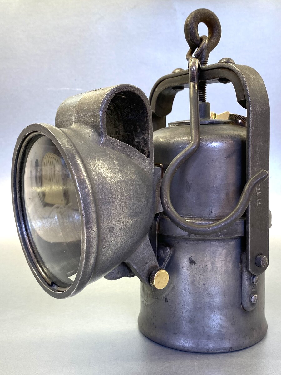

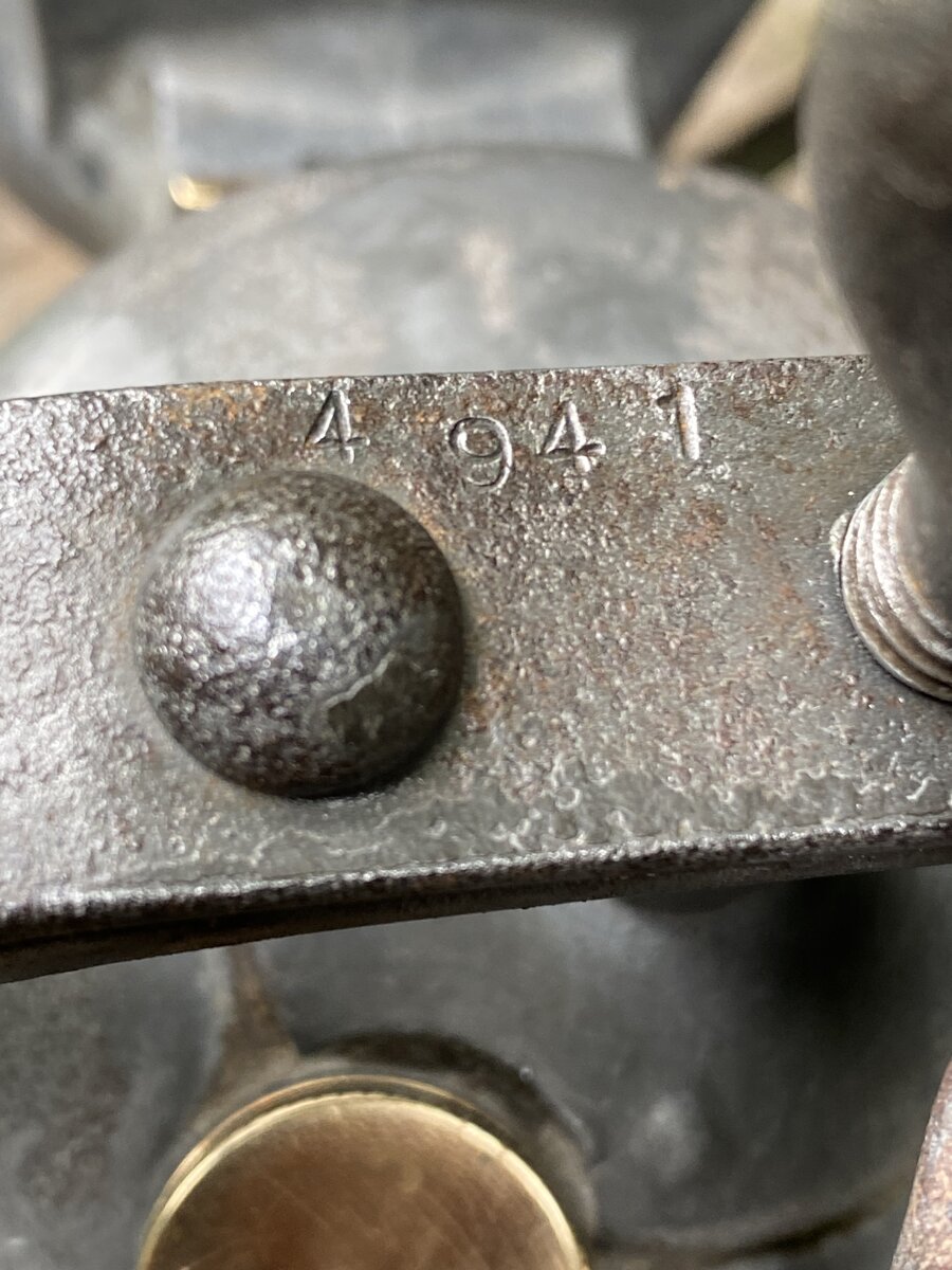

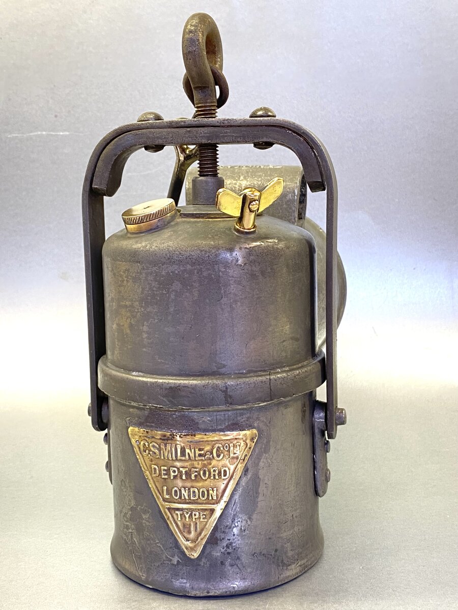

    Stamp on the clamp specifying ‘tested’.
    Date stamp is my guess, 4th September 1941, or perhaps just the month (April) and year.

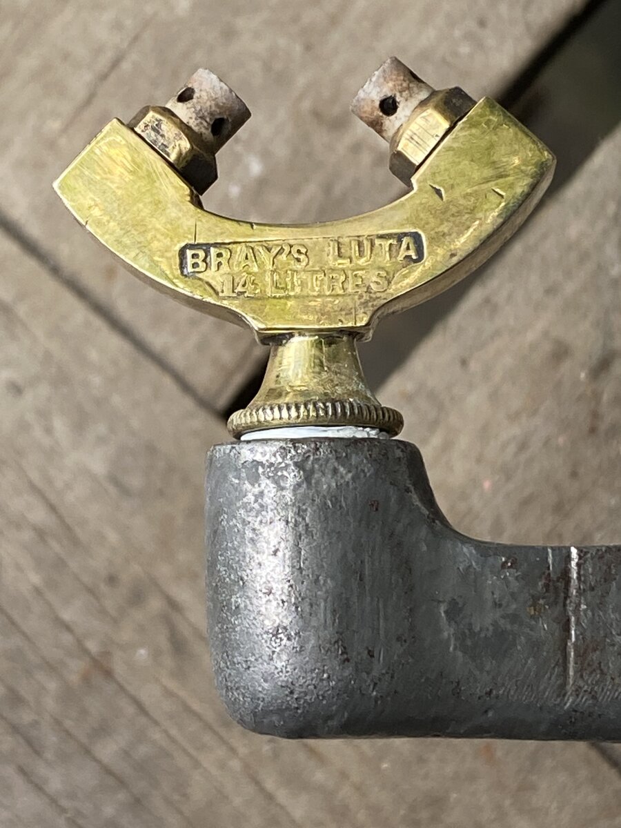

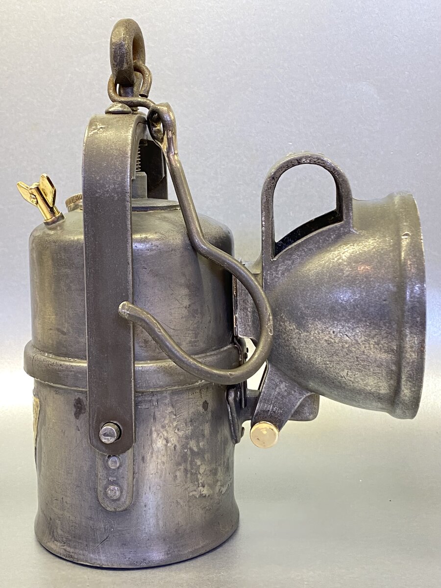

    The burner, a Bray ‘Luta’ of a moderately high output of 14 litres (volume of acetylene passed in a minute). Lutas of greater output could double that figure.

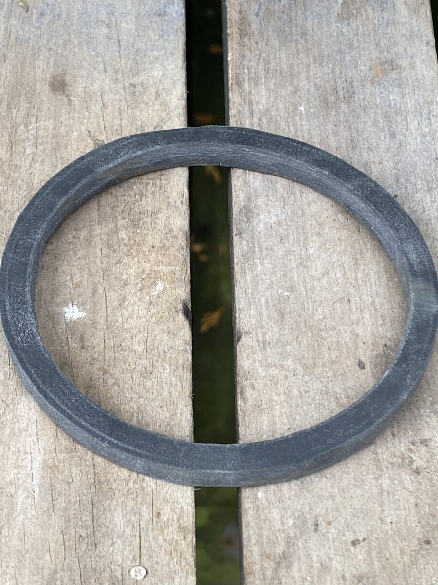

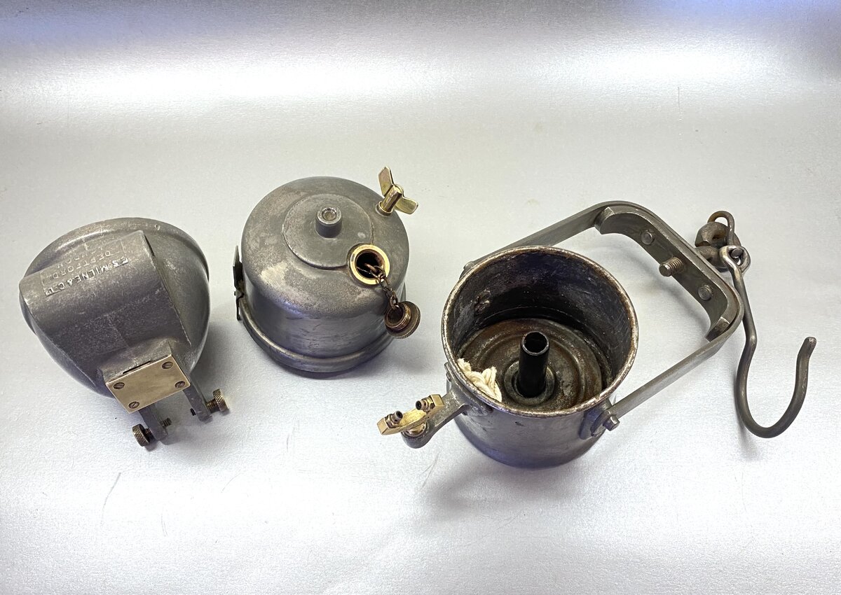

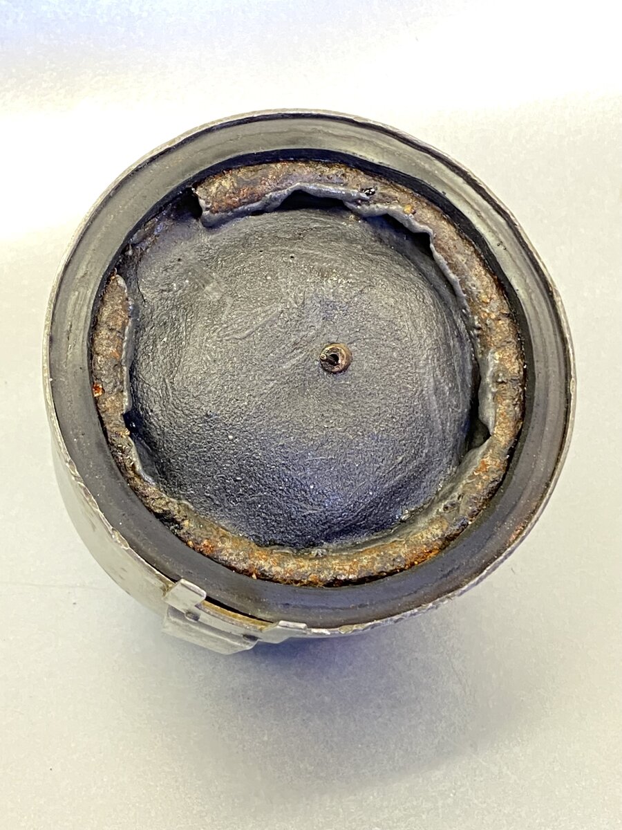

    Some work to do, replacing this water-tank-to-carbide-container seal, perished and broken in its circumference.
    Cut from 8mm nitrile sheet.
    The water tank had rust holes. Rust treatment applied, then lead solder tinning of the surface followed by a coat of JB Weld. New seal inserted. The corroded flange isn’t critical to function.

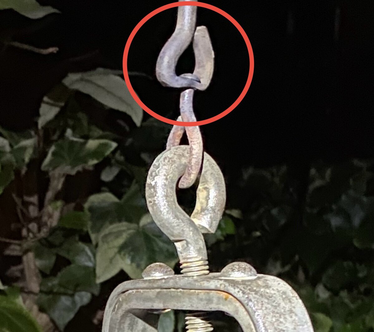

    A shackle loop ringed had sprung and distorted.
    A brazed repair …
    … which I then nickel plated to visually blend with the steel.

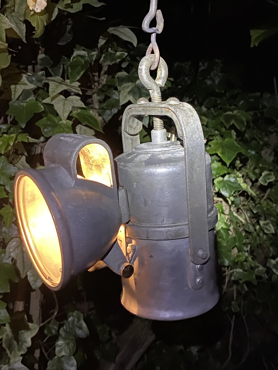

    Fuelled up and lit.
    John

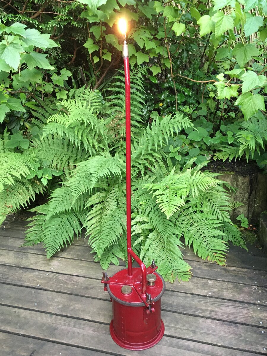

    A bit of biographical detail about the company. This promotional booklet was produced by them around 1911, primarily advertising their oxy-acetylene welding equipment and services.
    This illustration shows the company’s acetylene generator, coupled with an oxygen cylinder.

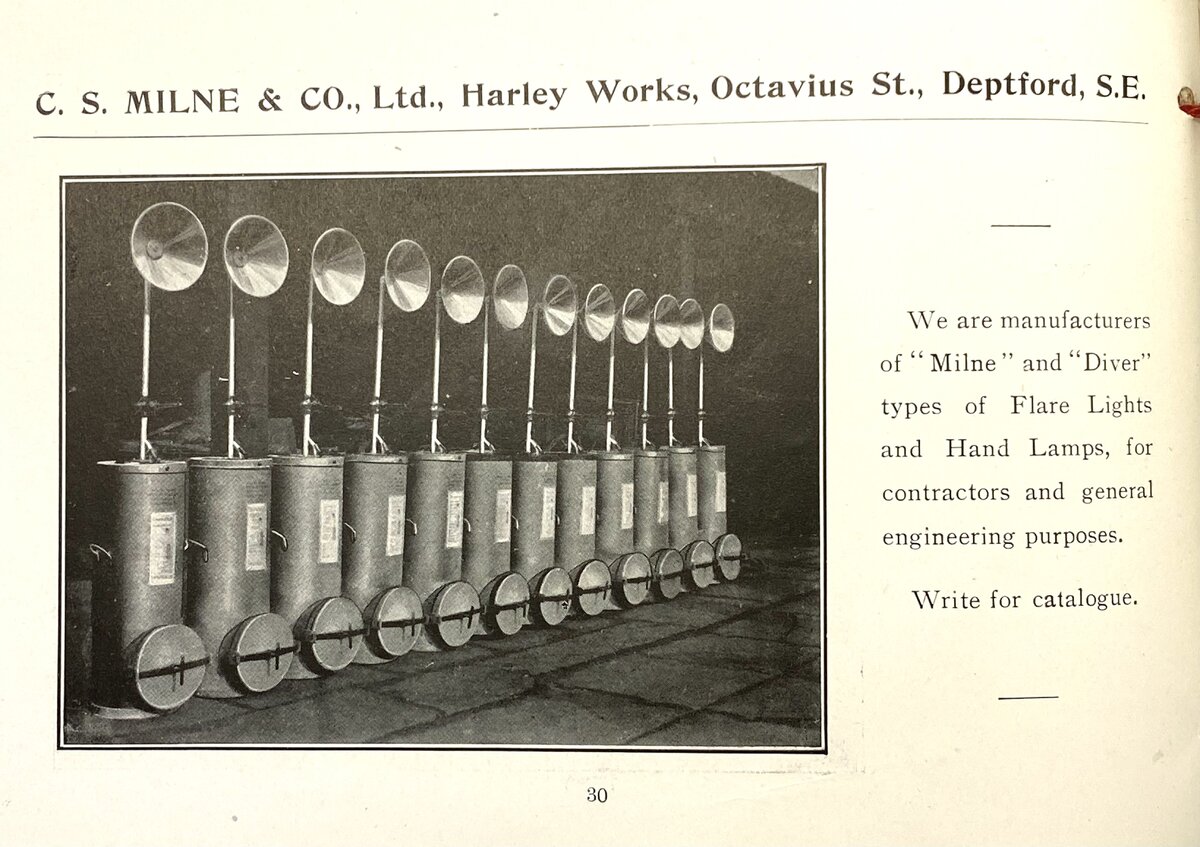

    Though there’s no example of an acetylene hand lamp featured in the booklet, the company evidently manufactured powerful acetylene lamps to illuminate construction work, much as Tilley floodlights did at a later date.
    I have a lamp of that sort, minus a reflector, equipped with a Bray Luta burner with an output of 35 litres, so substantially greater than the 14 litre output of the hand lamp.

    Coming full circle from that chance meeting on a train, fully one hundred years ago, I used Mr Tibbenham’s product to repair that of Mr Milne, a Sifbronze braze of the sprung suspension hook shackle.
