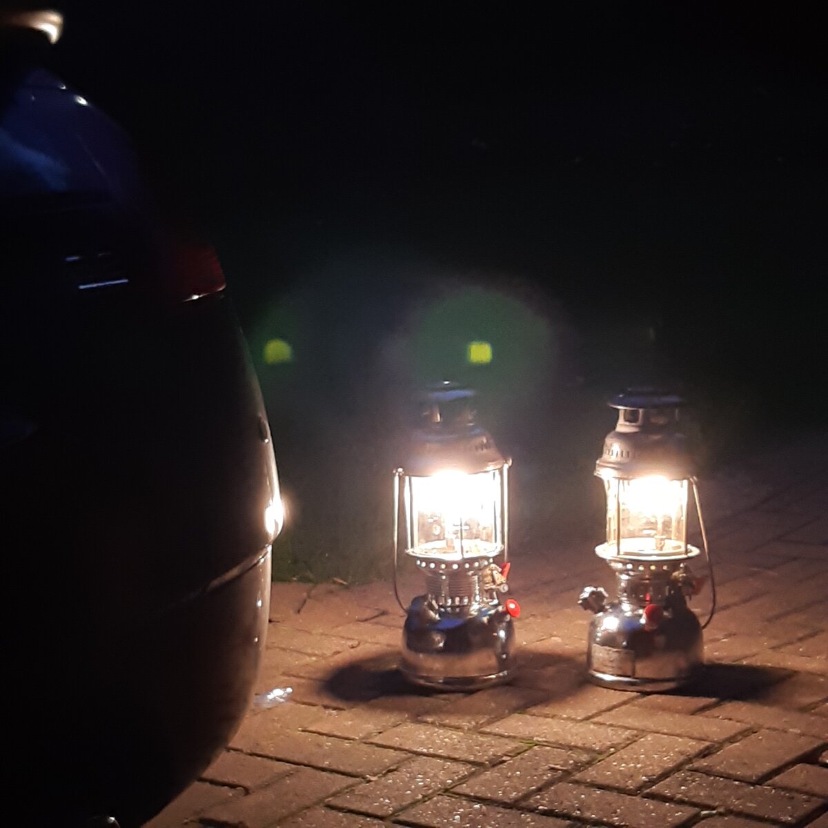

    20201017_182111.jpg 909 on the right, 950 on one left
