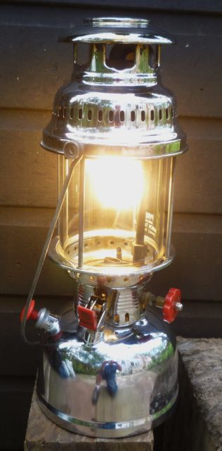

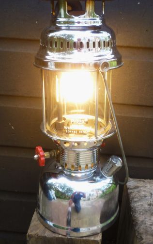

    Thanks Wim, I could not find a post on lighting a Petromax with the "quick-lite" function, but soon realised that I still have to preheat with meths, which I think somewhat defeats the object of the "quick-lite" function. Or have I got it wrong and am missing something? Anyway, it is going now as you can see from the pics, and it is by far the brightest lantern that I have got to date. Think I will keep it until I can get a good Petromax to replace it. Many thanks - Steve.

    Thank you everyone. I have now completed my initiation training on the Petromax and the similarly engineered lamps. I have successfully lit by meths alone, and have just successfully completed a "quick-lite" flash-up. I must admit that the "quick-lite" is very effective and to my amazement, no soot that I expected. Definitely going to keep this lamp until I can find a good Petromax. Thanks again - Steve.

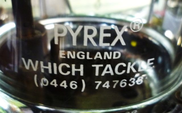

    Jeff, Yes I agree, I have bought at least two before, only to break them for spares. This one still has its original box and I do not think that it has seen daylight more than about twice. They were very popular with fishermen down here on the beaches, so got lots of salt air. Must say though, I am impressed with the light output, and the thickness of the Pyrex glass which is about 5mm thick. This glass is marked unusually with the distributer's name. I attach a pic. Best regards - Steve.
