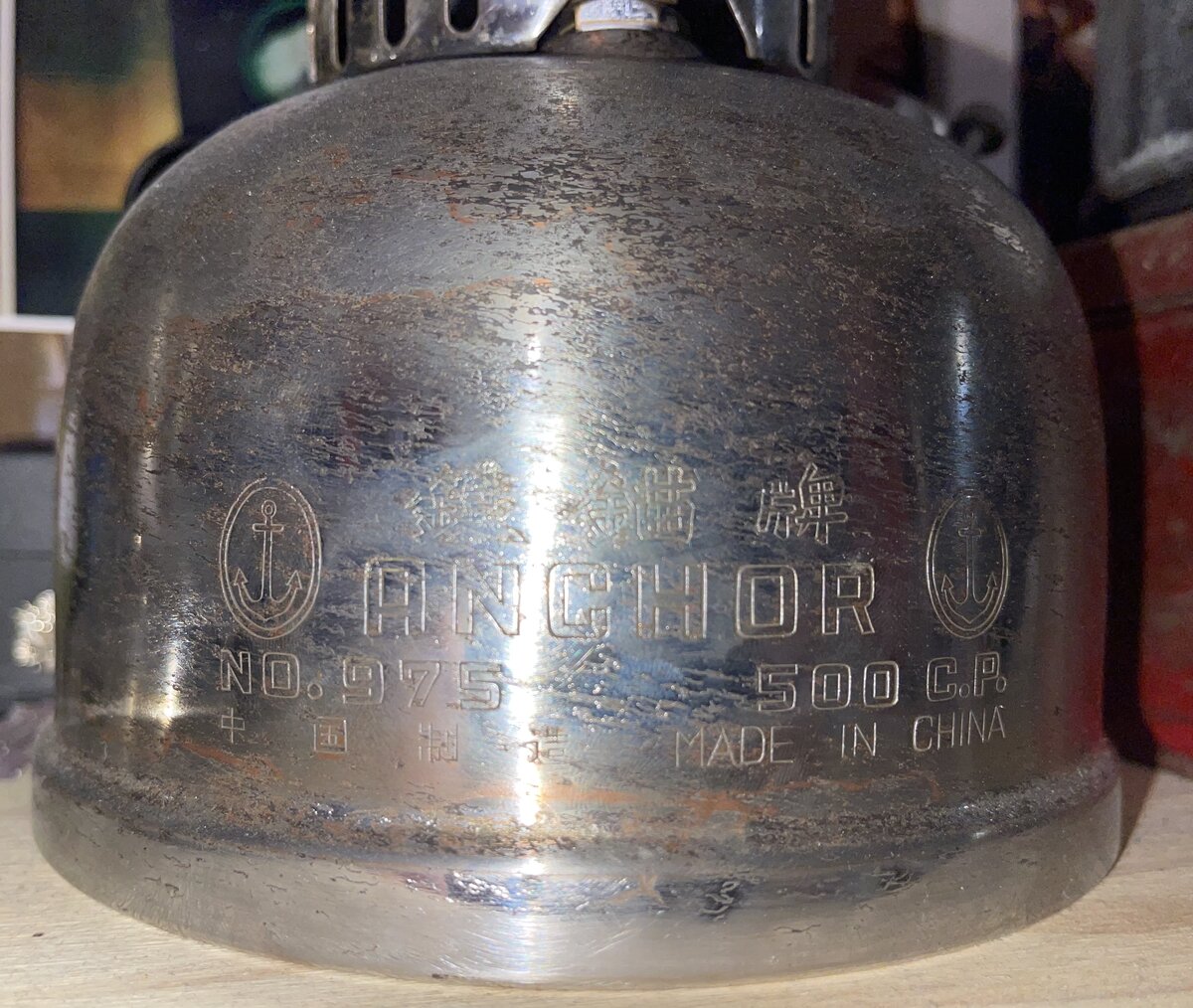

    Hi all
    New here, first post and need some help, please.
    I purchased an Anchor 975 500 c.p. with the intention or restoring. I am still to buy spares however, I have been made aware by a helpful gent from Base Camp that there are many Chinese clones. With this in mind, is there any way I can identify if my Anchor is genuine or not?
    Photos attached.
    Cheers,
    Mark
    311BFC95-6711-4343-8DDE-EA9FD52F7A73.jpeg 4E079C52-C33A-4D07-9E4E-6D6D5BAC8694.jpeg

    @MarkeeMaark Given that the Anchor is a Petromax copy, I’m unaware of a copy-of-the-copy as it were. They’re all copied off the Petromax, but a trade in fake Anchors? I don’t think so.
    The rust on the tank says its made of steel, an Anchor characteristic.
    John
  3. Mackburner
    That's the real deal Anchor 500cp from Shanghai China. They are a copy of Petromax model 523 and other than the corrosion problems with the steel tanks are actually pretty good lanterns. ::Neil::
  4. MYN
    Yes, its genuine. If you can remove the rust, restore to full-functionality and keep it from further rusting, that would be pretty collectible.

    @presscall - ok, interesting. I possibly misunderstood what I was being told and as you say, an Anchor is a copy. Thanks.
    @Mackburner - thanks for the info. Yes, the rust is a disappointment. I am doing my best to remove the corrosion but I still have not decided the best option to get it back (or as close to) it’s original finish. I was also considering a heat resistant coat of colour instead. Good to know that the Ancor 975 is a good lantern.
    @MYN - thanks for this. Yes, genuinely excited to get this up and running. I am hoping that whatever method I choose in the end to either coat/paint, will keep the corrosion away.

  9. adrian yu United Kingdom
    Jan 12, 2022
    16
    Beijing, China
    @MarkeeMaark It has a black knob which means its an early product. 60s or 70s.
    Character on tank is traditional chinese "鐵錨牌",not simplified "铁锚牌" also means its a elder version anchor.
    It may be made in Shanghai lantern factory or Xinxin lantern factory.
    The anchor lanterns made before 1990 has a good quality but it looks like you have a lot of work to remove the rusts.

    Am I right in understanding that these were originally chrome plated?

    @MarkeeMaark yes you are right. The outside layer is chrome plating and the second layer is copper plating hence you can see a brass like colour.
