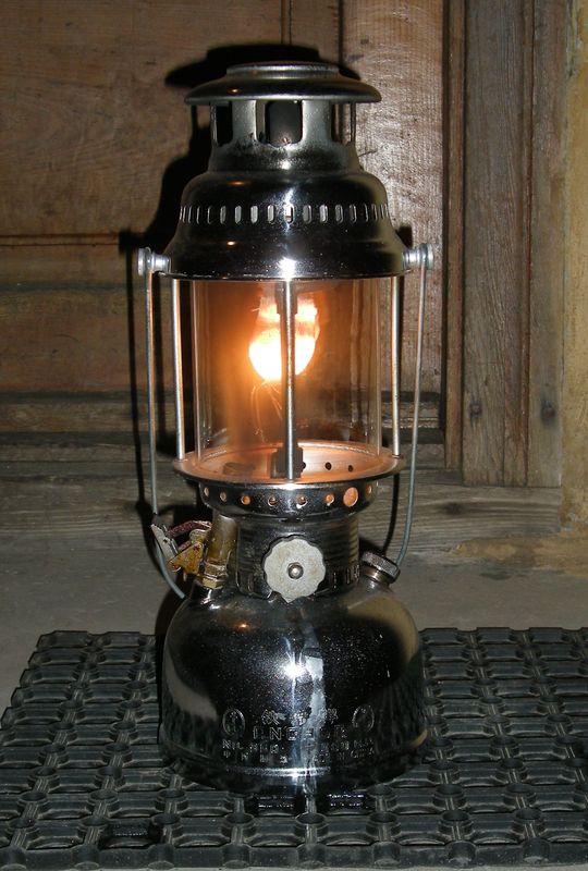

    Have fired Anchor 500CP lamp. I've got it (and another one, the same brand) from a girl in the Owl Mountains, or similar strange place.
    Under the chrome are small pimples, so polishing, waxing, cleaning inner part of the hood, applying Brunox epoxy anti-rust and silver heat-proof paint.
    It was keeping pressure for a couple of days, so OK.
    Firing proved that is leak between lower and upper part of the vapouriser -- some fire appeared. Tightening with the spanner, leak decreased, but not vanished totally.

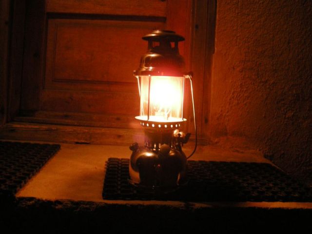

    The mantle had a orange 'halo' and is not glowing whole, but lower part only, on the upper part, slightly over 'equator' is a black ring.
    It tried to dim (pumping-up helped) and there was moment of pulsing of the light.
    Smoke after curing of anti-rust and fireproof paint has gone.
    Mostly unwelcome is ring of soot on the upper part of mantle. I don't want to buy stainless burner -- it will cost more, than both of lamps...
