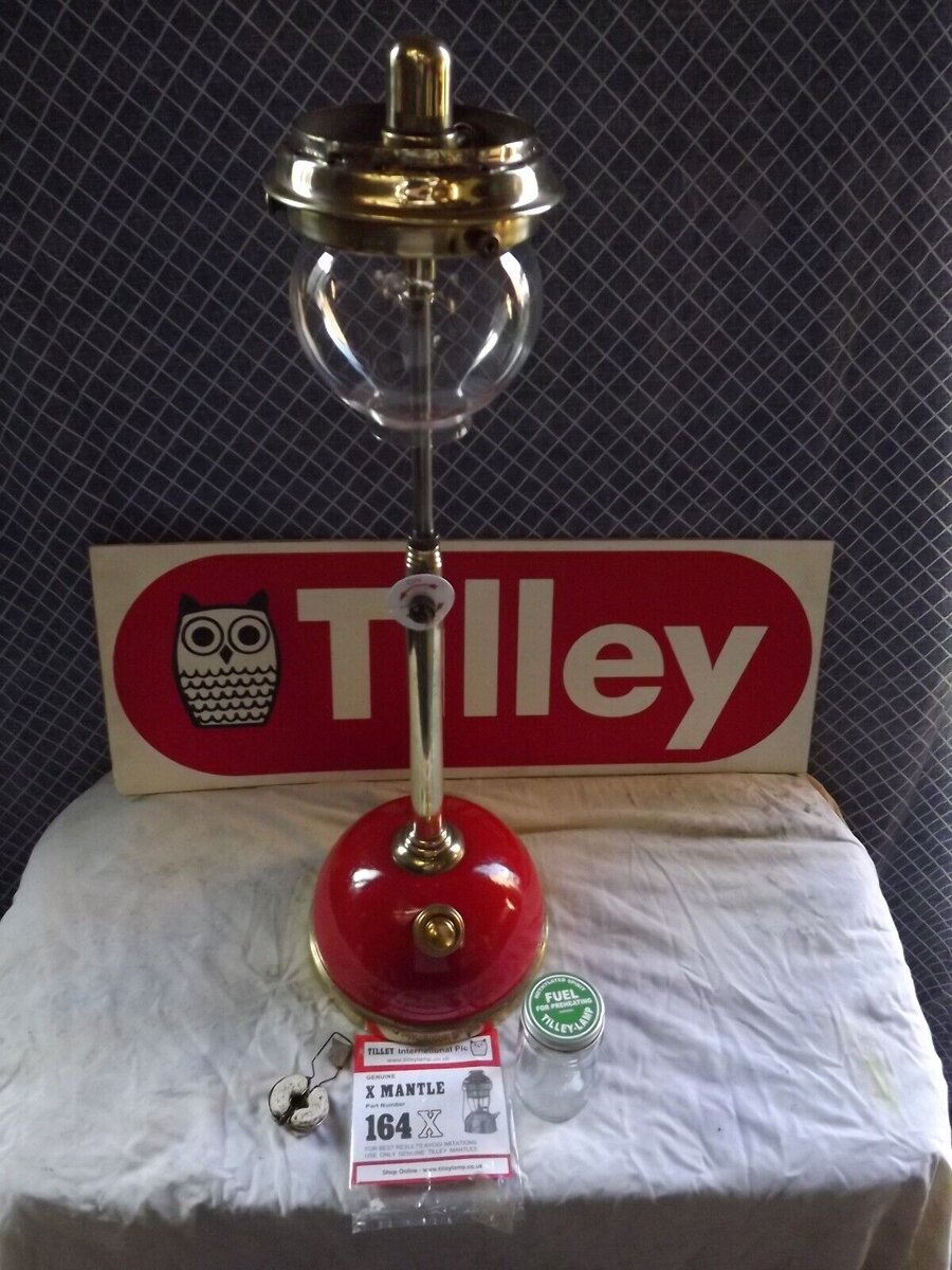

    Hiya Folks,
    Just one this lamp in an eBay auction, and would like to know which model it is:

    That's in lovely restored condition, I do like that red colour ,it looks good on it, I might even paint one of mine in red later this year when its warmer outside.

  7. David Shouksmith
    Restored to what, though... :-k

    Nice shiny shelf queen, hopefully it works as good as it looks

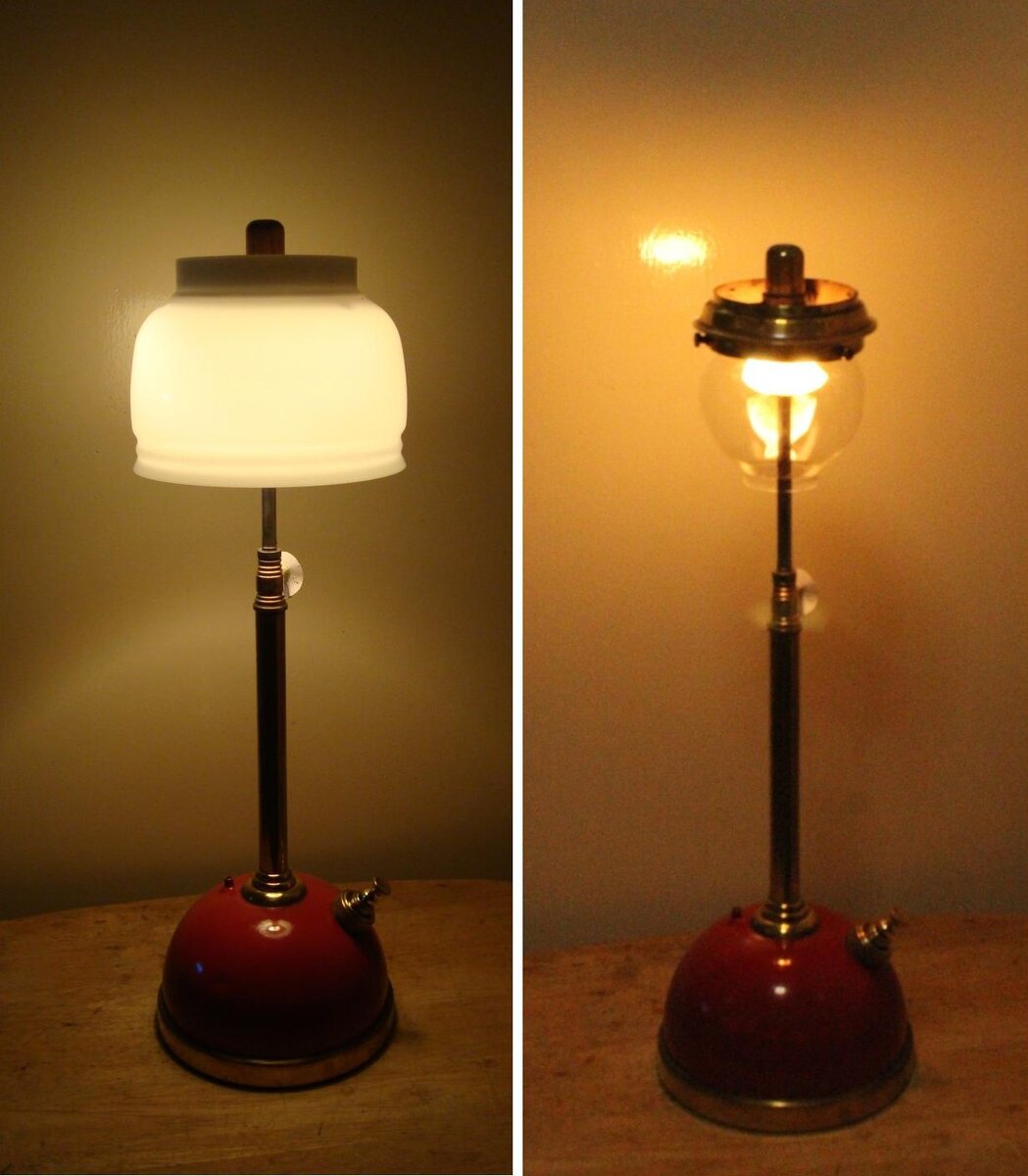

    I've now got the shade for the lamp, and here's a picture showing it with and without it:
    Apologies for the blurred picture :oops:
