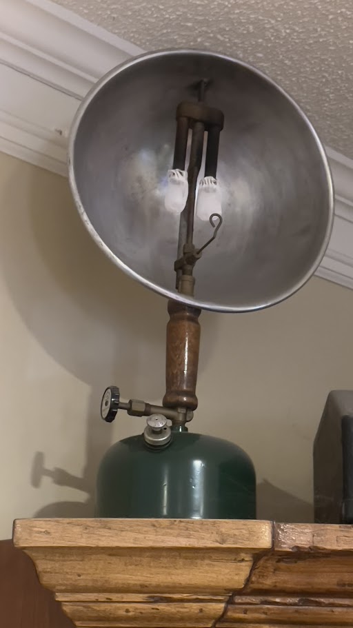

    B9C65360-7537-47CD-ABB4-38EA60827BEB.jpeg Anyone know about this? Is it modern?
  2. Henry Plews
    3,069
    I've seen these before. They were used for flounder gigging. There should be a date code stamped on the base plate.

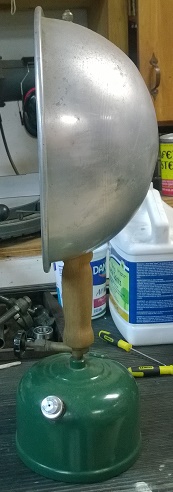

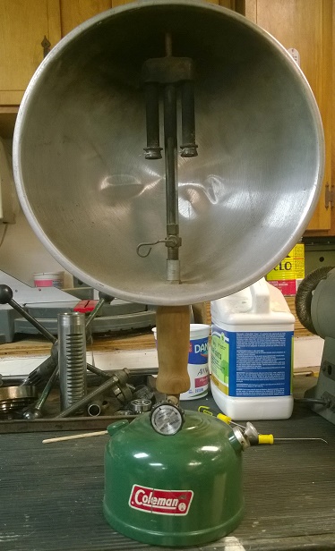

    @Reese Williams has one of these:
    From this thread:

    Thanks for the interesting information! Wow! A homemade reflector? Not sure if it was ingenious or dumb.

    The reflector doesn’t look that bad in Reese’s example.

    Late to the party here. Not much to add to what Tony quoted except that a properly polished aluminum bowl makes a very efficient reflector. From what I can tell of your picture it is one of the commercially made one. I believe (without looking) that mine is also dated 77. I believe the maker was buying replacement founts from Coleman then made up the flounder lamps.

    I’ve seen a couple of these for sale. After looking it at again, I can see how it could be homemade.
    I wonder if it could be used as a heater? Like a small radiant heater?

    I would think a regular lantern would put out as much if not more heat than the flounder lamp. There isn't that much thermal mass to that aluminum pan compared to the globe and vent on a lantern. The exposed mantles are also a bit problematic. Maybe with a lamp globe to protect the mantles?

    I own one of these. Got it to work. For years I have been wondering what I had purchased back then. Never saw another one of these. It's pretty bright, but as mentioned above those exposed mantles always worried me. IMG_9147.jpg

    How would one make a wire mesh mantle?

    A wire mesh mantle would glow red, and operate somewhat as a radiator, depending how well its air/gas ratios were. It could not operate as a light.
    One option to stop insects wrecking the mantles is to put a mesh screen over the reflector. Alternatively, arrange, somehow, a mica cuff (globe) over the burner and mantles.
