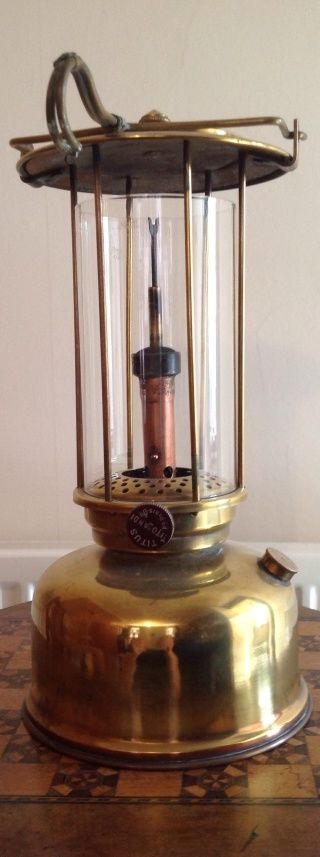

    OK, the lamp is here, and it's in remarkably good condition. The wick appears to be new!
    Problem, I can't get the top off to measure the jet size.

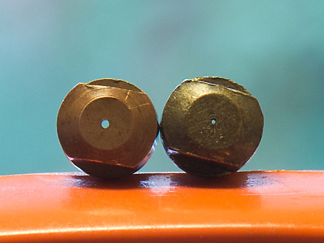

    As I was tinkering with the lamps, I took the opportunity to take a photo of the two different jets.
    It's quite easy to distinguish them from easch other even if you shouldn't actually have the other to compare with:
    (The total width of a jet is 10 mm.)

    Alcohol lamps always has a larger jet compared to paraffin or petrol, and this fact is quite often mentioned.
    And as I wrote above regarding Tito-Landi: Alcohol jet has appr. twice the orifice diameter compared to the petrol jet. Perhaps around 0.8 mm for the alcohol compared to 0.3/0.4 mm for the petrol. (Mind you! Not any exact figures. Only made by a hunch.)

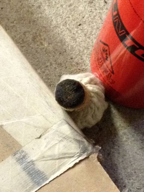

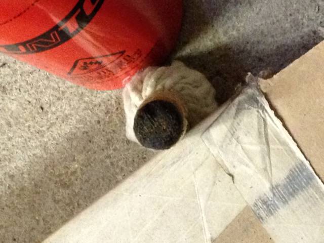

    Well, the trouble is the wick and valve.
    I've enclosed photos of the wick. The end is fouled, and the original screen is completely gone save for what appear to be a "rust shadow".
    The jet is clear, but air does not pass through the valve.
    A previous owner soldered the gallery to the base, so I have to unsolder that to get to the valve assembly. I guess I needed a project.
    At least all of the bits are sound.

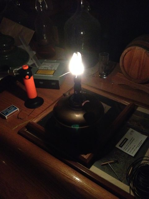

    I put a Coleman #21 mantle on it and finally got some light. I'm a but surprised at how much heat is transferred to the fount! Really looking forward to seeing it run with a proper wick and screen in place.
    1402805456-iPhone_007_opt.jpg 1402805467-iPhone_005_opt.jpg 1402805476-iPhone_006_opt.jpg

    Well fettled Al! :thumbup: :clap: :clap: :thumbup:
    The blue flame from the meths is better, so I reckon that is the fuel for it, Jeff.
