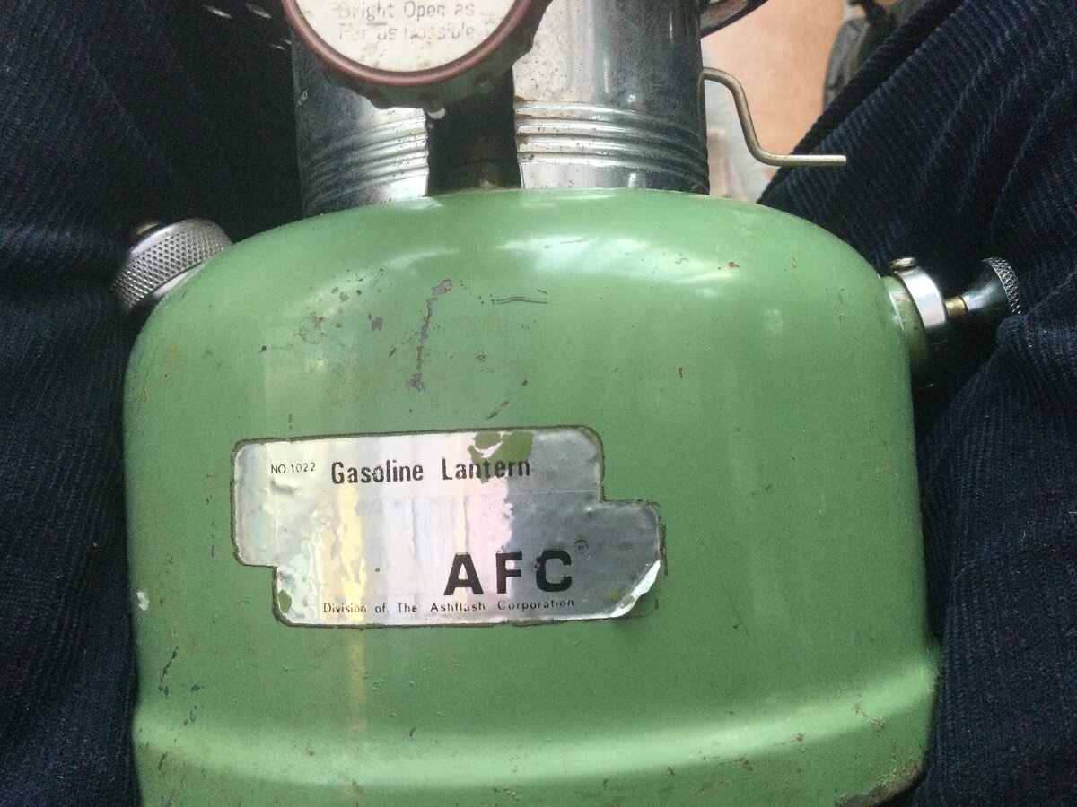

    I have got my hands on an AFC 1022 (see photo)
    The sticker says ‘Gasoline’, but’ the presence of a spirit cup and the fact that I’ve read somewhere that they can be converted has raised my suspicions!
    Sniffing the fount is inconclusive, I suspect it has been washed out and not used for many years.
    How can I tell? And, if I have to do a ‘best guess’ test burn, which is the best way round and least likely to result in a fireball, and upset wife? Paraffin or Naphtha?

  2. Fireexit1 United Kingdom
    3,525
    Hmm - tough call. People do add pre-heaters to these for use with naptha as they can get exciting to light. Is there any way of seeing if a conversion was done by looking at the jet or any markings on it ?
    @ColinG might have some ideas

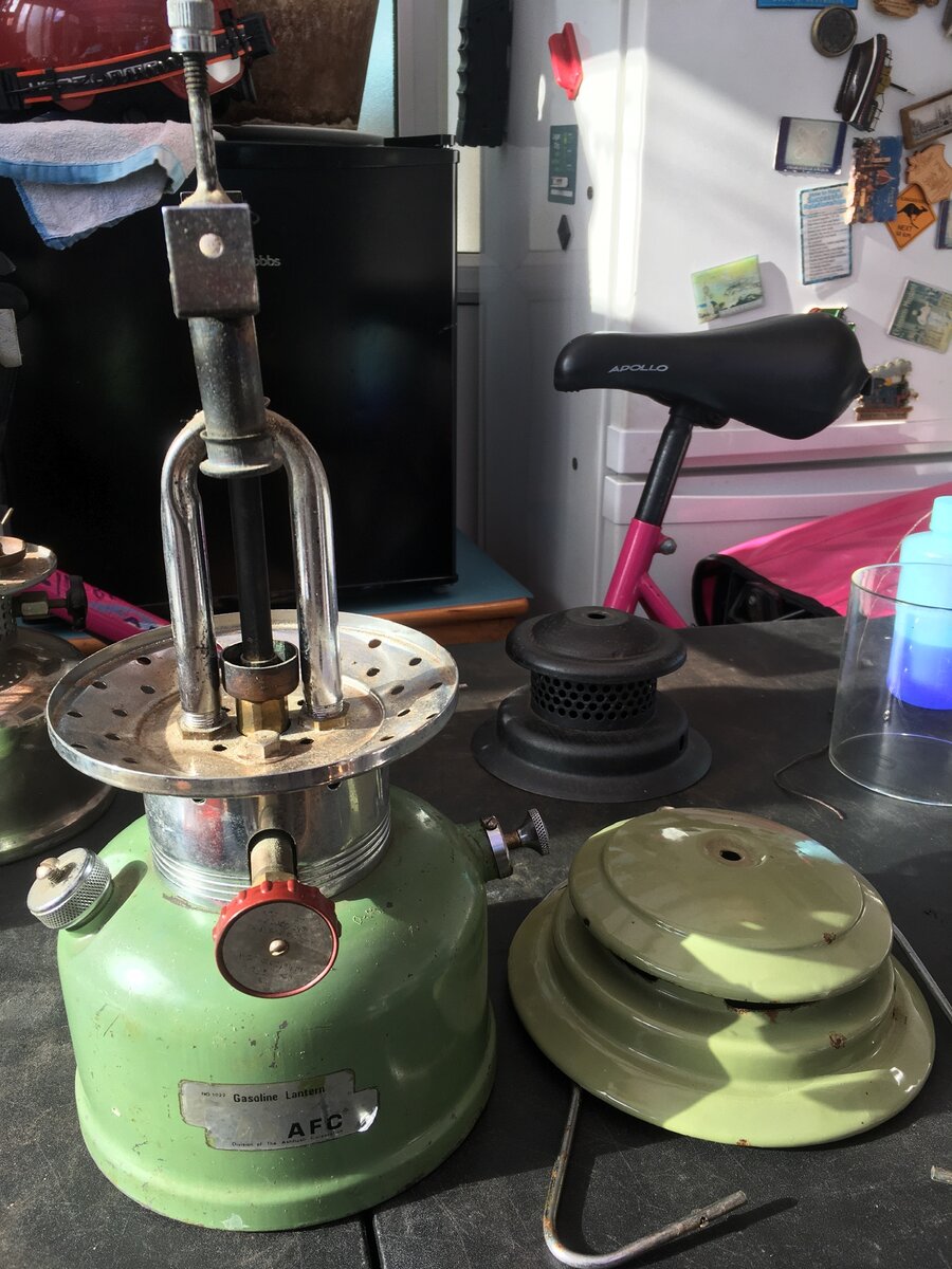

  3. Greencricketer United States
    Aug 9, 2018
    23
    London
    Thanks for the response. I’ve just packed it away for the day! I’ll get it out in the morning, take it apart and post some pictures.
    Many thanks
    David
  4. Darryl Durdin
    1,626
    @Greencricketer .I Use kerosene in mine, I haven’t come across an Ash Flash that uses Coleman fuel/ petrol/gasoline . There are other rebranded ash flash, campway,Nomad. They are the same lanterns all use kerosene
    I hope this helps.
  5. Greencricketer United States
    Aug 9, 2018
    23
    London
    Thank you for the response. I just wonder why it would have gasoline on the label, unless gasoline is a ‘catch all’ for all these fuels. CE568793-5C02-4497-AE38-DE20D2F2DC5A.jpeg
  6. Darryl Durdin
    1,626
    @Greencricketer ive been looking through the lantern gallery under Chinese ash flash company. There is a few different models and some of the reading tends about running on gasoline, in some of my adventures with lanterns some petrol lanterns have spirt cups, use them just like kerosene it preheats the vaporiser/ generator and avoids the big flare up you get when starting a petrol lantern.
    If you search the gallery you may find your answers, safety tip, use minimal petrol to start with make sure your shut off valve works and no leaks anywhere.
    I hope this helps
  7. Norman
    Jul 1, 2011
    747
    Spokane, WA
    I installed a preheater cup on my Ashflash because the preheater side of the Ashflash in most cases doesn't work so it is very exciting when firing one of these lanterns up.
    Your Ashflash is a gasoline powered lantern but I prefer to use Coleman Fuel in mine.

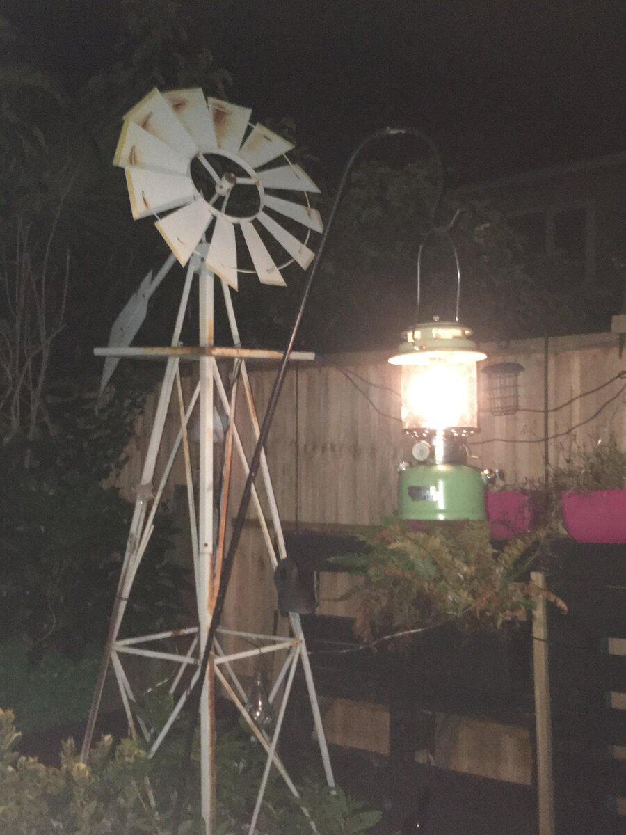

  19. Greencricketer United States
    Aug 9, 2018
    23
    London
    Thank you every one who responded to my mail. Ash flash 1022 now lighting my garden very nicely. Running on Holts brake cleaner (pure Naphtha). A very quiet lantern! 69072A6F-5026-4DB6-8D92-6E36AB8843DE.jpeg
  20. Darryl Durdin
    1,626
    How very cool. Looking great
  21. ColinG United Kingdom
    4,815
    An excellent result and what a great light output! Well done.
  22. Fireexit1 United Kingdom
    3,525
    Another one saved - looks good and it is going very well :thumbup:
  23. Norman
    Jul 1, 2011
    747
    Spokane, WA
    Well done well done indeed.
    Your Ashflash is doing what it is suppose to do and that's lighting up the country side.
