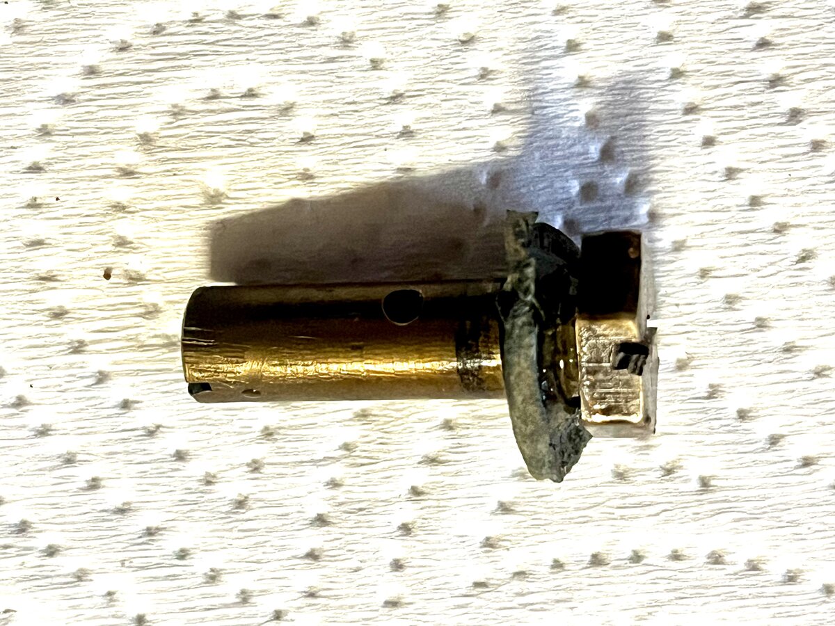

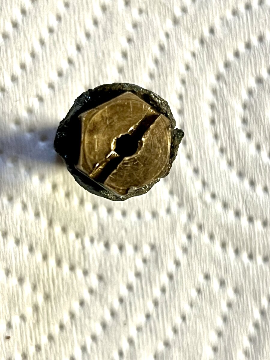

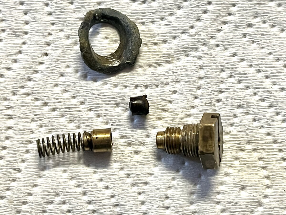

  11. Tony Press
    11,105
    @LanternTom
    The NRV (pump valve) is a standard Primus-type stove set up:
    It has a slot for a wide screw driver; but it is also an 11mm (7/16”) hex.
    The original pip is most likely cork but I’ll use Viton to replace it.
    The spring is not hard. It’s quite flexible. The trick is to make sure the pip sits flat about 1mm above the cup, so that it makes a clean seal against the brass above it.
    The NRV is fitted with a lead washer.
    When removing the tube that covers the spring, cup and pip, use a drill chuck to hold the tube, rather than using a screw diver in the slot at the bottom of the tube.
