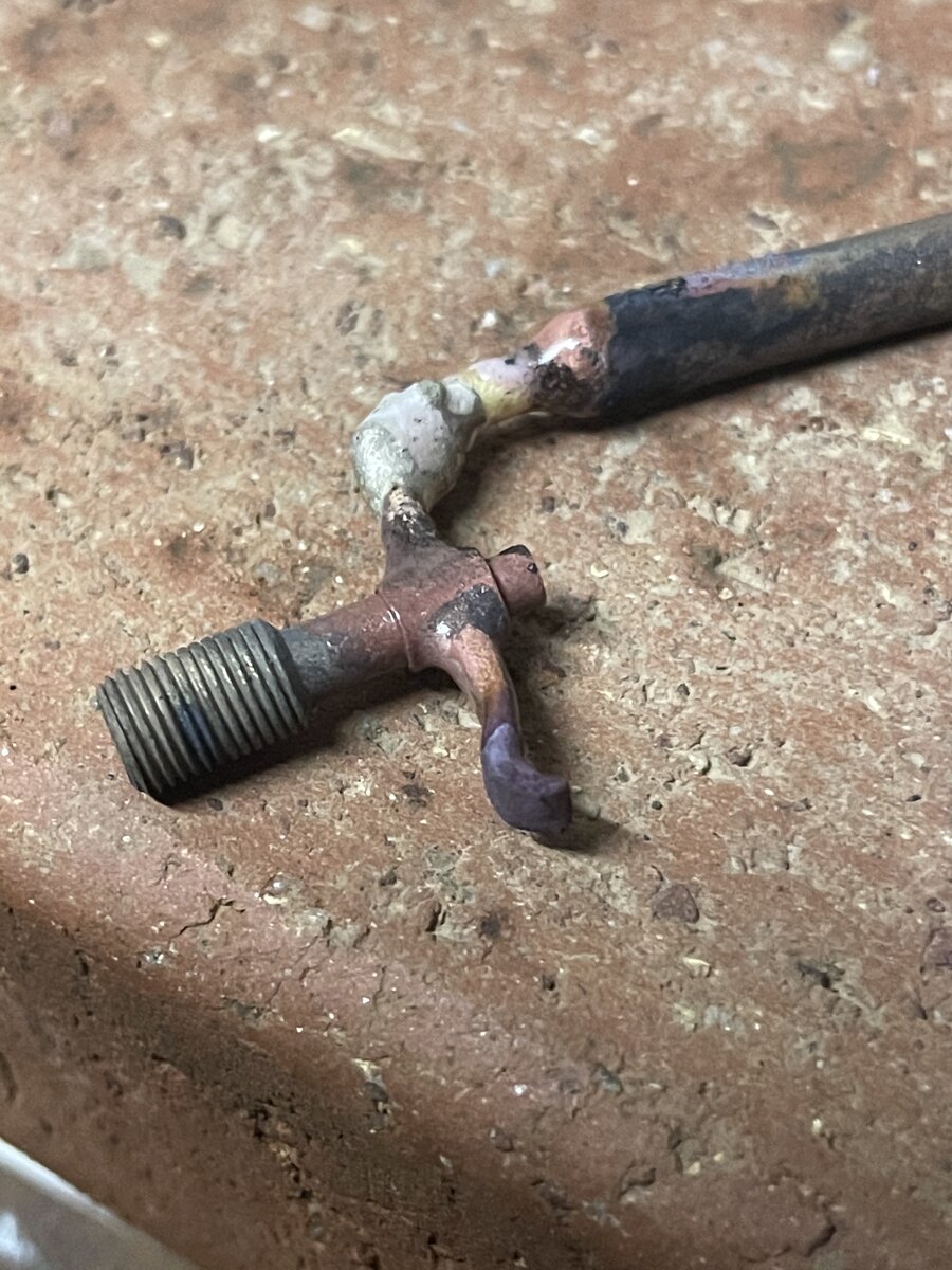

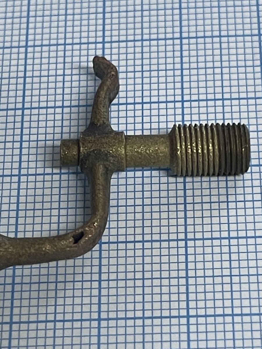

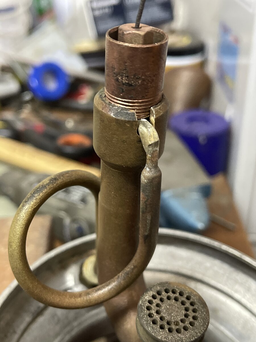

    I set about cleaning up the lamp. The globe is in excellent condition, the lamp look complete. Once I had dismantled the lamp I could see generator tube and the pricker needed some attention. Whic some helpful advice @Anthony @Tony Press

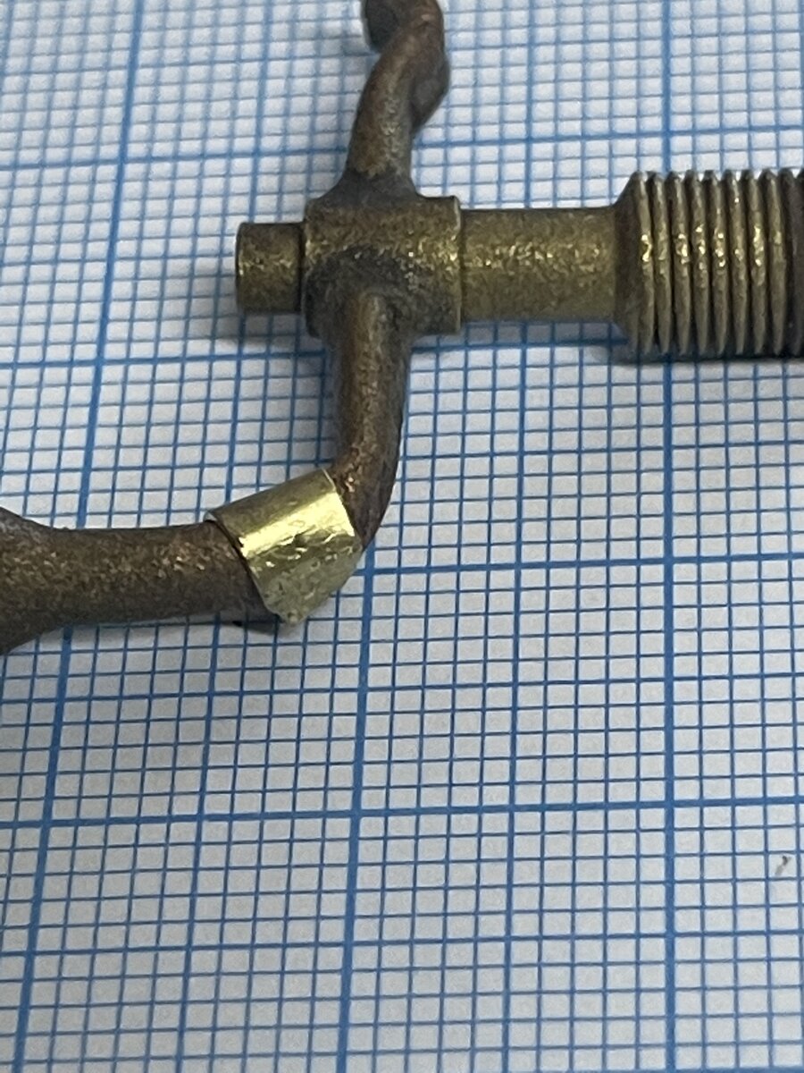

    The generator tube had corrosion repair. Testing my fettle skills I set about repair.
    I cut and sized up a brass patch that I silver soldered in place, filed and shaped the repair to best fit the generator holder.
    C5F21D21-C668-4594-BA0D-CBFD26589859.jpeg EBDF8C6C-5AE2-432C-8FE4-7822B0F6D4FC.jpeg 14E2C396-0642-4801-9C33-0E17B61147FD.jpeg 368E6472-37D6-47A2-837D-55D56CB0CF15.jpeg

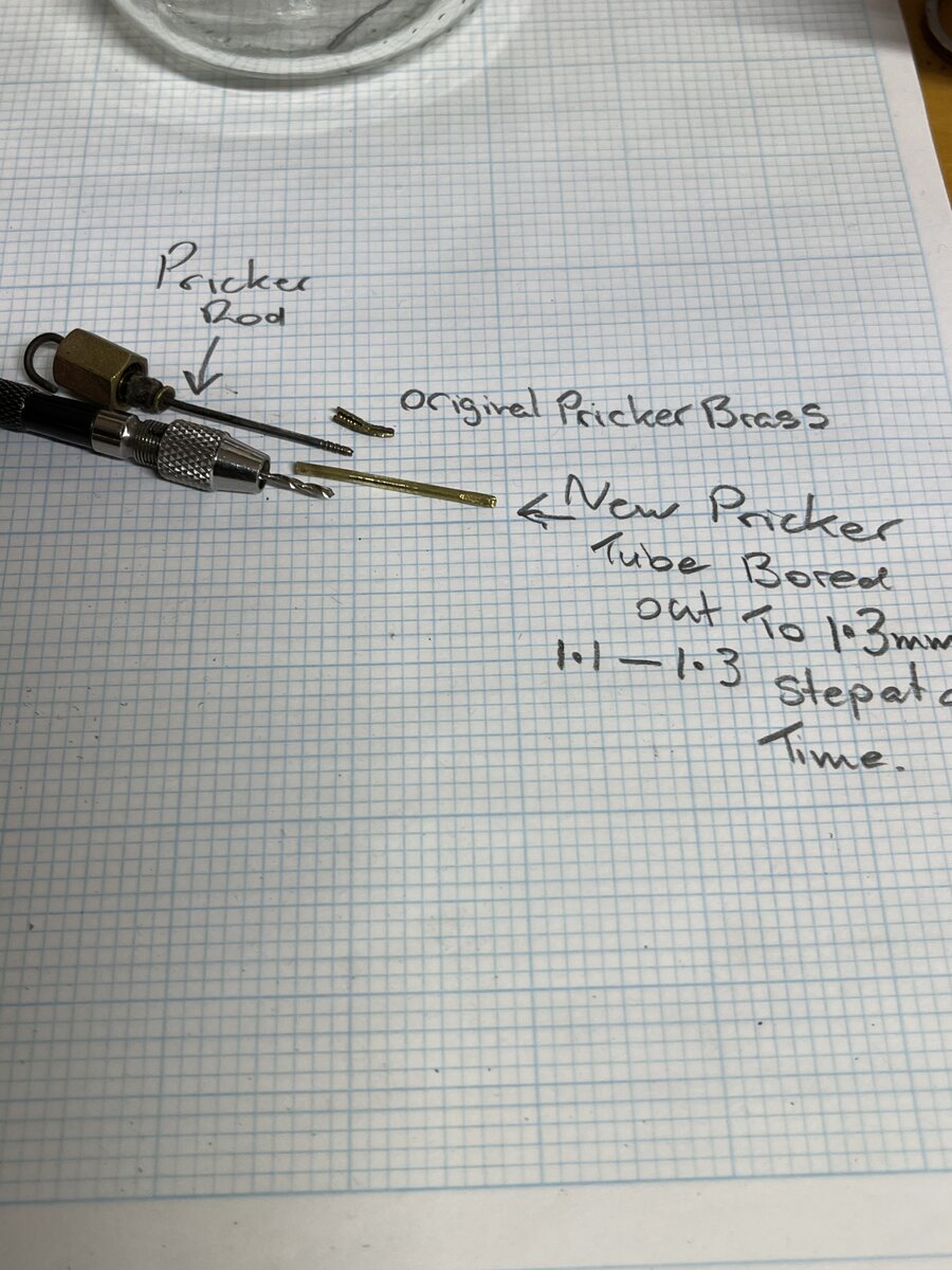

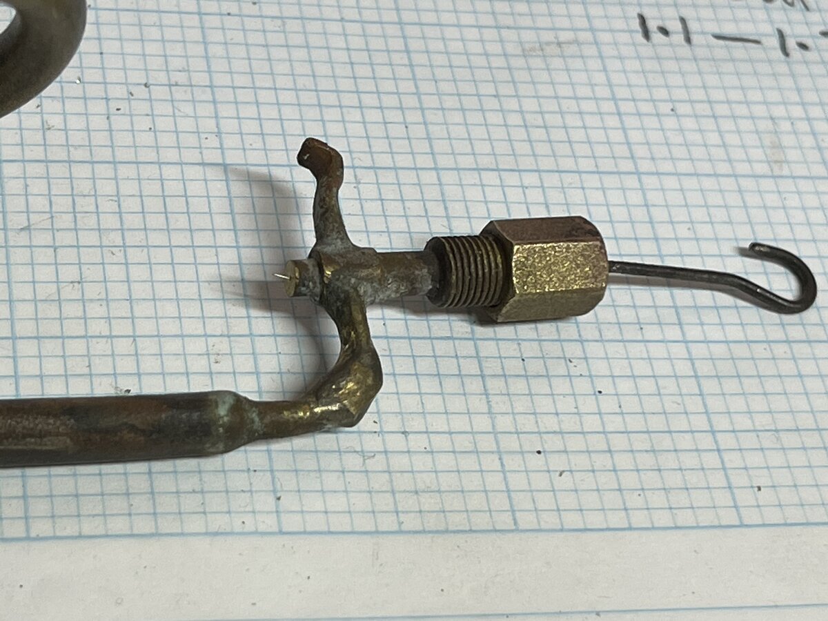

    next I had to remake the pricker.
    I copied what I had, made the brass needle seat, re seated the pricker needle and fine tuning to suit.

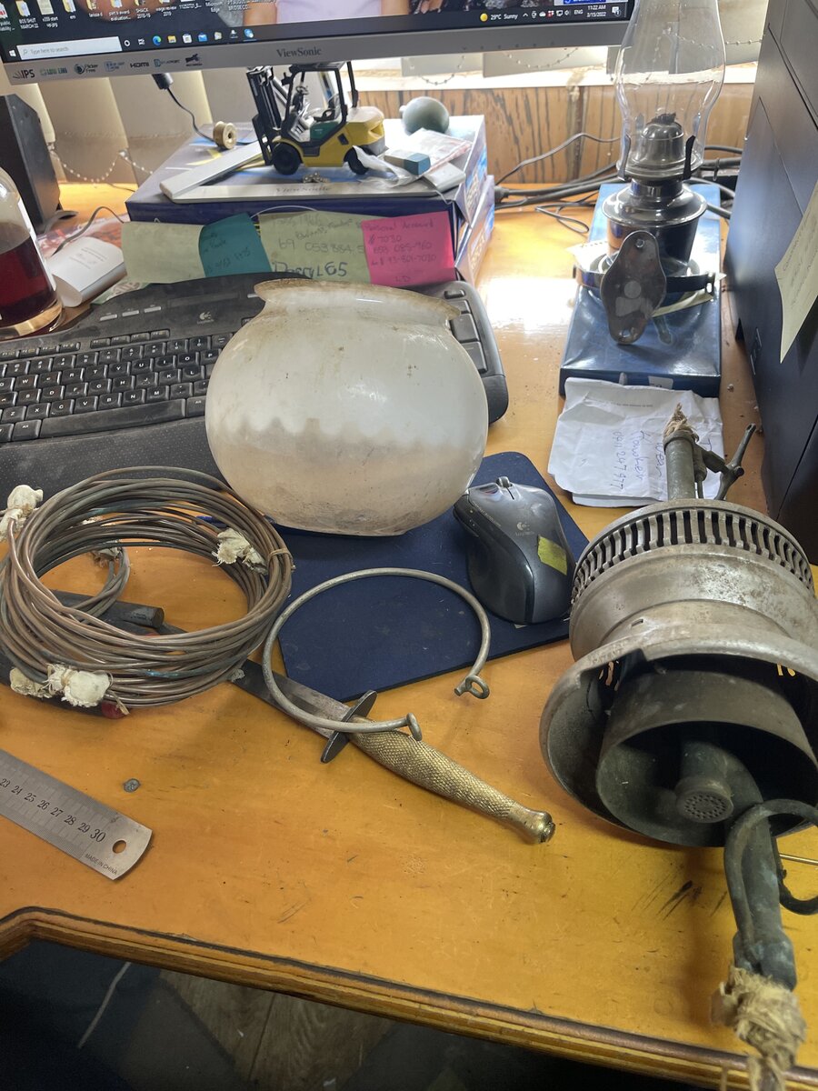

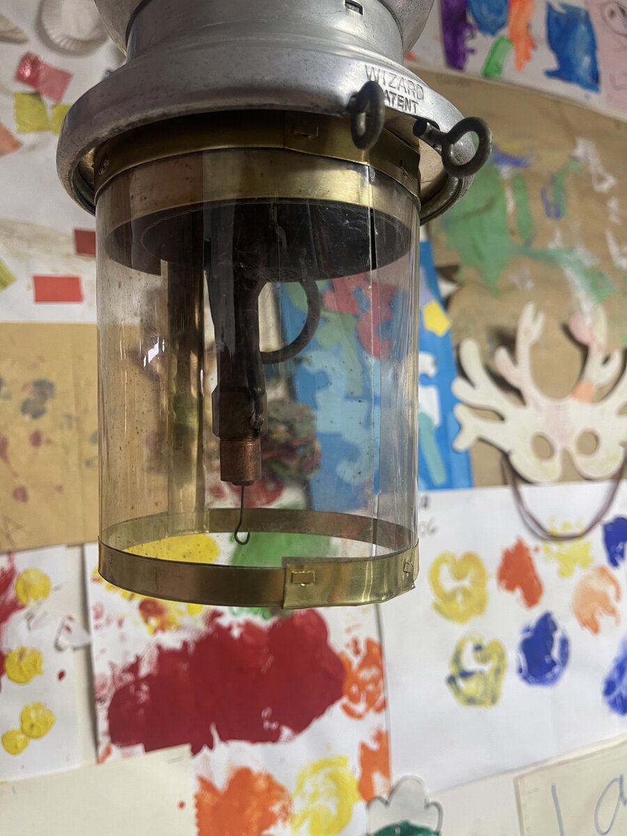

    I have an original globe but decided to make a mica globe for it.

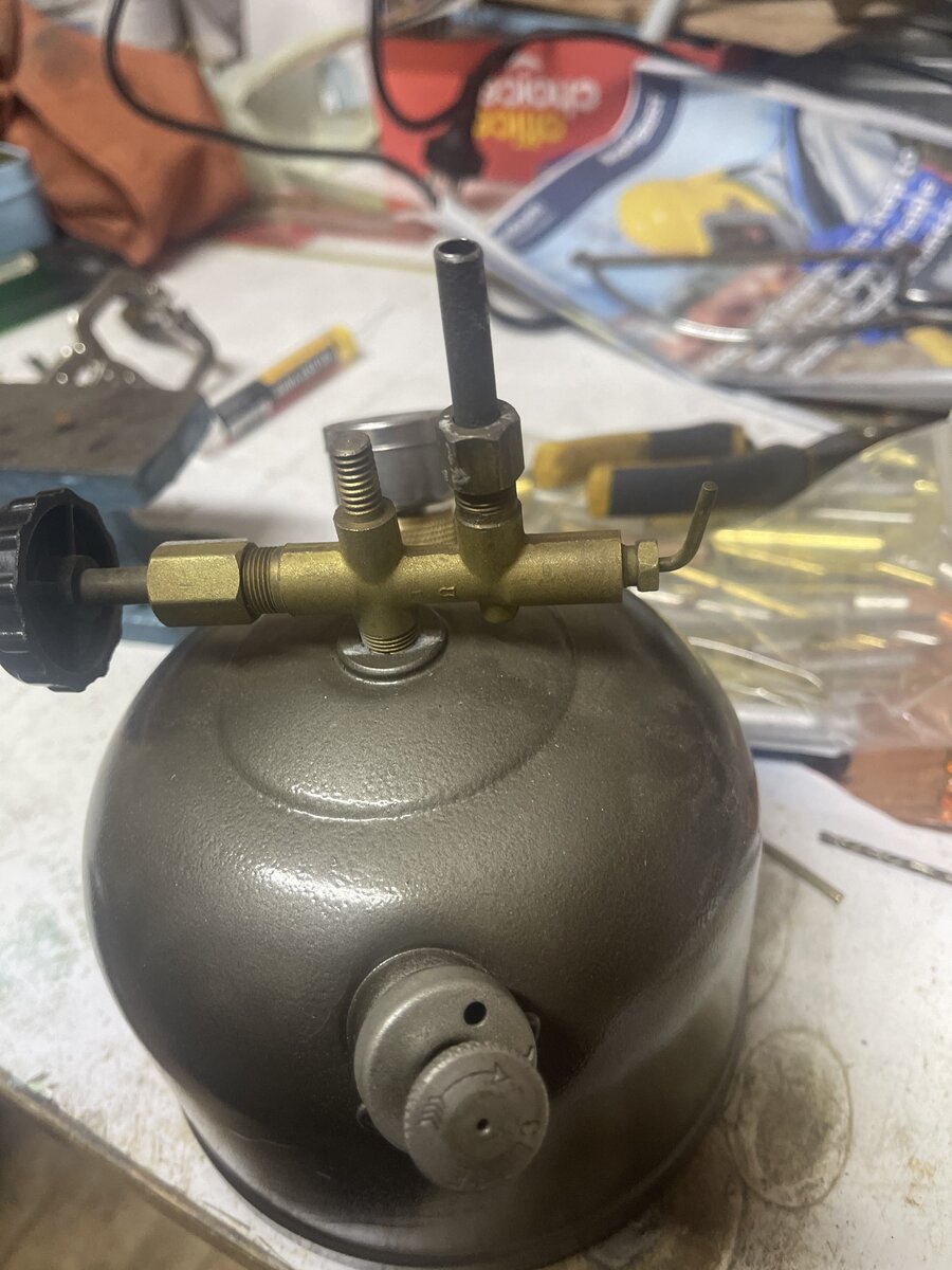

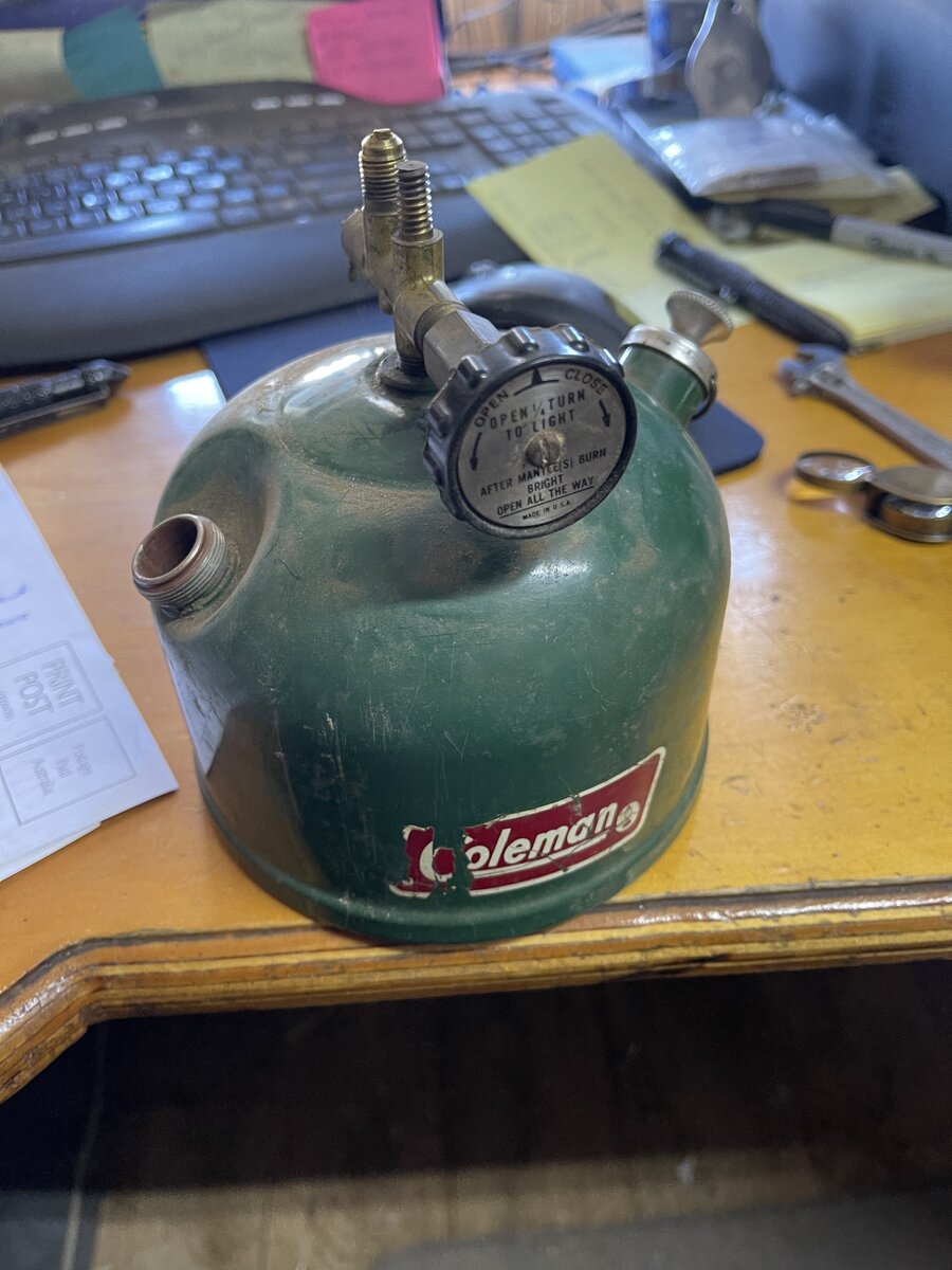

    I converted a Coleman fount to be my fuel pressure vessel, I bought a filler cap with the built in pressure gauge , modified the generator and removed the pricker rod assembly so as to have clear pass for the fuel.

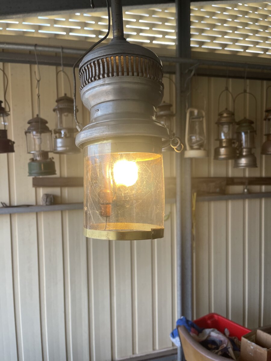

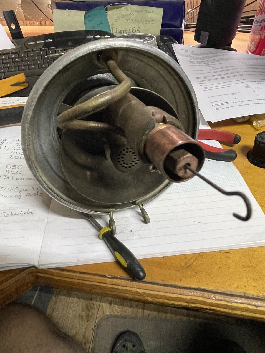

    I assembled everything and set about getting the lamp to life.
    It all went to plan. A bit of flare up but settled I adjusted the pricker and away it went
