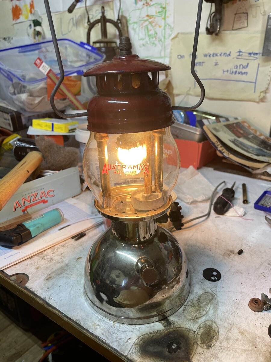

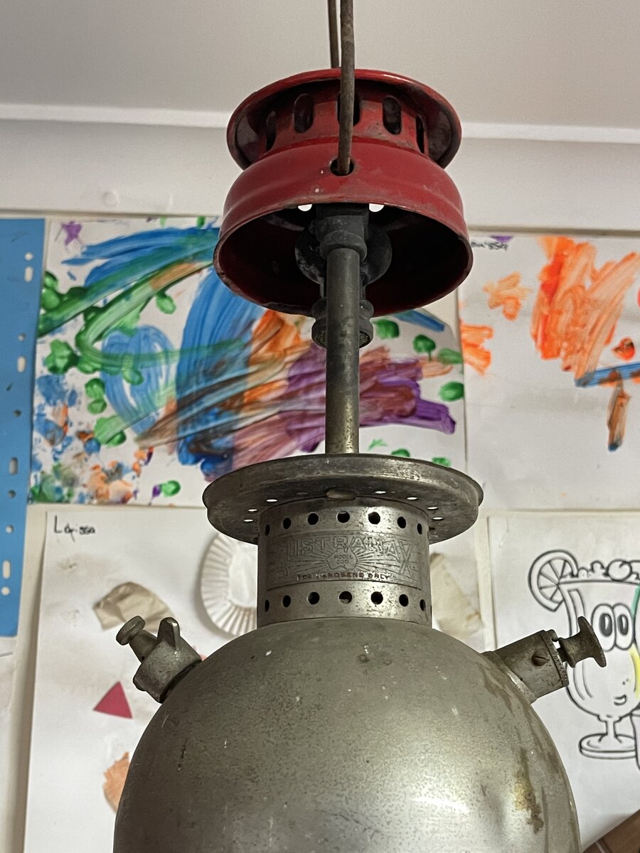

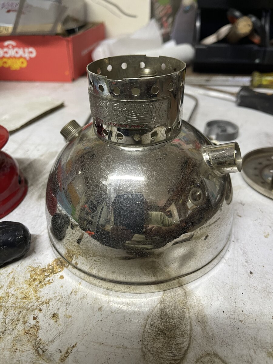

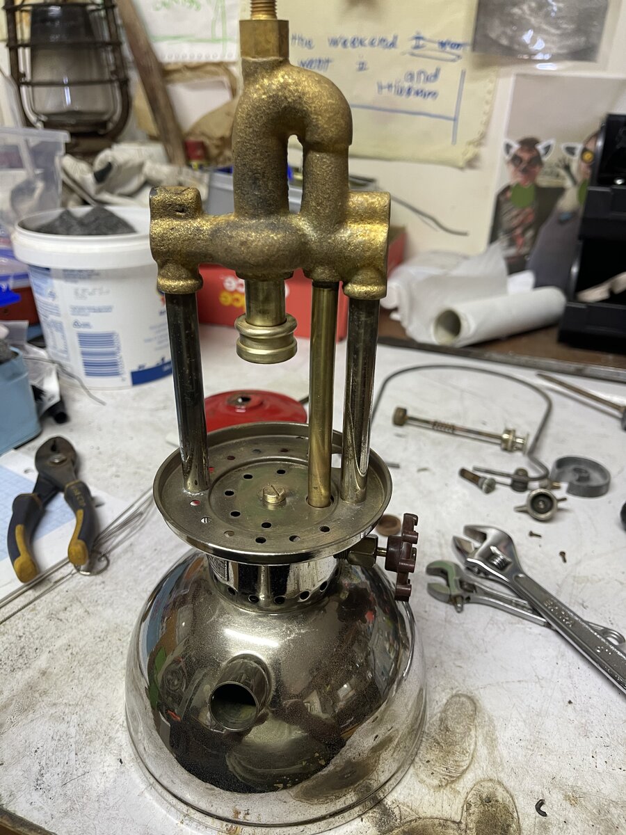

    Hi fellas this is my Austramax 200 I aquired a little while ago.
    It was in pretty good shape and condition.
    The only real issue was the oscillator the nib had broken or worn off. I replaced it with another from an old Austramax.
    It cleaned up well with soapy water and cotton cloth.
    As received picture

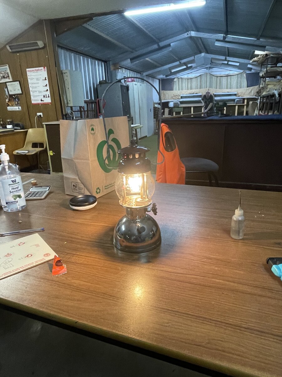

    restored condition, I used a red Austramax globe. I thought it looked smart.

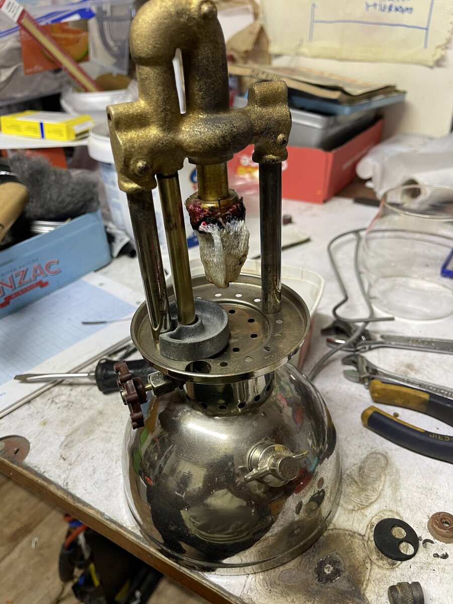

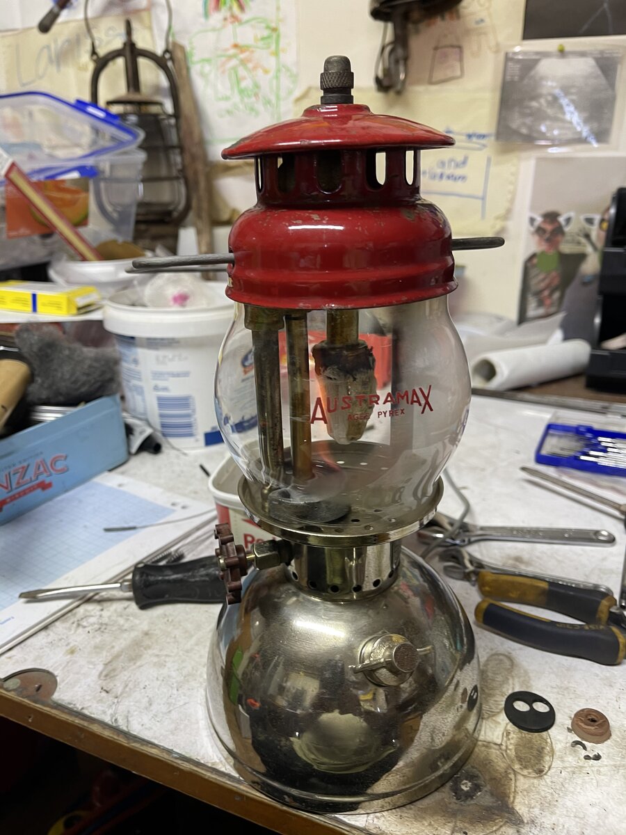

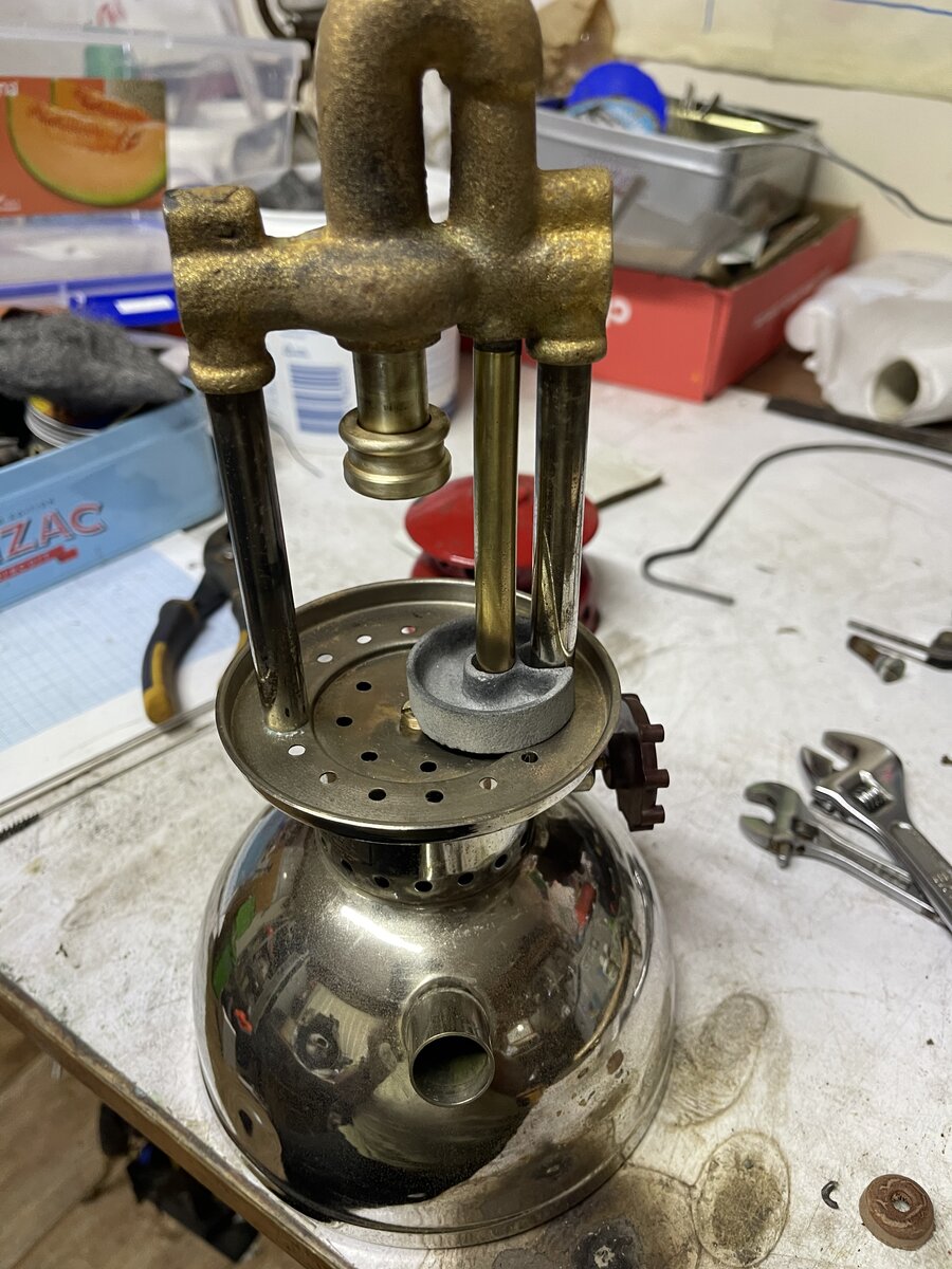

    I dismantled the lamp once I identified issues. Layer it all out, I has the original generator the pricker wire was intact, It was full of mud nests. Wash and blown out, BF7F6CBB-6D3C-407E-B25F-1A6826615666.jpeg 0D408AF4-F87F-4910-9C16-935AF86387B3.jpeg C538BAD7-9CDA-4730-A6C3-13BBC165B0A8.jpeg 6FF88B55-636D-4E76-83A5-8448CE01FCA1.jpeg BF32EE53-57CE-4032-BBF5-7C8E659FD3DF.jpeg EC961C27-C808-49A9-B894-46A0FD8478A7.jpeg E22B4B9A-4E94-4CA2-8370-2D4CFBEF5B08.jpeg 9F3BFEBE-9E85-4C25-999E-69ED5E4BC67B.jpeg 80519EA3-3184-4F79-8ECC-57E764358DA4.jpeg 2E9F2357-3316-4EB8-BF02-E1649F3684A5.jpeg

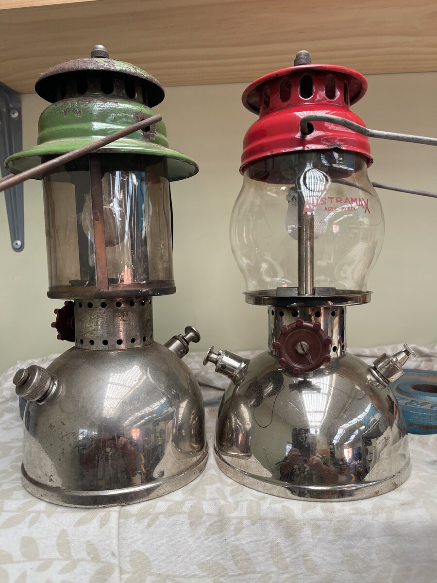

    Great find, @Darryl Durdin!
    The few Austramax 200s that have shown up give a good picture of early evolution of the Austramax line.
    Can you confirm that the tank on yours is slightly squatter than the later 2/300 tanks? Also, could you please post a photo of the filler cap side on?
    I think we can clearly say now:
    1. The Austramax 200 was this first Austramax. It had the small-rimmed vent, and the squatter tank (compared to the 2/300). Some other components were variable (filler cap; glass). Some of these may turn up with the “Austramax 200” tag missing from the collar.
    [Why it was called “200” is a mystery as the burner is essentially a copy of the Coleman 249].
    2. As far as we know at this time, there was no Austramax 1/300. Production went straight to the Austramax 2/300, then to the 3/300, both of which had a number of variations.

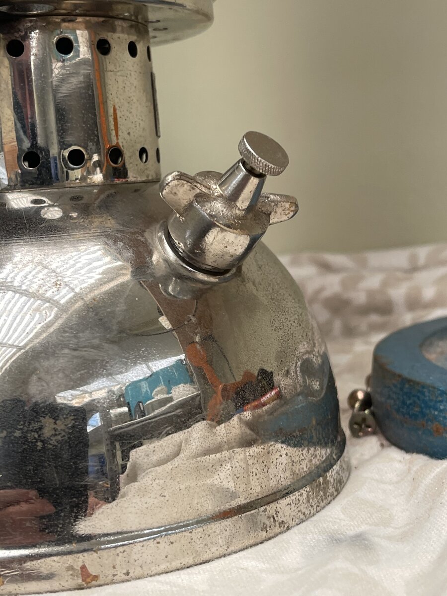

  4. Darryl Durdin
    1,652

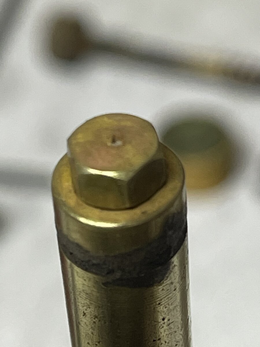

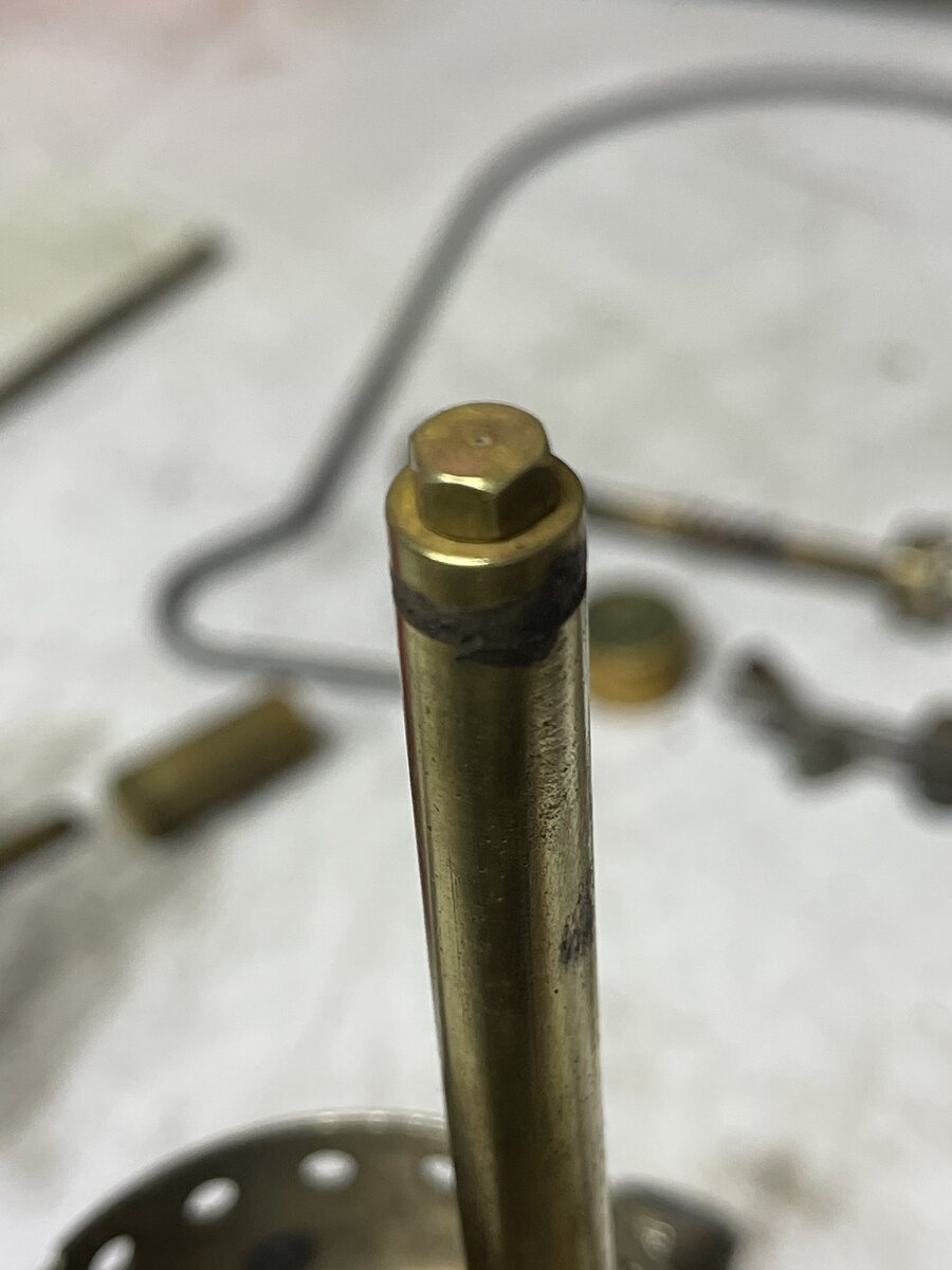

    @Tony Press , hi Tony, the 200 is more squat than an original 2/300, mine has a Tbar filler cap, it has the alloy meths bowl not the pressed one. It has the original vaporiser, jet and pricker needle and rod. DEDE49D5-7520-4040-9EC2-1506C5BFAC62.jpeg 3463A856-225A-440E-A2FA-F79E7AB31D7C.jpeg

    As Tony mentions, it does tend to confirm the assumption that the 200 is the model name of the first Austramax (the one we assumed was the 1/300).
    With the condition of this lamp, I would expect all parts to be original. That means that the filler cap should be original and a new one to me (on an Austramax). It does look familiar though but I can't place it. I wonder if there was an Australian stove manufacturer with something similar in the 1940s.
