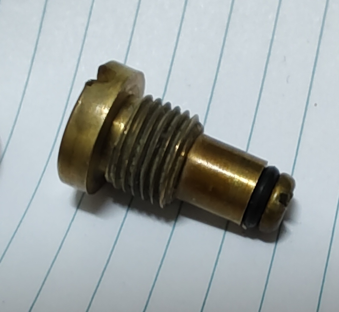

    Team, am just finishing rebuild of a nice 3/300 and found that its check valve no longer works. I have used an old style that I rebuilt with a new pip.
    Looks to be an ingenious design. Can anyone advise what size is that o-ring and what material it's made from? I presume all that is needed to rebuild is a new o-ring (and a new lead washer?)
    Cheers all, John

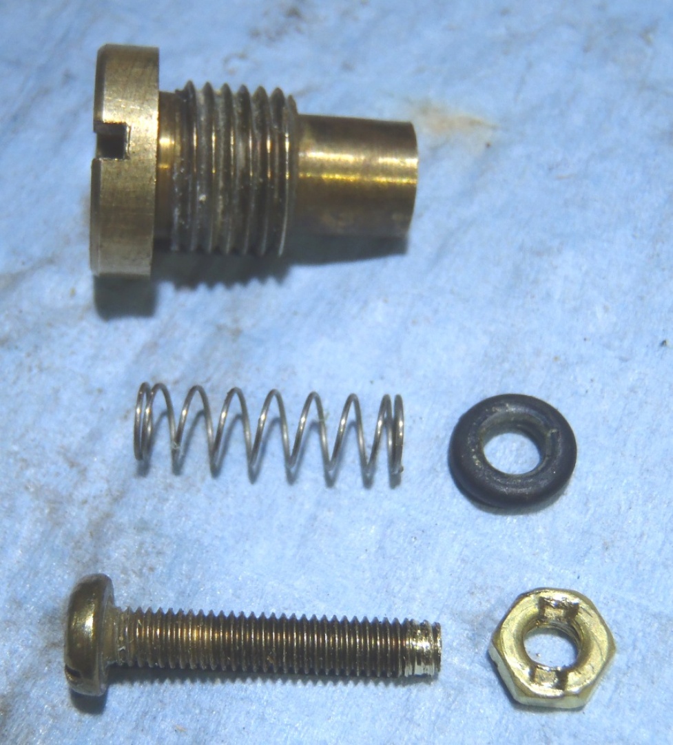

    Note the nut on the screw is swaged on after the NRV was assembled. It would be better to replace the seal by prying the old one off rather than disassembling the NRV (like I did)
    The O ring I used was Viton but I can't find what size. Measure the dia of the screw will give you a good guide.
