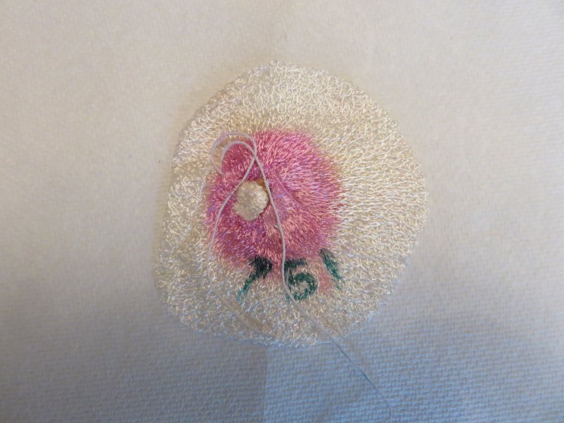

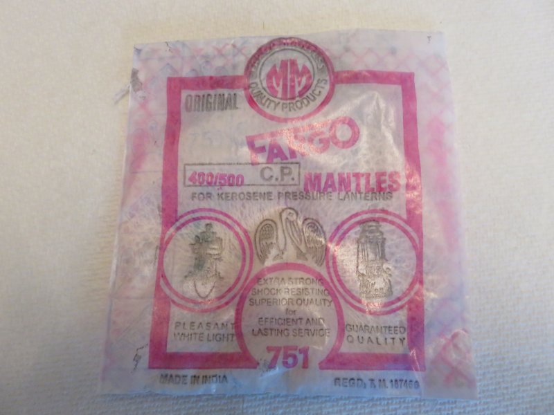

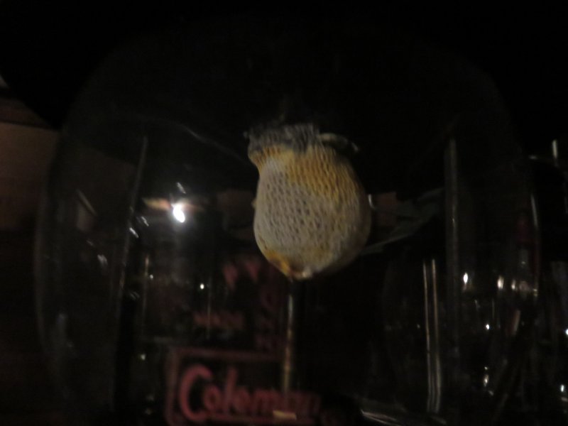

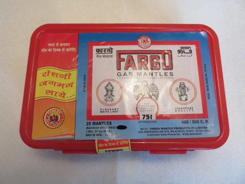

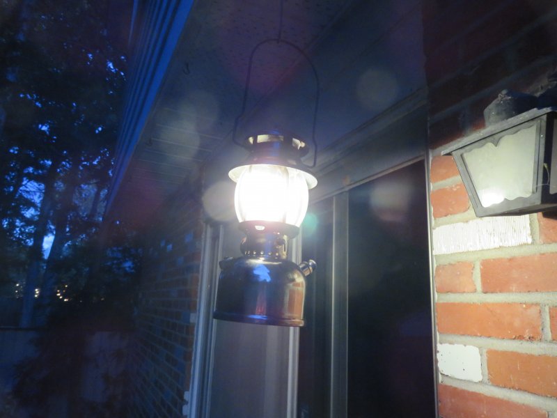

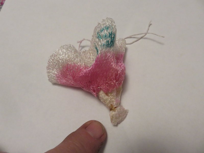

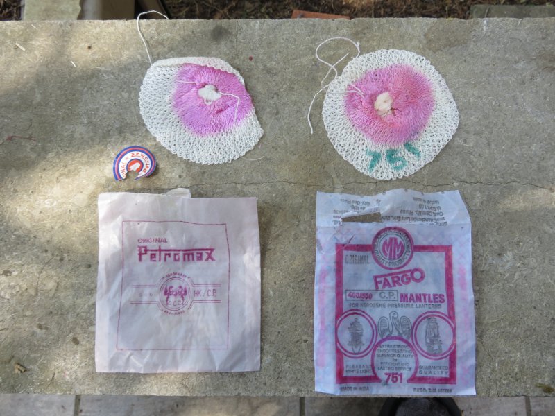

    I have purchased on Ebay a good quantity of Fargo brand mantles from India. They resemble in both manufacture and packaging the petromax mantles we are familiar with. I was satisfied with the first trial on a Coleman 200 lantern. Although advertised as 400-500 CP there was significant over flame in a larger 500CP lantern. The mantle takes the form of a small bulb when it is burned in. IMG_4299__1620059192_79231.jpg IMG_4300__1620059273_54597.jpg IMG_4301__1620059352_65437.jpg IMG_4316__1621040196_99964.jpg IMG_4323__1621042262_90524.jpg IMG_4322__1621040337_58309.jpg

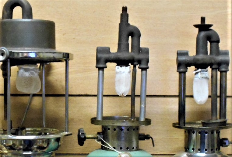

  7. Henry Plews
    3,051

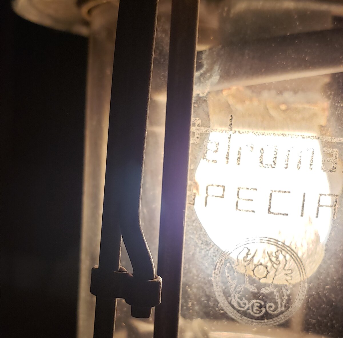

    If they work well on a Coleman 200, they'll work fine on your Austramax.
    Don't be put off by the 400/500 candlepower rating. Fargo mantles really do shrink when burned off.
    Left to right, Fargo 400/500 on a 350cp Petromax clone, Coleman 21A on a Coleman 242B, Coleman 21A on an Austramax.
