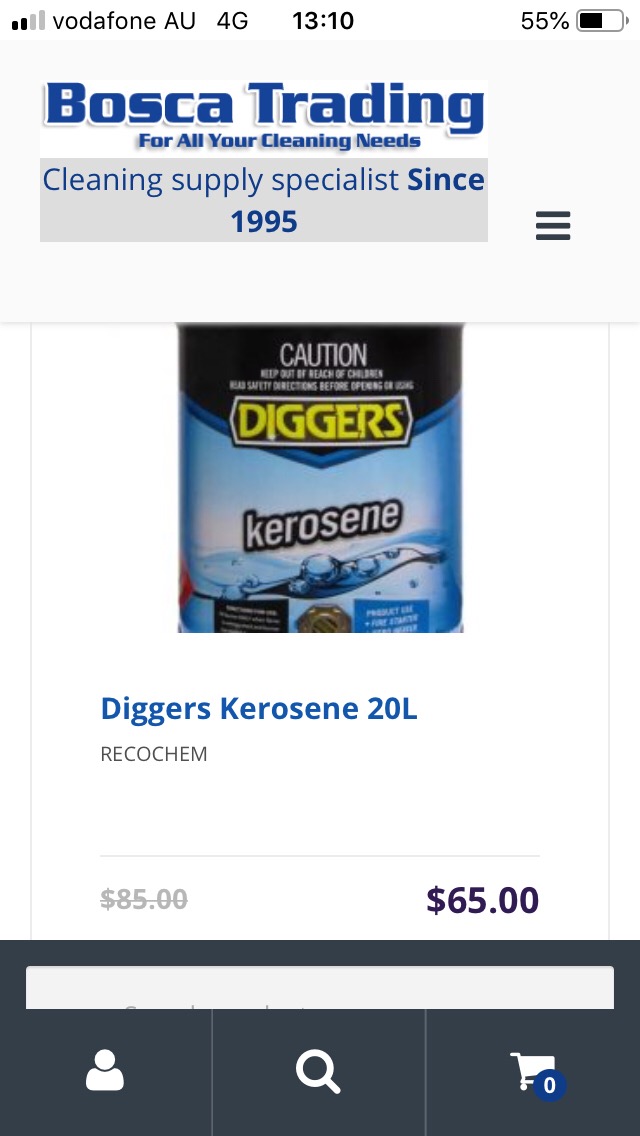

    Not sure if this is cheep but a place near me is selling 20L diggers kerosene drums for $65.00 down from $85.00.

    Diggers White is the same as Diggers Blue but without the blue dye.
    20 litres of kero at $65 is about as cheap as you’ll find it, unless you can get it at a pump.
