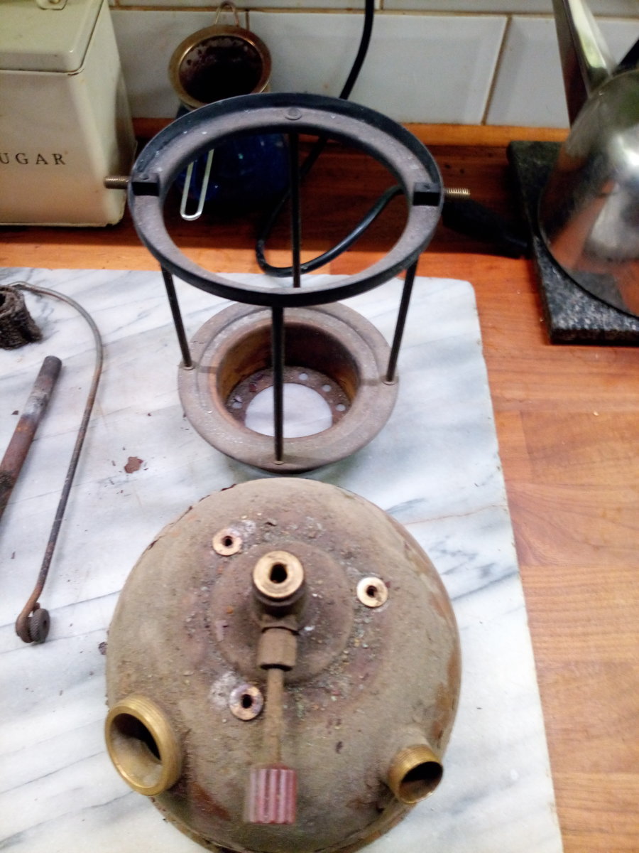

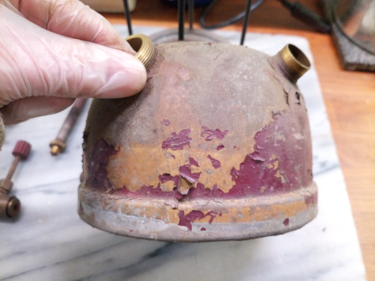

    This is how it came to me.

    I thought I'd document the fettling process I go through in case anyone's interested. I want to make it clear that this is only what I do. I'm not suggesting these are the best methods or the only methods but they've worked for me.
    Disassembly:

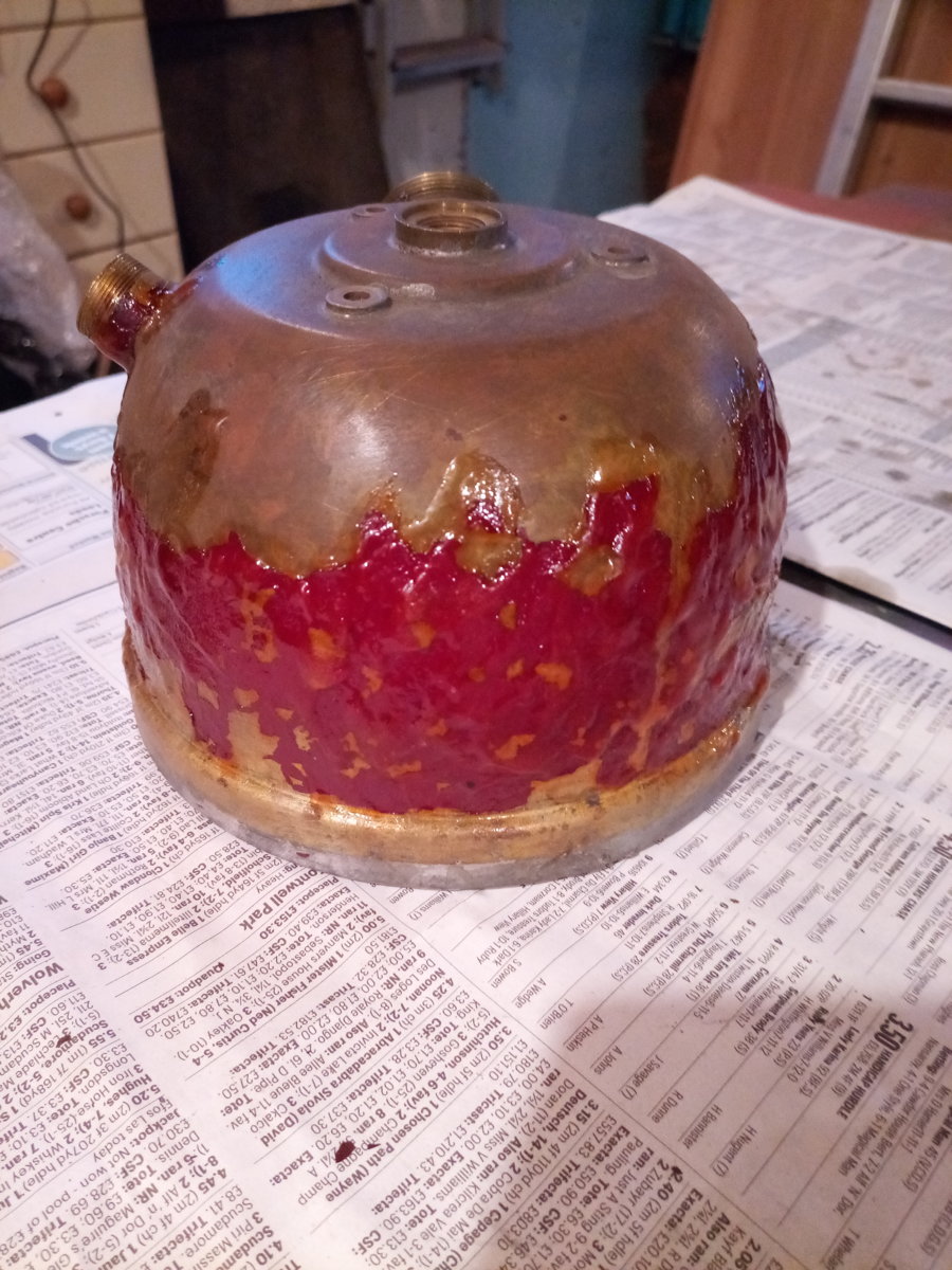

    The fount was peeling badly over most of the surface but I will leave the base as I found it as a colour reference for anyone who owns it after me.
    Preparation:

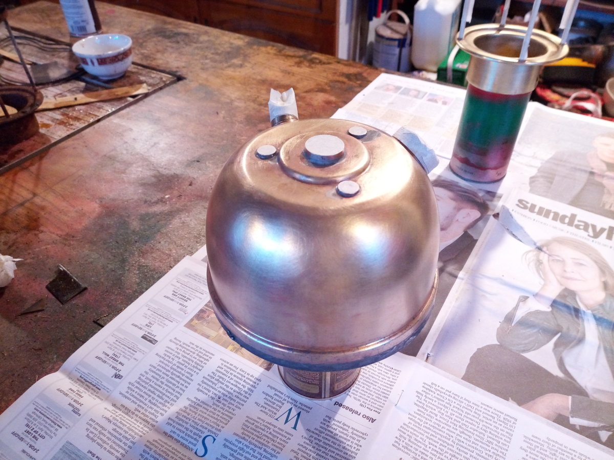

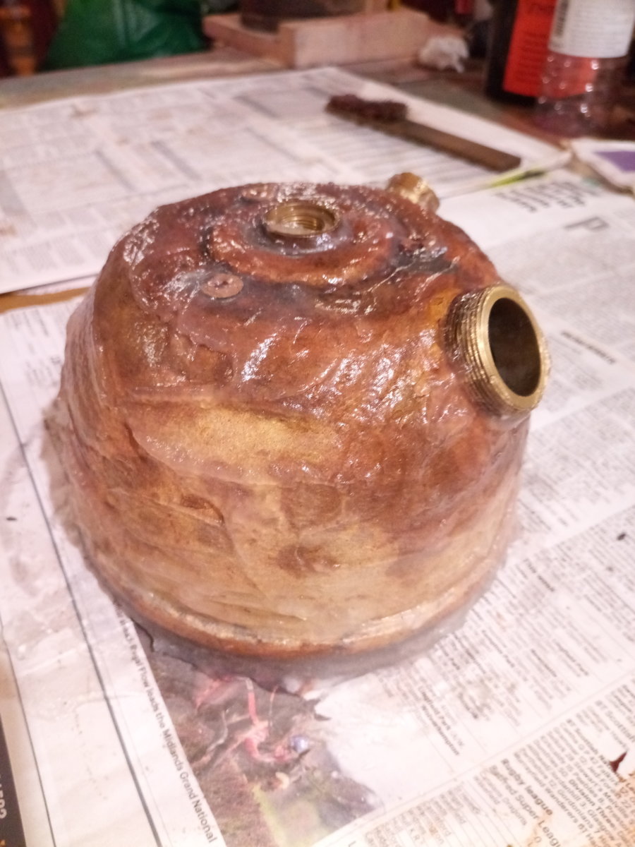

    The remaining paint was removed with a new paint stripper I've been meaning to use for a while now.
    While it was working it's magic I polished the filler cap, pump parts and control valve on my buffing wheel. Honestly, it's so quick to do. The knurled parts were brushed with a fine brass wire brush meant to clean suede.
    This was the paint stripper. Despite the dire warnings it didn't seem that bad but it was extremely fast acting! An hour after application the paint fell away easily.

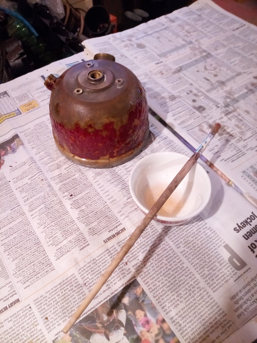

    The fount was now free of paint but still tarnished so it was time for some miracle GSR (George's Stove Restorer) For the recipe you'll have dig around on the CCS sister site but it's basically wallpaper paste and citric acid powder. GSR gently removes the oxide layer and bloody good stuff it is too!
    I mix mine up quite thick so it really adheres to the surface.
    Like this...

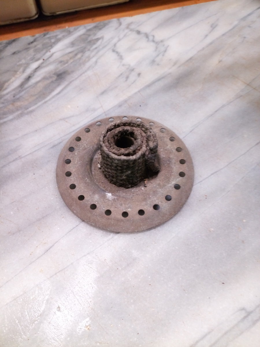

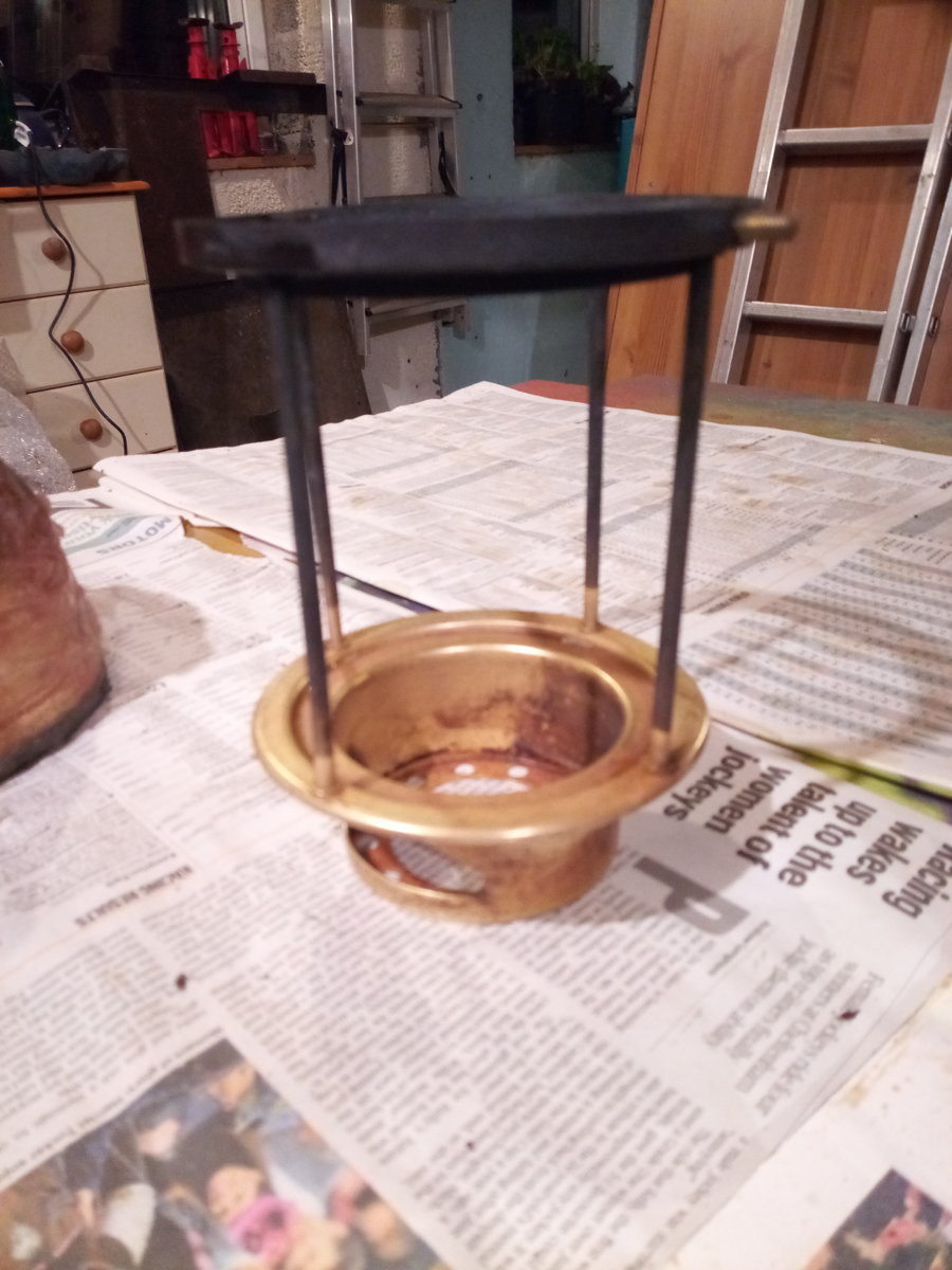

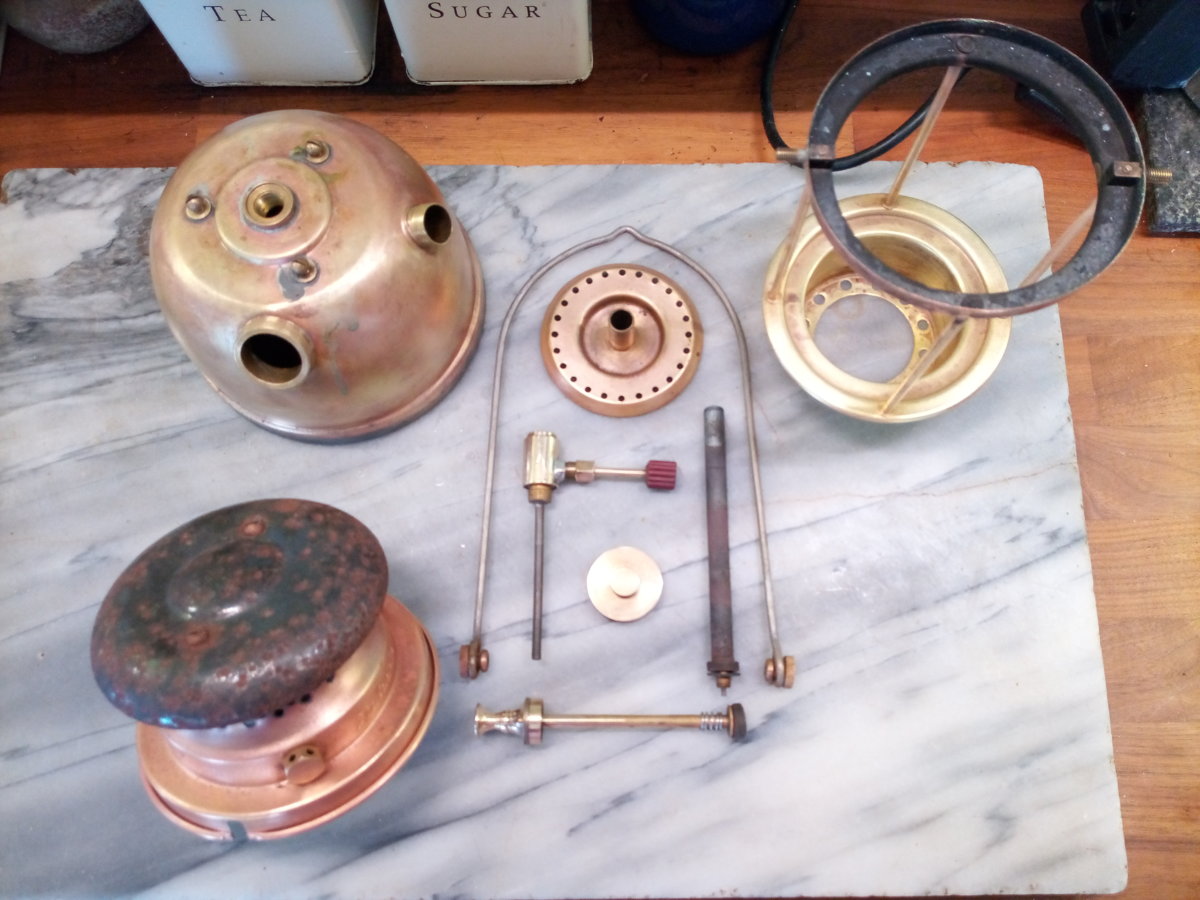

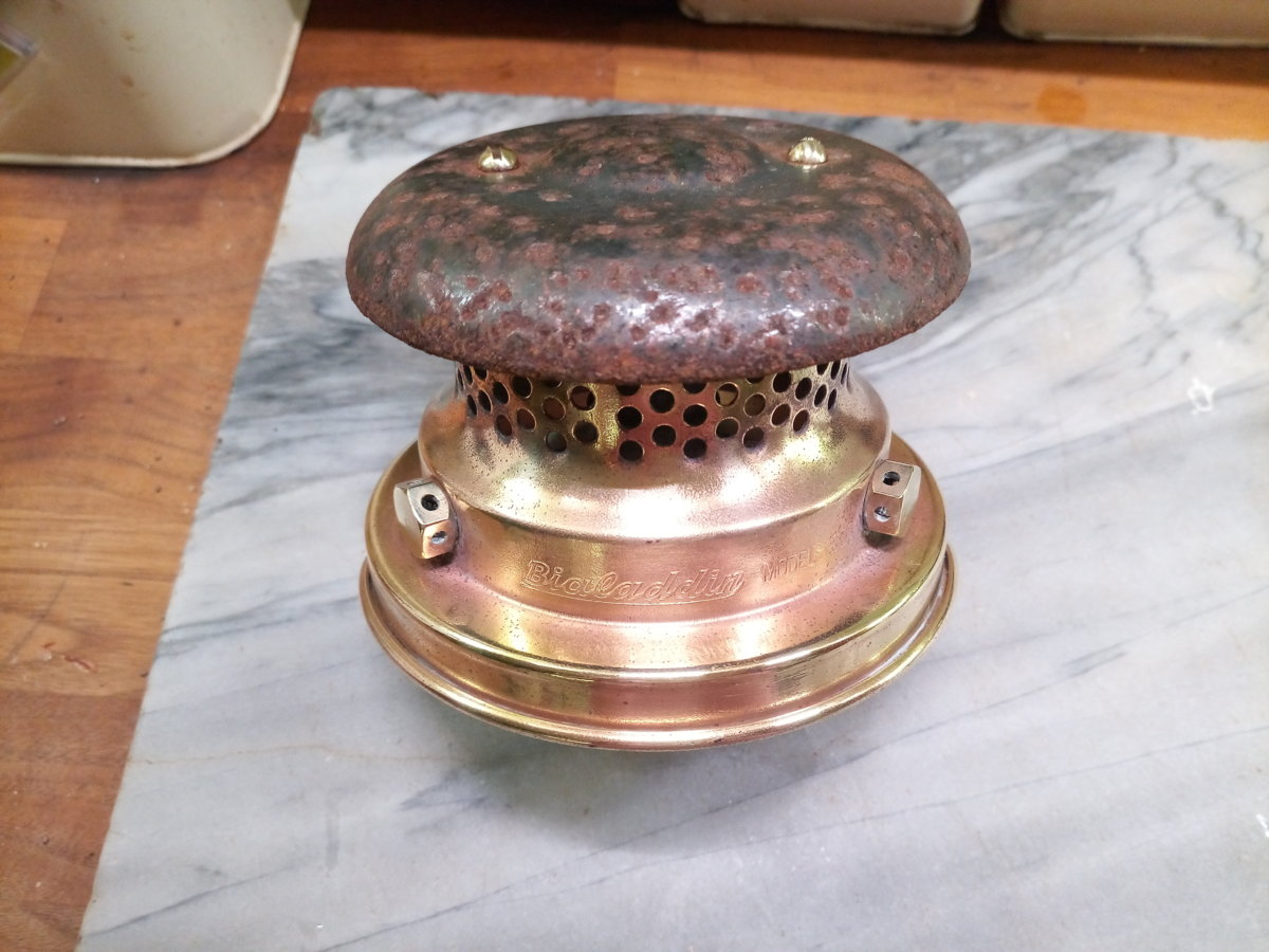

    The collar and frame had virtually no paint left so it was dunked in vinegar first for an hour. You can see the line on the rods where they weren't covered by the vinegar. The old enamel cap was removed and the burner, pre-heater tray plus the brass hood were dunked in the vinegar bath. From experience this might take longer to clean up, although I never try to get it back to pristine metal.
    This was then covered in GSR and will be checked before I turn in for the night.

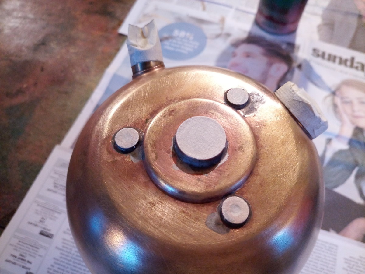

    Got a bit further this morning...
    The fount and frame are ready for spraying once I've gone over them with acetone and fine wire wool. The discolouration of the metal I'll leave as I don't want to strip away too much metal.
    The air buttons are stuck fast and although I could force the issue it's likely I'd end up unscrewing the air tubes so I've decided to clean the hood and burner in one go... not something I usually do.
    The vaporiser was clogged but after several heat quench cycles I can feel the pricker protruding from the jet so that seems positive.
    Next stage, painting!

    By the way, I know the hood has that coppery tint because of the vinegar but it'll be polished out soon with Mother's Mag. Good stuff that!

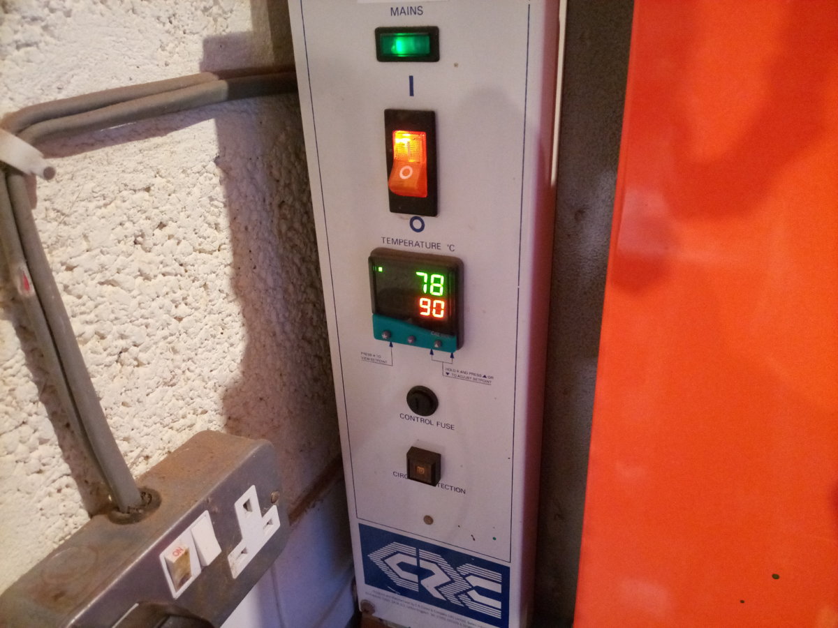

    I just checked and it's looking pretty good but it's not ready yet. Another couple of hours should do it, then I'll turn the oven off, let it cool down naturally overnight and hopefully re-assemble it in the morning.

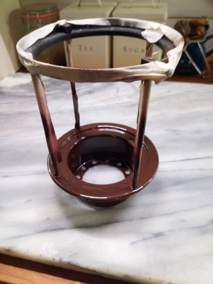

    4,816

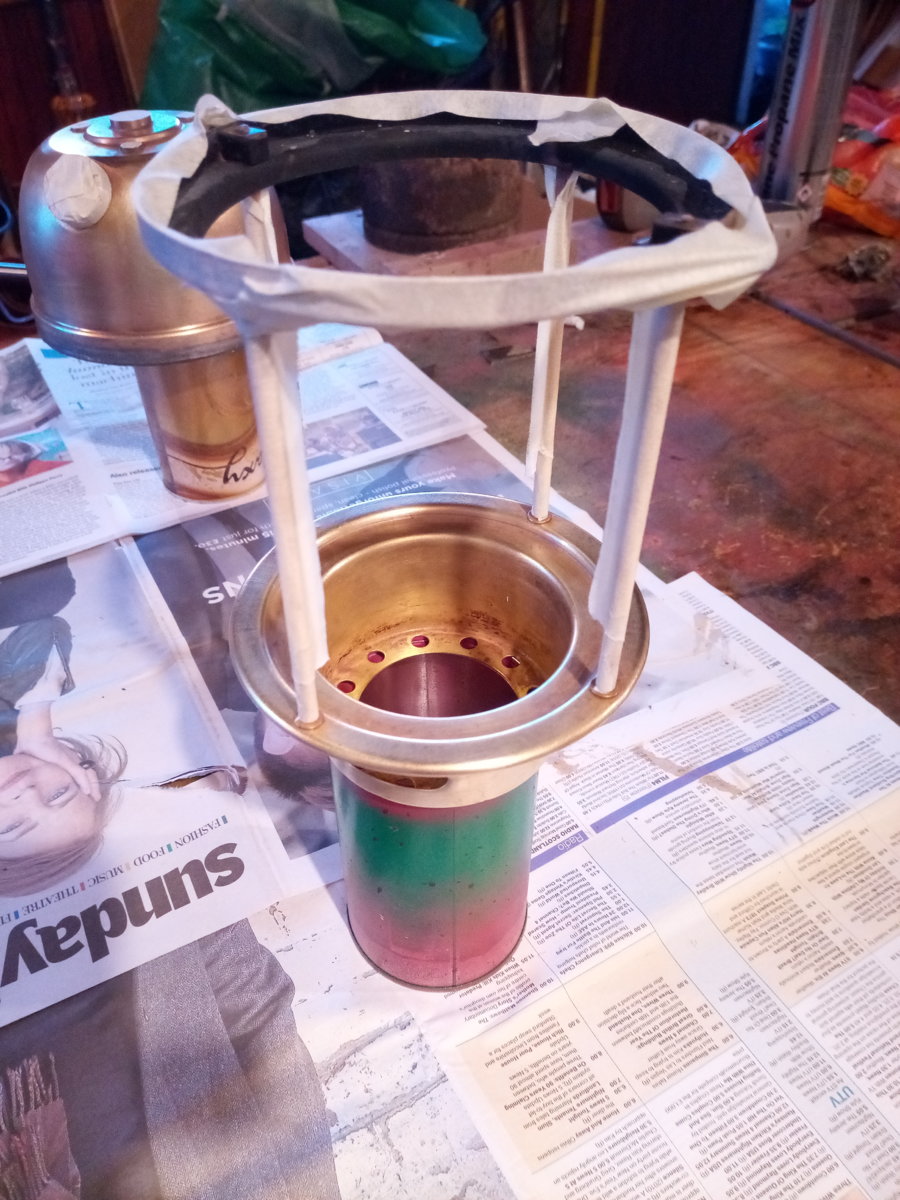

    Preparing for spraying.
    The fount and frame had three coats over an hour.
    In the oven for 4 hours to fully cure..

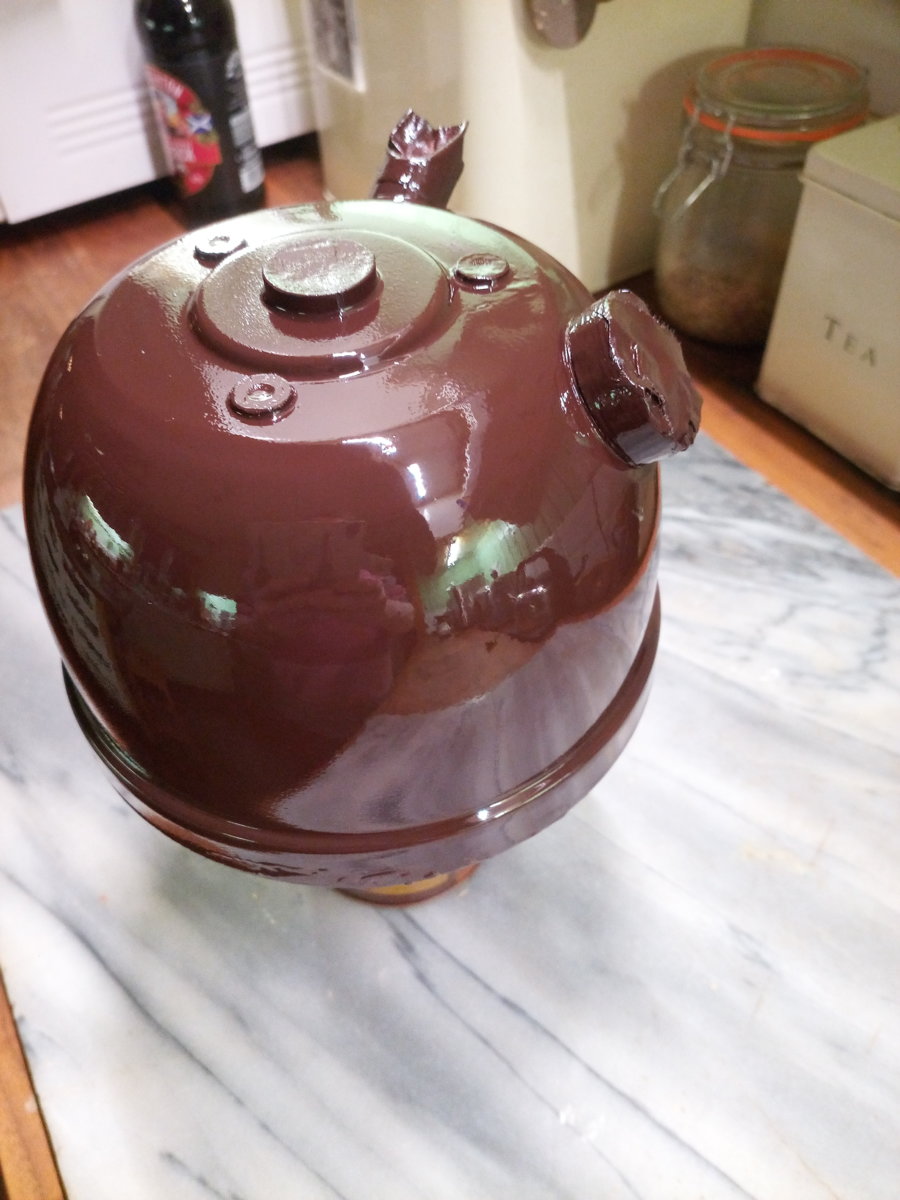

  23. ColinG United Kingdom
    4,816

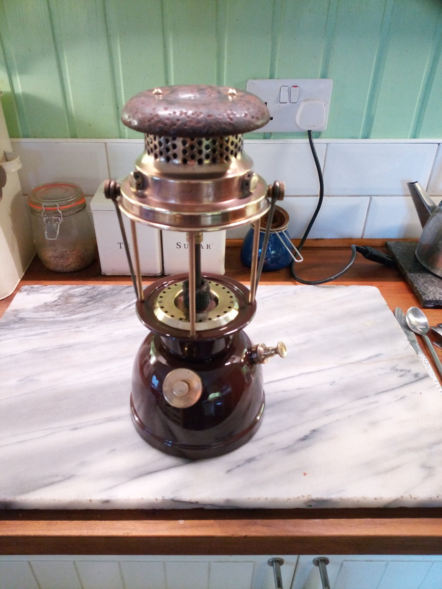

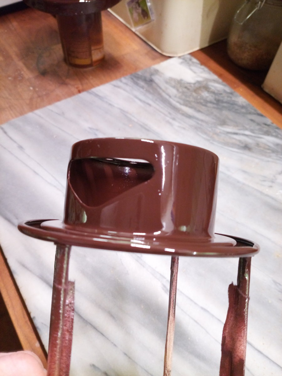

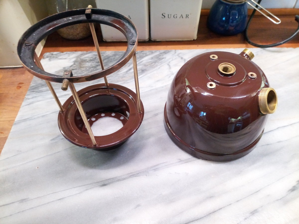

    Right then, after leaving the fount and frame to fully cool and harden overnight, here is the result...

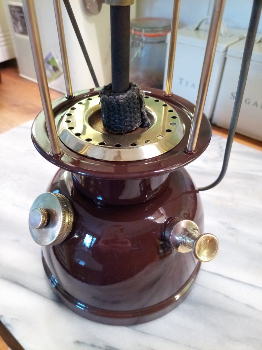

    And assembled...

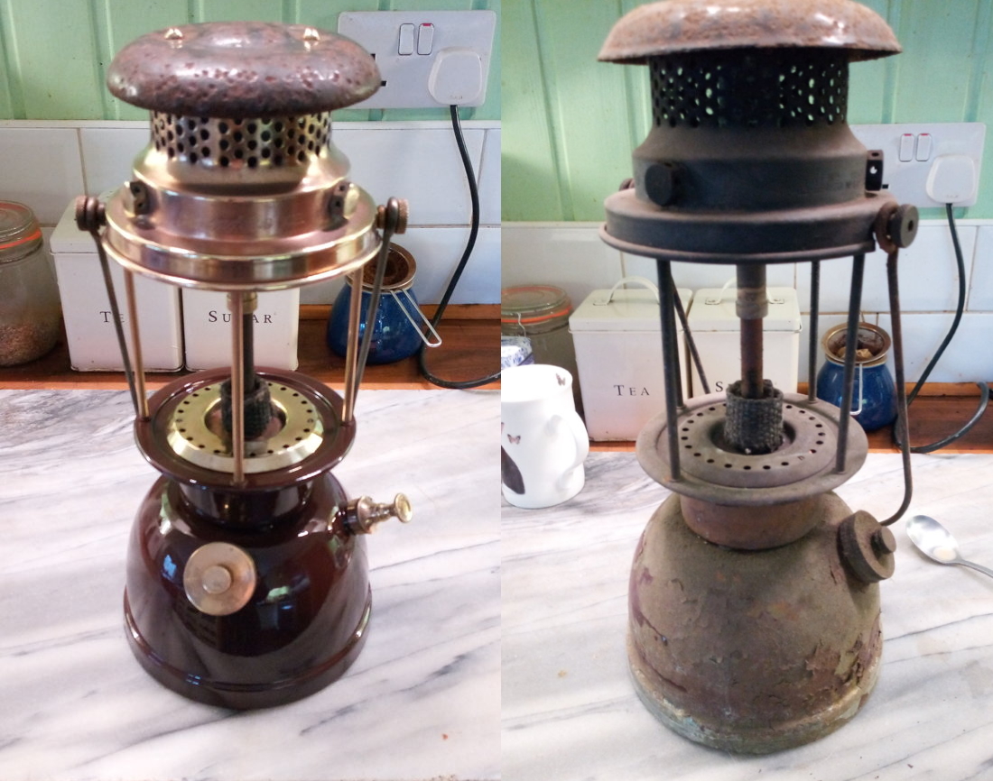

    As a colour comparison here it is with the other Bialaddin 300. I like the colour a lot, it has a vintage feel to it.
    The money shot will follow shortly.

  25. ColinG United Kingdom
    4,816
    Before and after pic.... well, actually it's an after and before pic!

  28. ColinG United Kingdom
    4,816
    The chestnut colour is just red enough to be a close match to the original.
