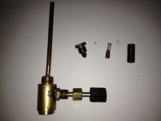

    I am restoring a Bialaddin 300x here in Australia. I have not had any experience with these lamps. I am looking for some assistance please. The control cock seems to require a new o ring. How does the bakelite knob come off the spline to get to the nut?
  2. Shed-Man R.I.P.
    1,032
    Hi Tony, If there is no apparant screw to take out, it is a threaded fit onto the shaft. You will need to grip the shaft with some protection in the jaes of the pliers, same with jaws that grip the knob. Don't squeeze too hard. A bit of penetrating oil will help. It is a right-hand thread. Good luck - Steve.
    Good luck with the Bialaddin, Tony
  4. Tonebone
    Apr 17, 2012
    123

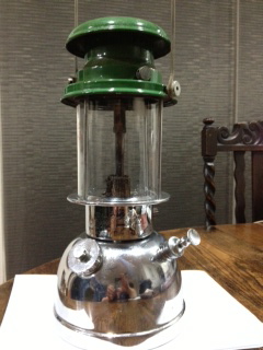

    Please find attached a photo of the Bialaddin 300x. I need the full service kit including the pip for the NRV. Is there a kit part number for this complete kit ?
    Thanks Steve, I have managed to remove the control knob. Is there anything else I need to know to service this lamp. Will it take a Tilley style mantle?
  5. Lamp Doctor Australia
    Jan 3, 2013
    622
    Geelong
    Nice looking lantern Tony.
    Yes Tilley mantle will fit/
    Sands have the spare parts etc .
    Bob .

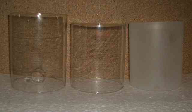

  14. David Shouksmith
    There are, basically, only two types of Vapalux / Bialaddin glass. There's the large plain cylinder (60) and the shaped glass (805). These will probably have a letter in front of them, either V for Vapalux or T for Bialaddin but don't take too much notice of that because there's some overlap.
    The large, plain cylinder glass is 95mm diameter and 112mm tall. A variation of that is the early glass with the lighting hole in the side. That one is 97mm in diameter and 124mm tall.
    The shaped glass is 100mm tall and 97mm across at the top with a 48mm hole in the bottom. There are two main types here - the round-shouldered version for the 310 and the T10 and T20 table lamps and the angled-shoulder type for the 315 onwards. A variation of this type used on the NATO 320s was the same overall size but had a small plain glass cylinder and a shaped steel disc at the bottom.
    There's also the donut glass which, from memory had an outward curved lip at the top. I've no idea of the sizes but I don't think we really need to concern ourselves too much with that one!
    Check out the Base-Camp website for the two main types - 60 and 805 - for what they fit. I see there are now some frosted versions to be had which aren't original but are probably useful. I think I have one around here, somewhere.
    Hope that helps...

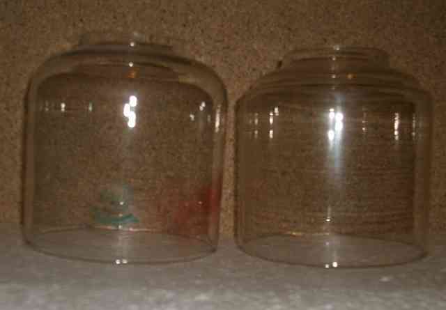

  15. David Shouksmith
    Ran out of time to edit these into my previous post - what a pain... :rage:
    Large, plain cylinder types. Early globe with lighting hole, common-or-garden V605 type and frosted aftermarket version probably from Base-Camp.
    Shaped 805 types. Round-shouldered for Bialaddin 310 and T10 / T20 table lamps. Angled-shouldered for Bialaddin 315 and 320 lanterns. Both shown inverted, of course. I didn't have the NATO variation to hand but the metal disc makes it unmistakeable.

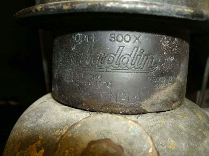

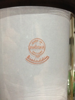

  16. Tonebone
    Apr 17, 2012
    123
    The one pictured contains the following logo:
    "Made in Phoenix England for Bialaddin"

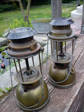

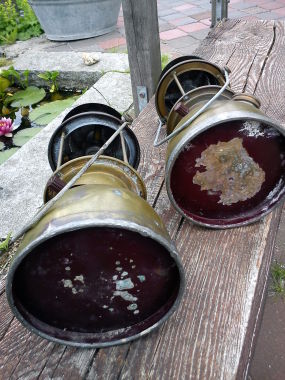

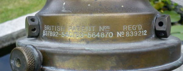

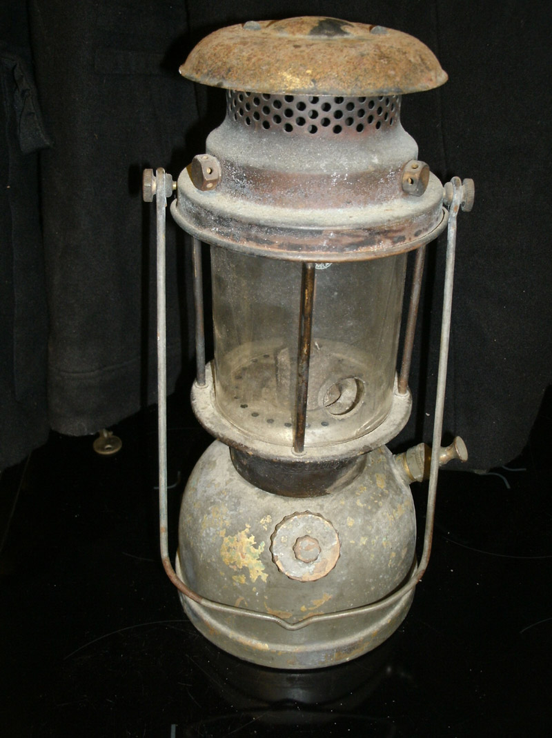

    Dec 18, 2012
    1,787
    Hi David
    The hood looks origin to me but it might be a frankenvapalux 8) The original pait is to be seen in the bottom where the polish-devil didnt go.
    Is this early lamps? (for early glass).
    They carry the same patentnumber but the hoods are not the same - why is that? sorry about all the questions but I dont know much about these and they dont show up so often in Danmark.
    Claus C

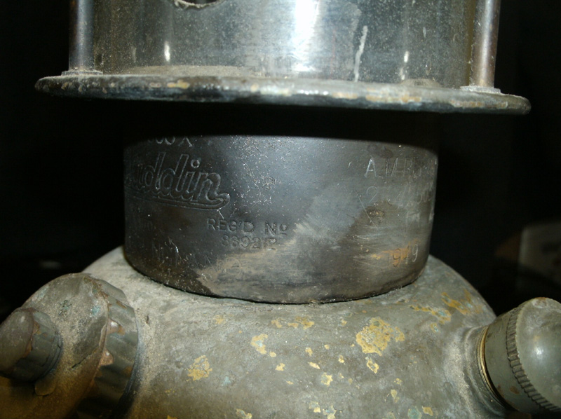

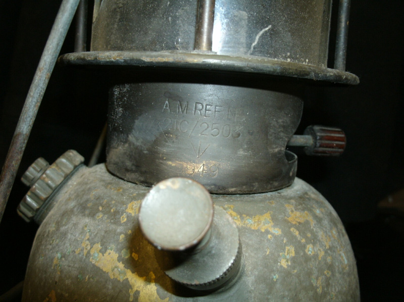

  21. Mark Jones
    Aug 17, 2017
    3
    I've just picked up a military 300x it has a lighting hole in the glass, markings on it say 949 and crows foot / broad arrow..I presume this means 1949
    Is the glass correct for its date.
  22. Henry Plews
    3,067
    @Mark Jones, Welcome.
    The glass is correct for the top your lamp but not necessarily the bottom, I'd have thought 300 (without the X) would be nearer the mark but I'm happy to be corrected. Although the basic appearance of Vapalux / BiAladdin lanterns changed over the years, the vast majority of parts are compatible / interchangeable, a picture would help.
    If you have another look at the images posted by @David Shouksmith above, you'll see that the glass with the hole in, is taller than the one without. It took Vapalux a while to realise that a shorter glass could be raised enough to get the spout of the meths tin (and a match) to the spirit cup and wick which obviated drilling a hole thus saving time and money in production costs.
    Henry.
