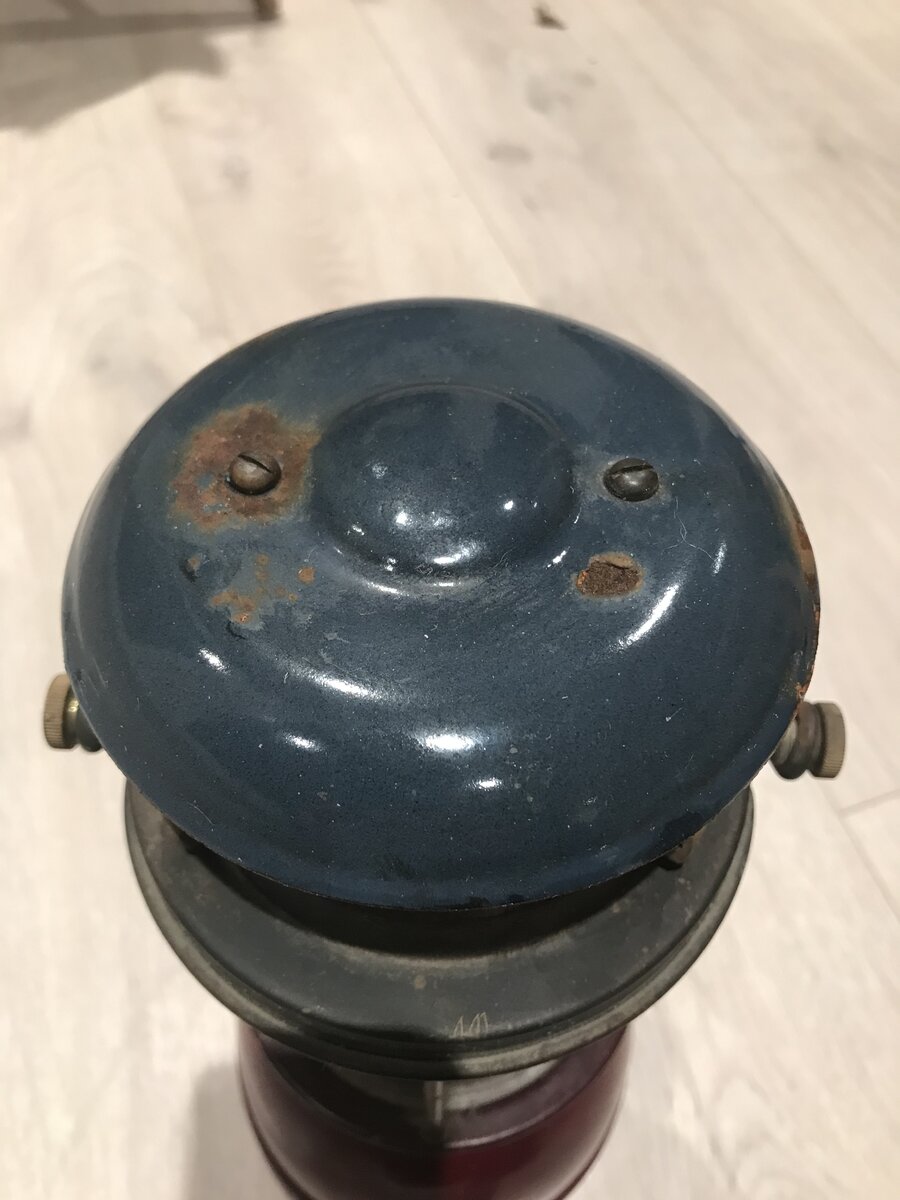

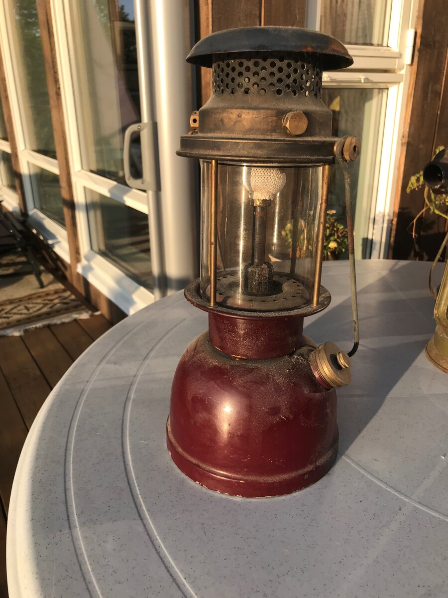

    I have found this Bialaddin model 300X, which is in pretty good shape.
    On the picture, I have not cleaned it yet.
    I wonder about the date of this lamp. It is very similar to the "red-top" lamp posted here by george.
    But mine has a top where the enamel is blue (with a hint of purple). Any idea of the date of this one?

    What you have there is a very, very nice example of an early Bialaddin 300X in seemingly excellent original condition. Year of manufacture - 1947 is a safe bet.
    Until late 1949 these ventilators or chimneys are made of brass, with a steel enameled top which is attached with two screws. Till then, the three air buttons in the ventilator are of the hexagonal shape. Initially the colour of these steel tops was black, then red. Also, initially the preheater dish was in plain brass, then it got plated with the shiny speculum. The very first Bialaddins had the name and maker mentioned on the brass ventilator, with a plain collar, in the same style of the previous Vapalux 300X from 1946. Then the information on the lamp was transitioned down to the collar, with a plain ventilator as in your lamp, perhaps already in 1946 or early 1947.
    Perhaps later that year, but in 1948 anyway, the fittings in brass (fuel cap and pump) were sprayed over in the same colour as the tank as a cost-cutting exercise. Probably the same time the red top appeared, that only blends in colour with the maroon of the tank when the top gets hot. Another expense-cutting measure was to provide these lamps with an alloy fuel cap, that seems short-lived however.
    Initially the glass has a red logo, with Bialaddin curved underneath the Pyrex roundel.
    Soon this was changed with the name curved above it, with the green versions the most common as these appeared on the lamps with the green spot welded tops. Unfortunately these later lamps have the same 300X typing, while in appearance they are quite different from your lamp, which in my eyes is the best classic looking Bialaddin lamp produced.
    Oh, and welcome to this site! If you read up on these very lamps, and have a look in the Gallery, you will find that Willis & Bates, a small firm, did not shy away from using parts whenever they were available. Hence a great variety on details that make exact dating an educated guess. Regards, Mike

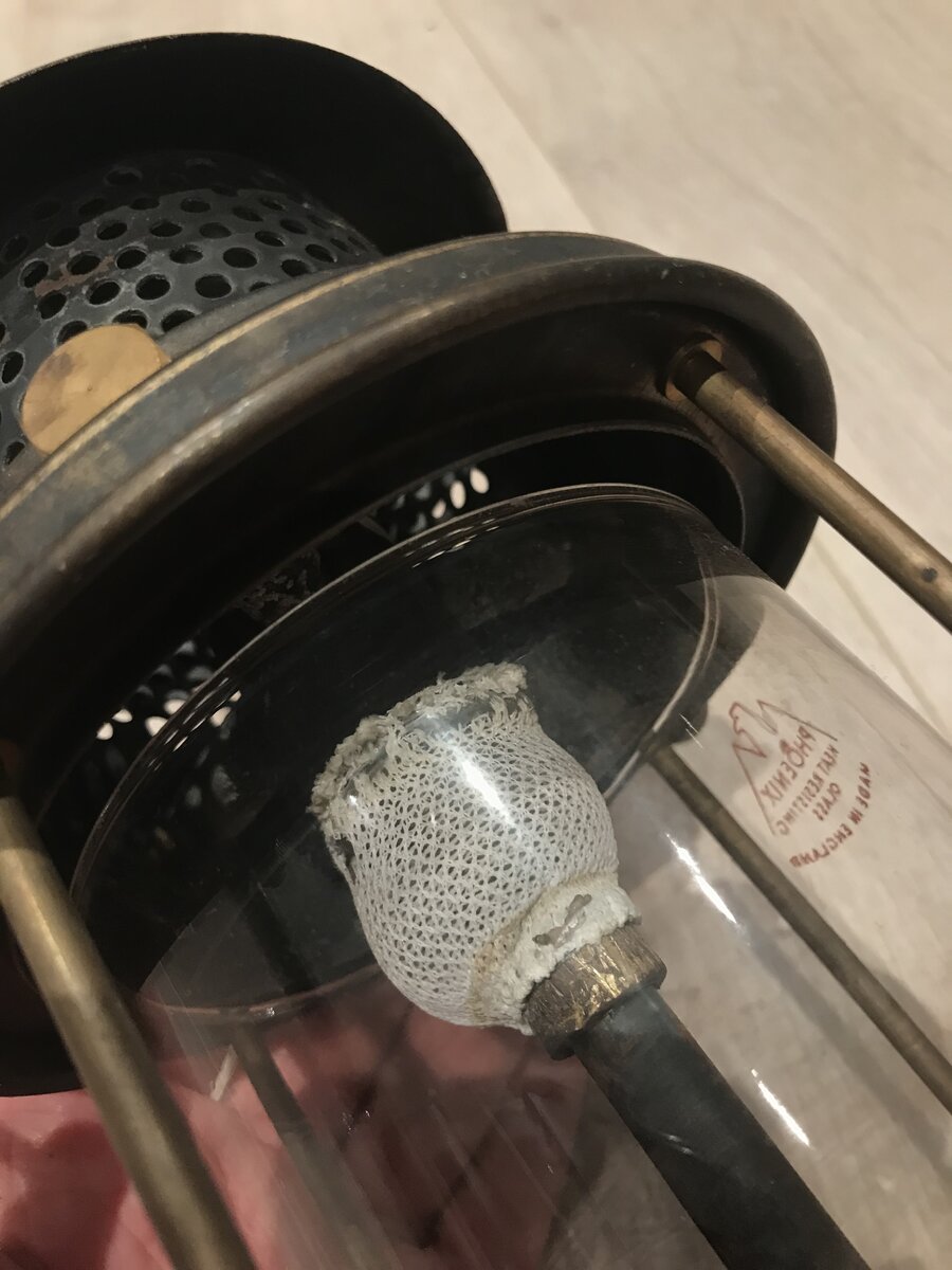

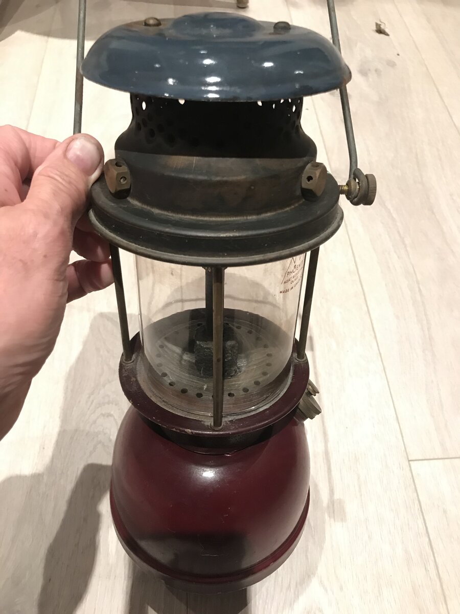

    As you can see, the glass is Phöenix. And the top is clearly blue, find it unlikely that it was once red?

    Håvard, the top of your lamp is supposed to be black (early version); only later these tops were red enamel.
    That yours has a different hue towards blue could be the result of poor quality control, or, likely, a wide margin in which products were acceptable. Then again, you might have an odd colour purposely made as a try-out; with W&B much is possible!
    The glass on your lamp is not often seen, in fact rather rare.
    I believe Phoenix made different glass for different makes, a british general supplier.

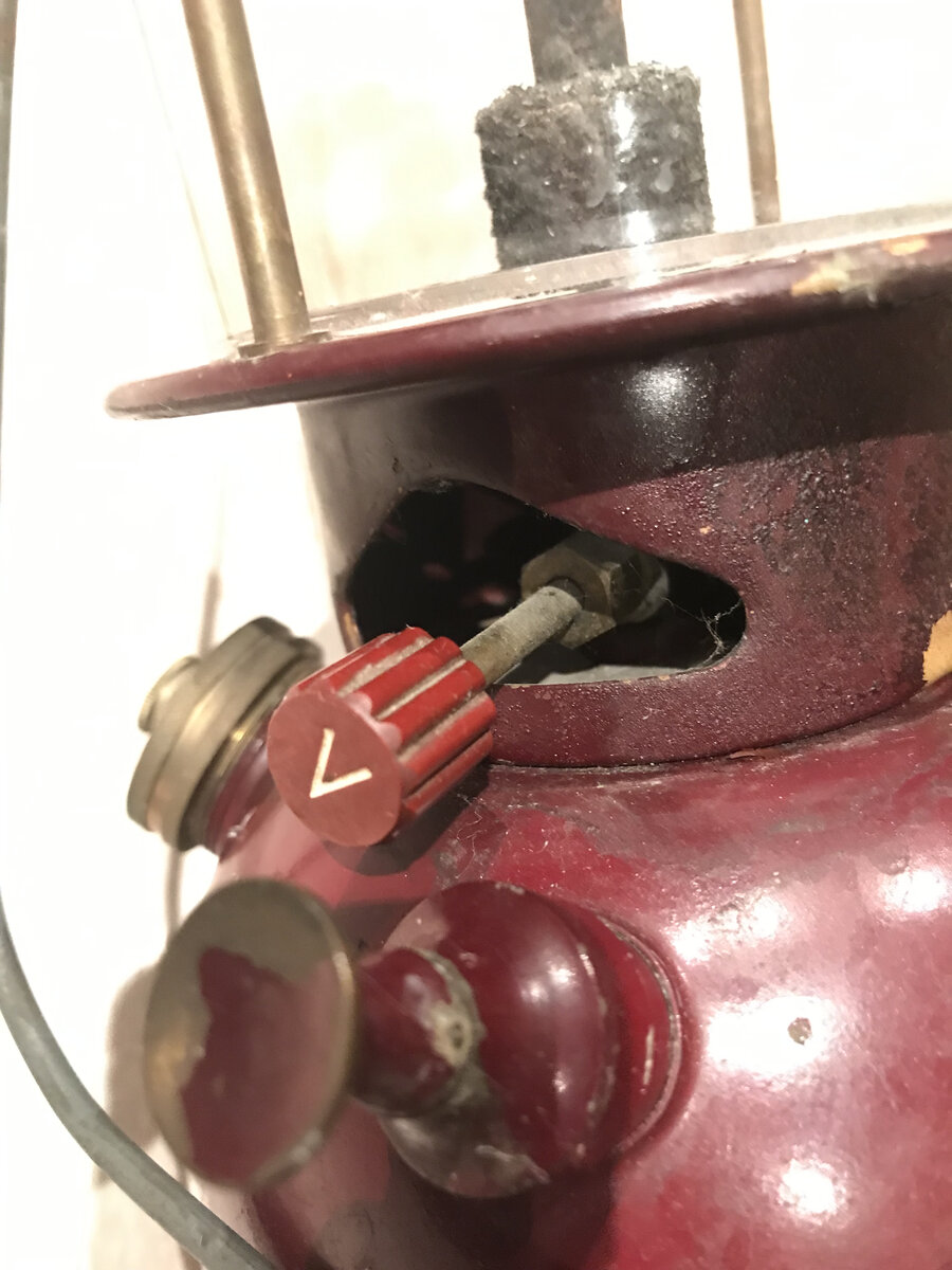

    Your lamp shows a brass primer dish, and a painted pump. a mix of period parts as already indicated, and nothing really to come to conclusions.
    We should keep in mind how easy it is to exchange parts on these lamps, that basicly stayed much the same even within the later model range: you could replace that outer pump with the last Vapalux 320 model of the 90's for instance.

    @M.Meijer @Håvard Kvernelv it may the angle of the pics, and or my eyesight. But to me the glass looks too short, as there is a clear gap between the top of the glass and the frame…?
    The blueish colour of the enamel top, in my opinion is just a pigmentation issue when it was enamelled, reason I say this is that you do see quite a few black reflectors that appear blueish, not quite as blue as that though.
    Either ways it’s a very nice lamp and you should have problem getting it working, they are extremely robust and reliable.
  11. M.Meijer
    608
    Netherlands
    Yes, it is shorter, but this is not critical on top, beyond the point of combustion anyway.
    More critical is how the glass is preventing the unwanted entry of air down below, for priming purposes. Hence the diameter is of more importance than the height, and a nice fitting glass within the circumference of the cage is better looking. What measuring I have done on these cylindrical glasses through the years, I have found heights fluctuating up to one centimeter or 10mm in difference.
