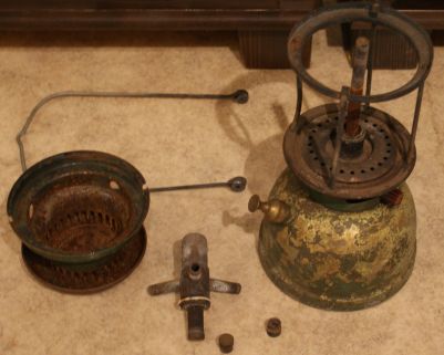

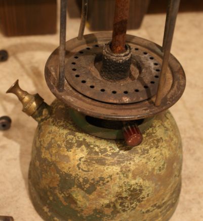

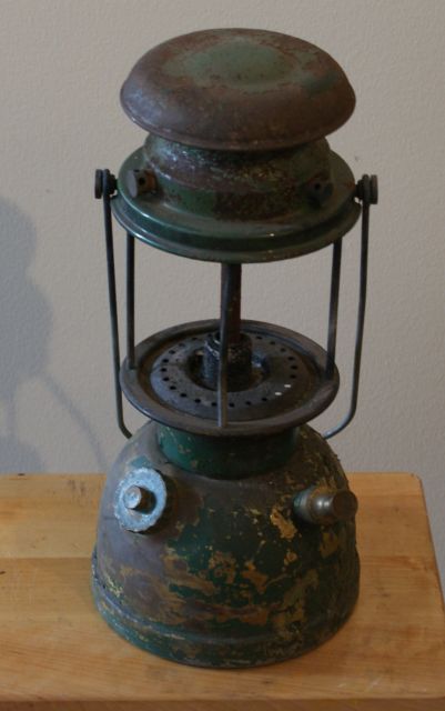

    New fettling project Bialaddin 300X. It´s missing some parts... 8) Any idea how old is this?
  2. Tomih
    Jul 23, 2015
    16
    40´s ? 50´s?
  3. Ian Ashton
    129
    1949-1951 ish

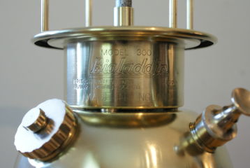

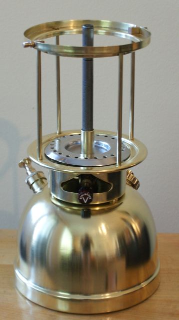

  5. Cigarman
    Cigarman Subscriber
    Aug 23, 2014
    149
    Quite the transformation. What steps did you take to get the tank to this level of shine? Wish my 300x was this nice but it wee's on itself from a leak somewhere on the tank rim.
    16,879
    It's progressing! :thumbup:
  7. Tomih
    Jul 23, 2015
    16
    Fine sandpaper dry/wet sanding, then chrome paste/buffing wheel.

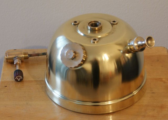

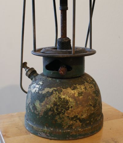

  15. Tomih
    Jul 23, 2015
    16
    ...and more cleaning...
  16. Manlee
    Sep 4, 2015
    51
    Tomi, this looks fantastic, and to look at the original pics and then compare them. I am very new to this world, but will say now, it looks fantastic. How much time have you spent on it to get it to where it is?
  17. Tomih
    Jul 23, 2015
    16
    Thanks!
    I´v been cleaning it every now and then, so I dont know how many hours spent..

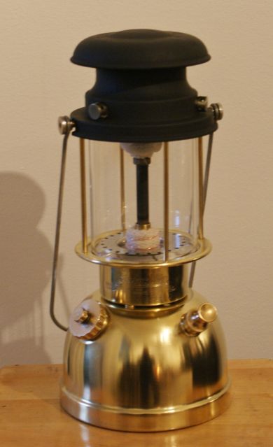

  23. Tomih
    Jul 23, 2015
    16
    Finished!
    Well, almost..no enamel, only heat resistant(600c) paint :whistle:

  25. David Shouksmith
    Happy polishing! :doh:
  26. Manlee
    Sep 4, 2015
    51
    Lovely Work! Call me a heathen, but i do think the 300X look great in brass.
  27. Tomih
    Jul 23, 2015
    16
    Thanks! 8)
