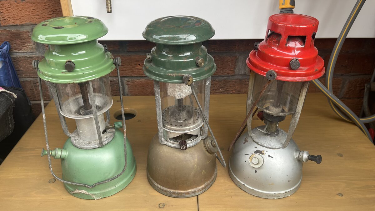

    Just recently won this lot online at a local auction house 310, 315 & 305
    Didn’t have time to go and view this lot but the online photo above didn’t show up any real concerns and they were going just to cheap couldn’t resist a cheeky bid

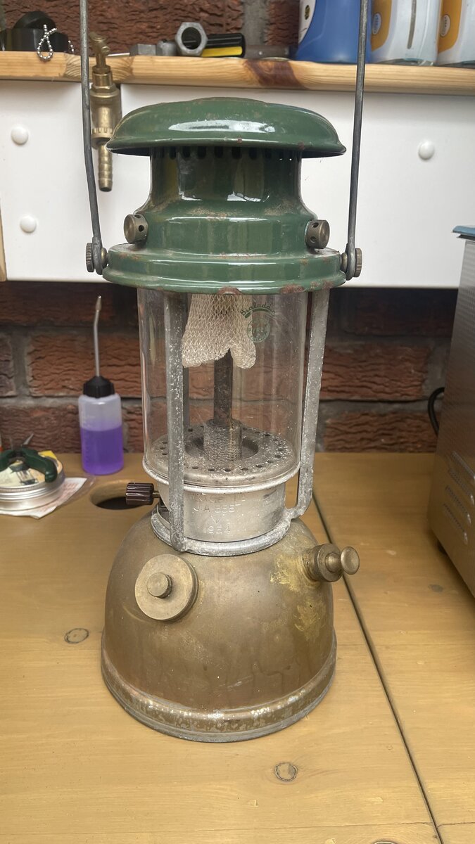

    Collected today and a quick once over they all look in fair condition tbh no costly issues of concern screaming out so far
    The 315 does have a cracked shade around the bottom rim shame really as it’s got the original stamp on it
    but will do for now until a replacement comes up
    I’ve been after a 310 model to add to the Bialaddin Collection this was the main interest in having a punt at this lot

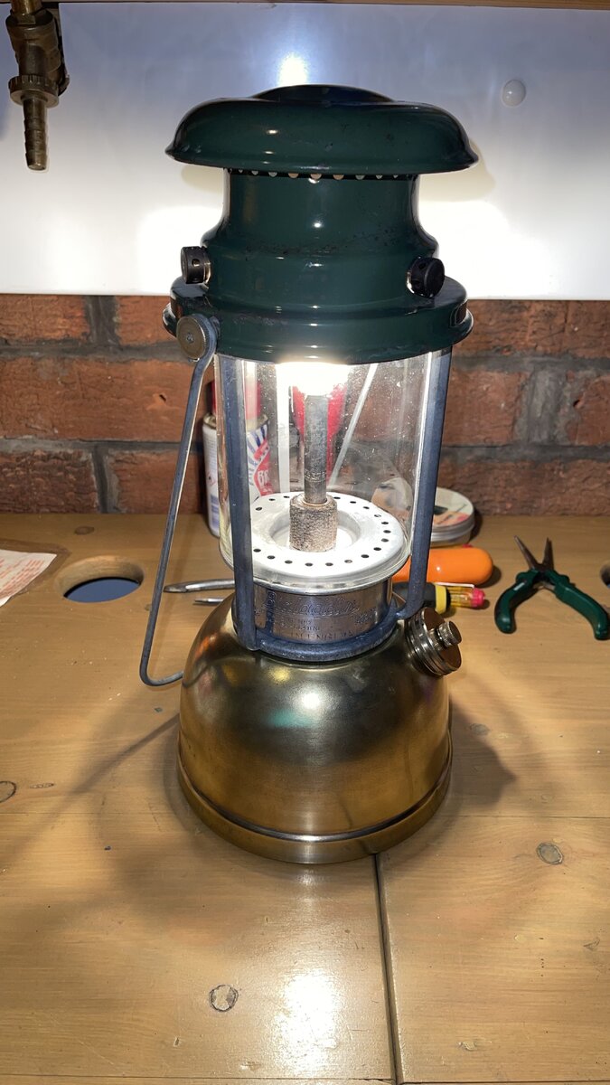

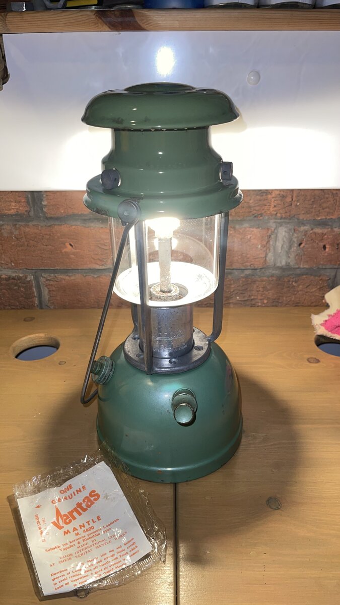

    Anyway decided to give this one a fettle up this evening and after good clean the hood and vaporiser went in the ultrasonic cleaner for a quick blast
    One or two seals changed it fired up nicely with no leaks so far

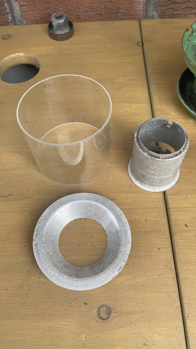

    Have a bit of a question regarding the shade setup on this 310 model lantern as I have yet to see one with the alloy collar and the glass sitting directly on top
    not sure if it’s original or an aftermarket setup if anyone has any knowledge feel free to comment
    All seems genuine but I’m struggling to find any info
    Burning away nicely

    Thanks Jeff makes sense now
    Will probably leave this in its current configuration and source a replacement glass in the meantime
    Will try it in the 320 once I start fetttling either way I need a replacement as the current one in this setup is cracked around the base but usable for now

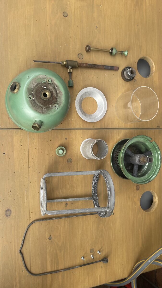

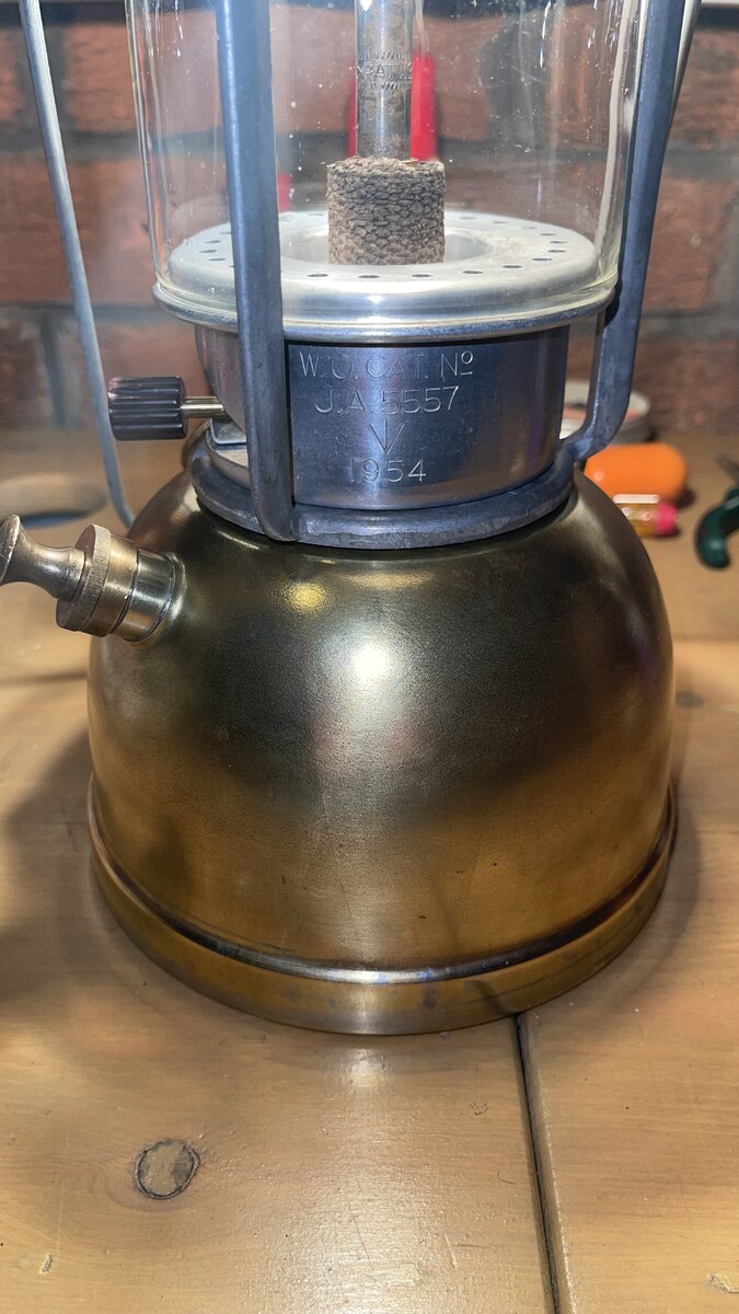

    Decided to give the 305 a strip down this evening
    Was quite surprised what good condition it was in compared to the 310
    Noticed there was quite a lot of solder right around the bottom rim that definitely looked like a repair of sorts
    Wasn’t until I got everything out the ultrasonic cleaner noticed there was a Crows Foot mark with date 1954
    I can only assume these were repaired and serviced by the Army back in the day

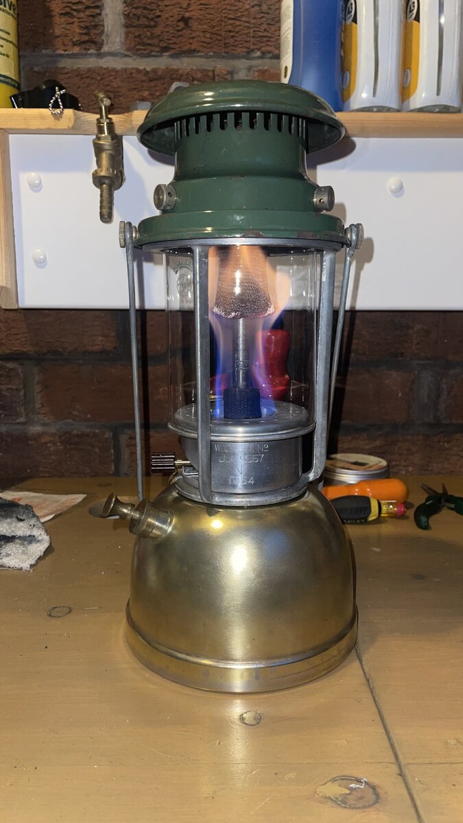

    Anyway the 305 fired up nicely once back together and a few seals replaced

    Hi bigstu
    You will find that those older bialaddin tanks came out of the factory with a rim of solder round the bottom edge,
    I assume they were dipped to give a smooth finish prior to painting
    Regards Ian

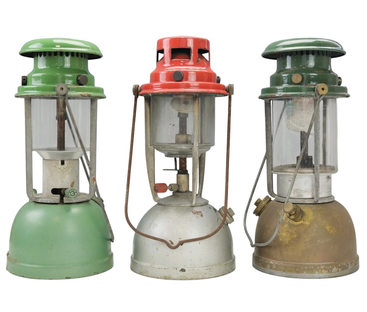

    BTW it’s a 320 not a 315 , 315 has the same frame as the 310 with 3 securing screws but exposed ,320 has a single nut
