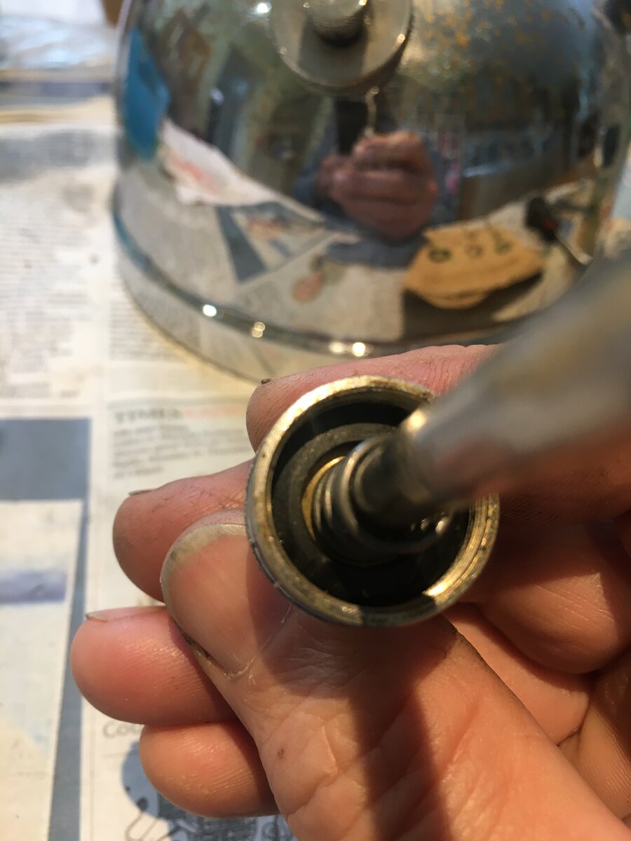

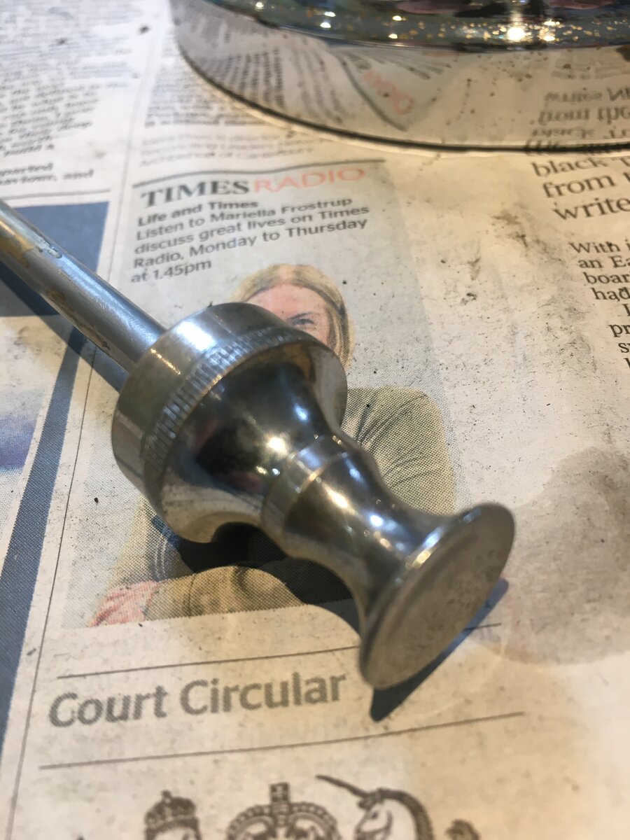

    I know that I’ve done something wrong because these 63666F58-0A94-4FED-AC89-8C86AD5A85B5.jpeg washer sets have obviously been going for donkeys years. I just don’t know where I’ve gone wrong because 8 + 1 washers came off it.....

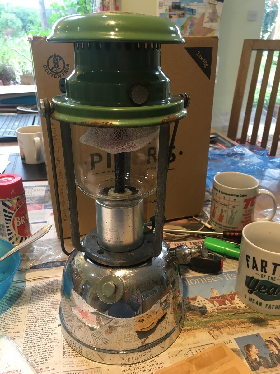

    The two washers on the pump are the leather one and one under the ‘nut’ which secured it to the font.
    From memory, it’s v33 - ‘pump valve external washer’ and it fits like a glove. It’s the same size as the one that came out.

    I’ve removed the washer under the pump top collar.

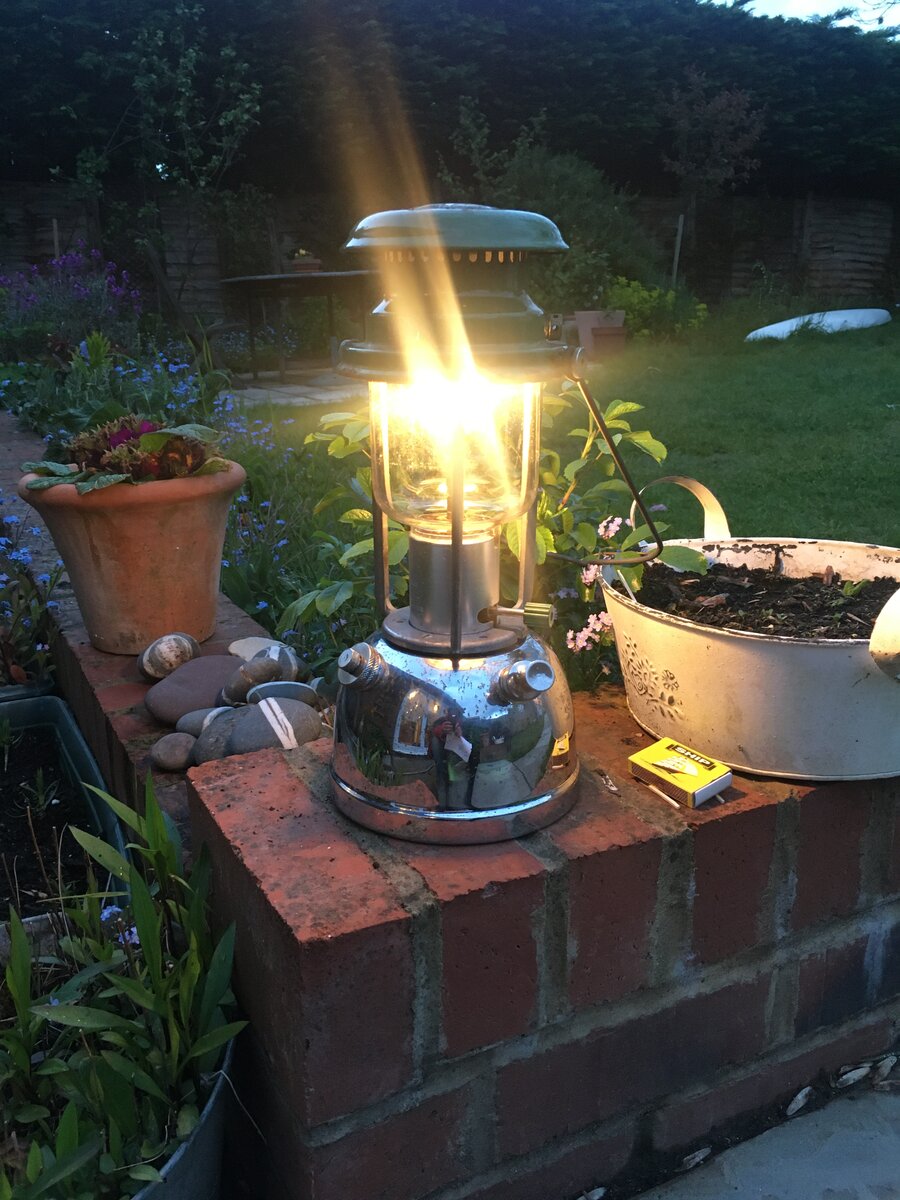

  13. philly United Kingdom
    May 8, 2021
    22
    Reading
  14. JEFF JOHNSON
    16,574
    It's working well!:thumbup::thumbup:

    That looks fine although the redundant washer under the pump collar was never going to stop it working. It might have perhaps reduced the length of the pump-stroke by a couple of millimetres but that's all.
    Correct globe, too - be careful with it...

    I get messages asking for a washer for the pump collar or telling me it's missing from a kit quite frequently. In a lot of cases the new owner found a washer there from it's past life & assume it's correct. Likely from a vain attempt in the past to fix a NRV leak without fully understanding how it works.

    If the rationale of sealing the pump-collar had anything about it (which it hasn't, obviously) then logically there'd also have to be some attempt to seal the pump-rod into the pump-collar...
