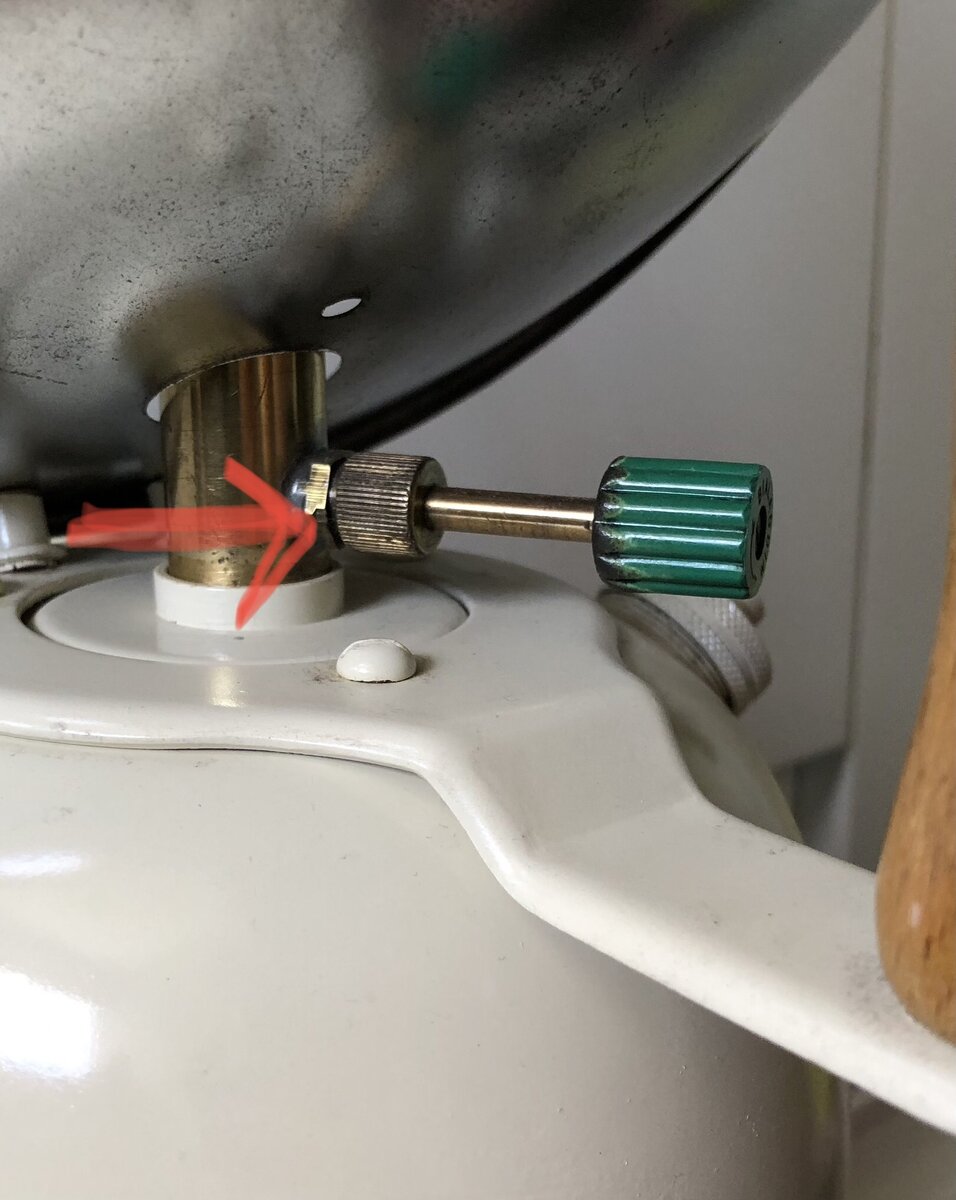

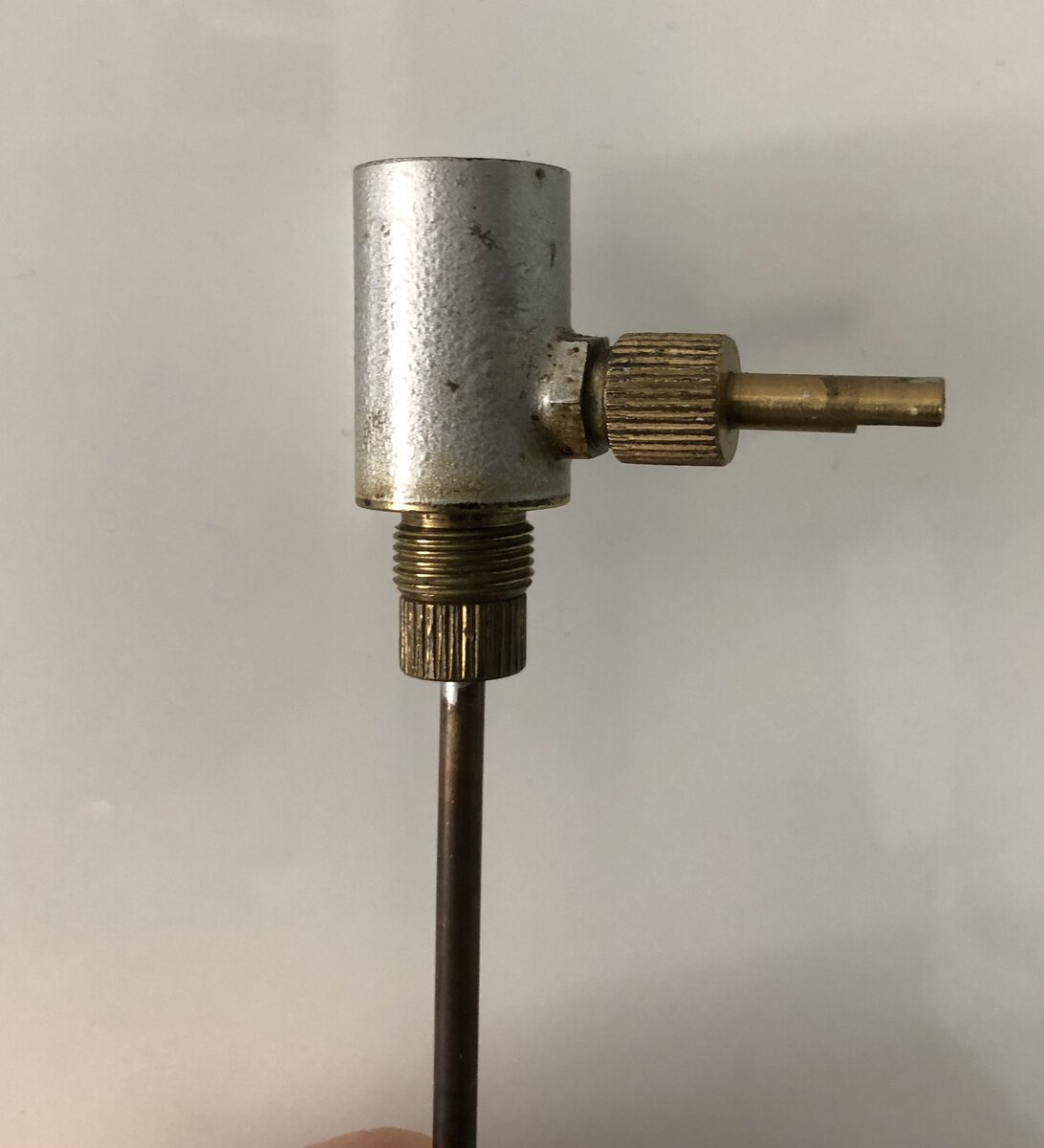

    The last of the shed lamps is a Bialaddin 310. Having replaced all the seals and pump leather it lights but sadly leaks fuel. I initially thought it was the seal where the fount meets the vaporiser however I’ve now realised it’s the nut where the control column attaches to the vaporiser (By this I don’t mean the knurled sleeve which holds a viton seal but the part which this screws onto).
    It appears to have originally been soldered in place but it appears to have been unscrewed at some point thus breaking the solder seal.
    My question is: is the control cock/ vaporiser on the 310 the same as other bialaddin models? The 315 looks quite similar?
    The assembly is fairly beaten up so I’m considering replacing it and keeping the original to repair at a later date.

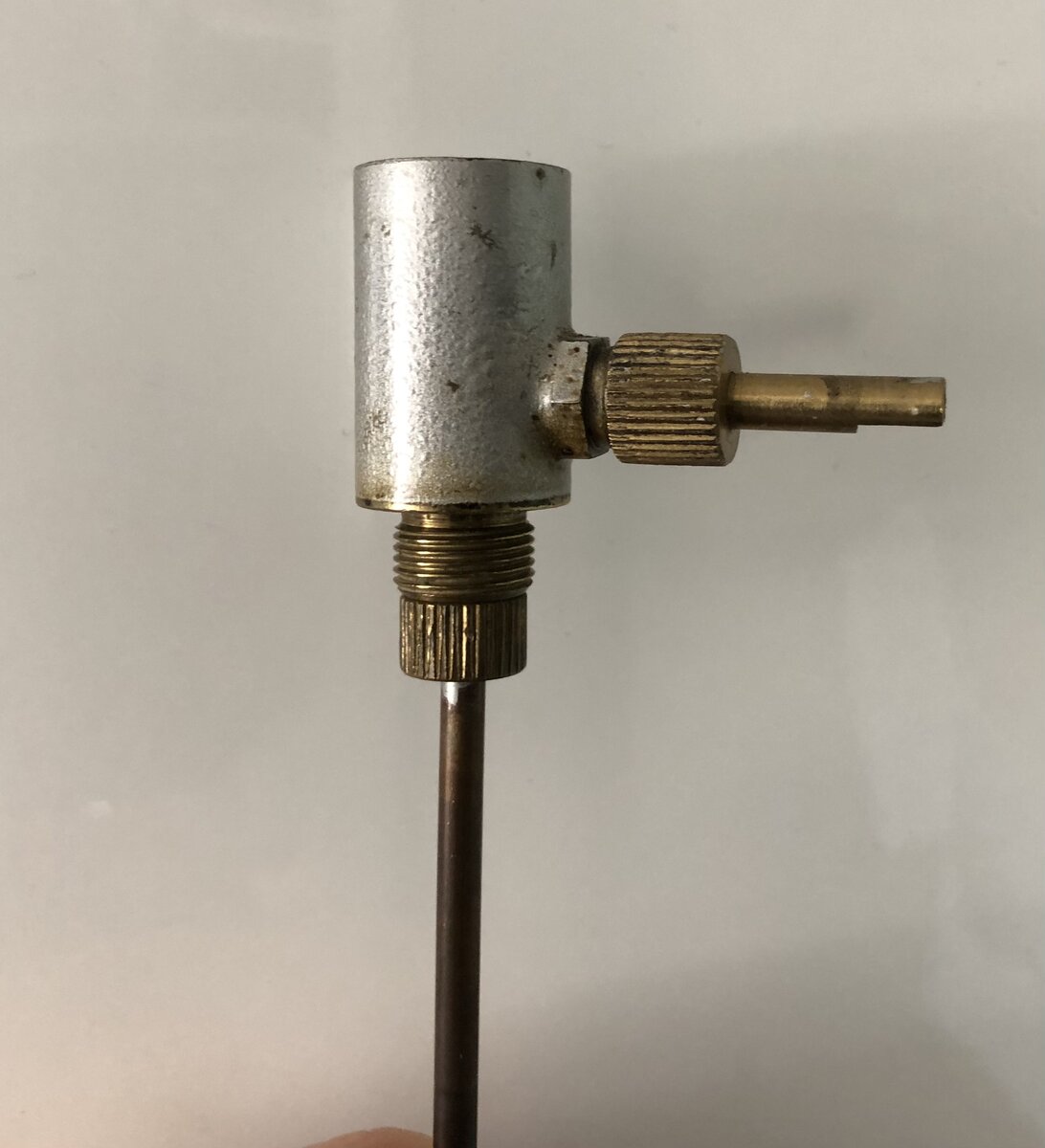

    do you mean this nut?
    about your question will a control cock from a 315 fit, well, it will go on.. but im not sure if it will ‘fit’ ?
    here is one from a 315
    as you can see the spindle is shorter than the one on the heater (which i think is the same as the 310)
    i will measure them and post the details here so you can check your options
    regards
    pb

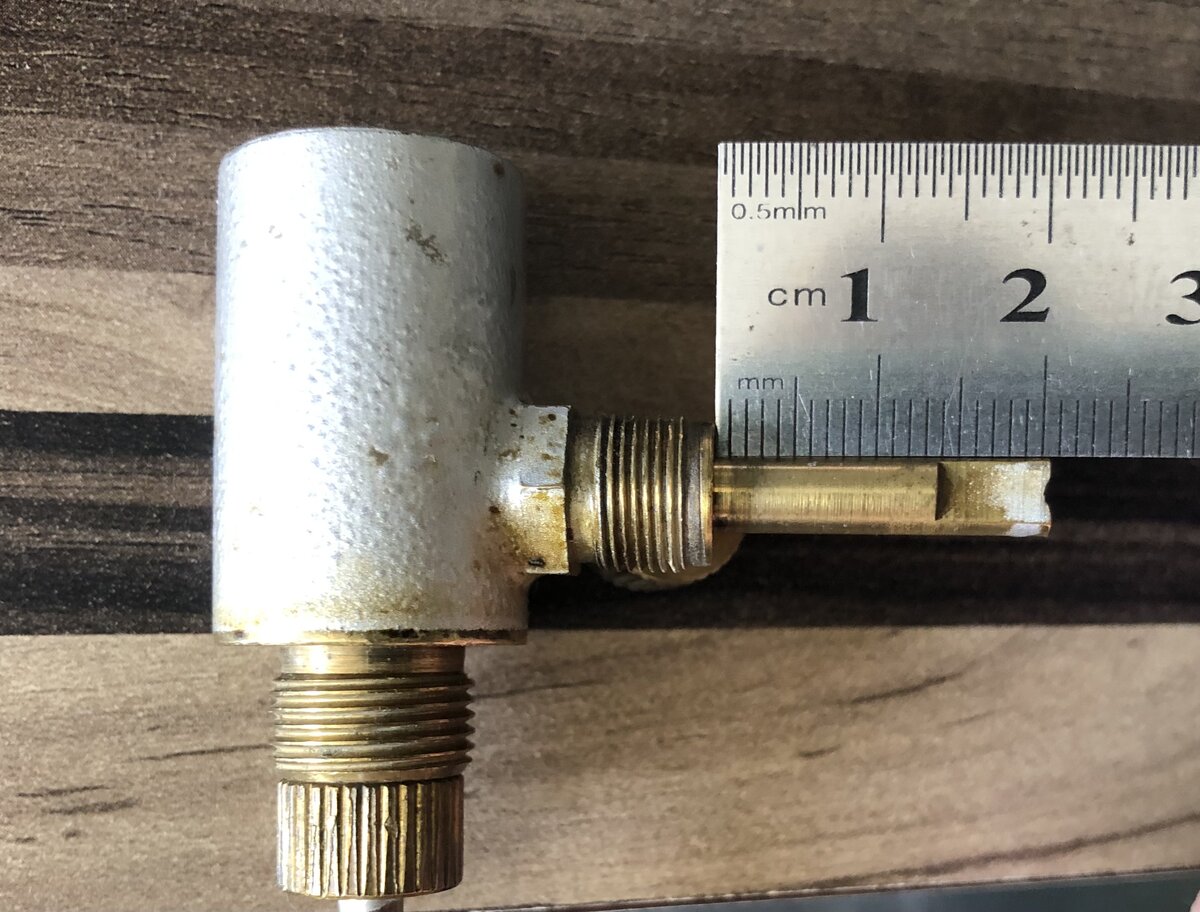

    :edit : ok here are some measurements for you ; 315

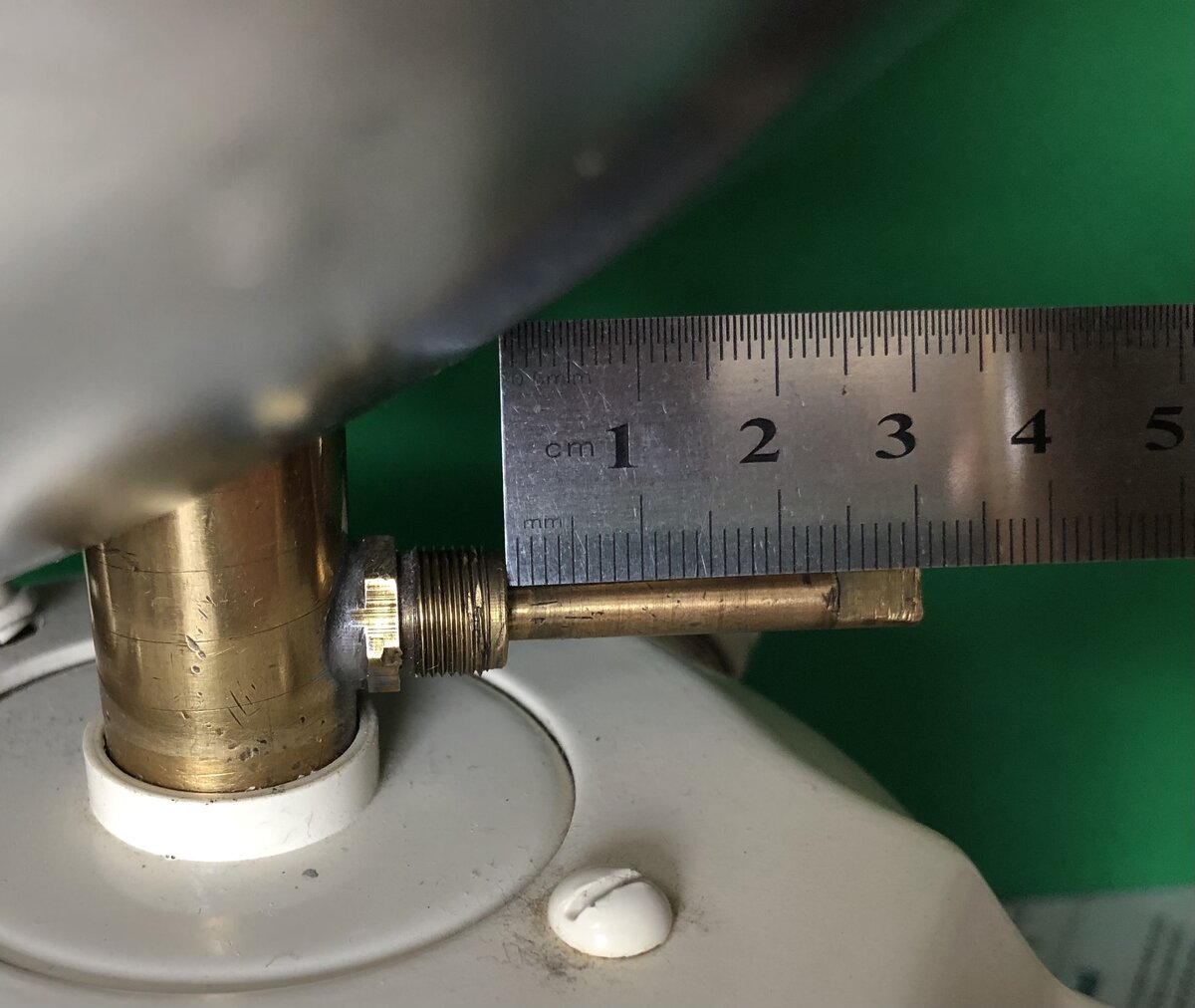

    ..and the bowlfire heater

    thanks for the photos and measurements, I haven’t considered the spindle being shorter
  5. podbros
    4,044
    Hiya

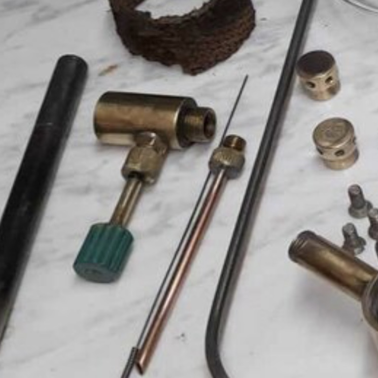

    aye, i dont have a 310 to dismantle at the flat, but the one off my heater looks the same judging by this image from the gallery
    willis & bates made lots of their parts compatible so it’s possible that one from an earlier model could be used?
