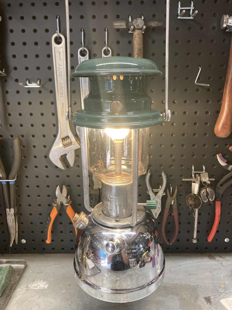

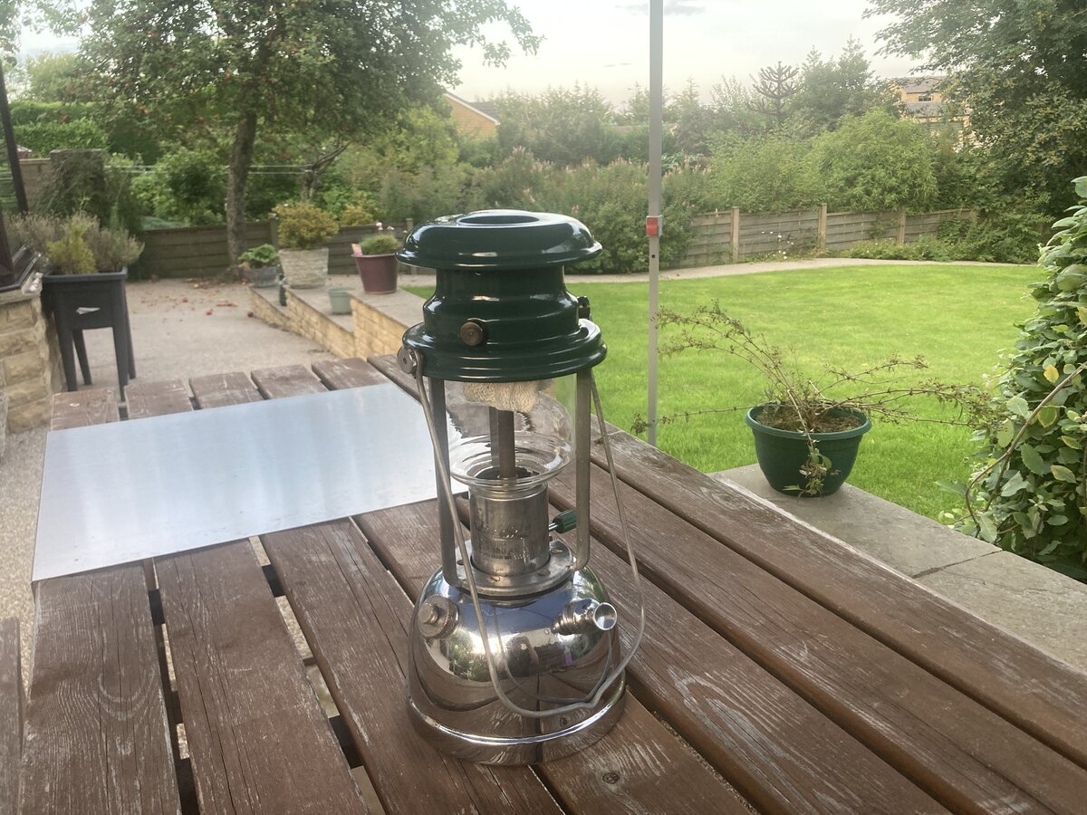

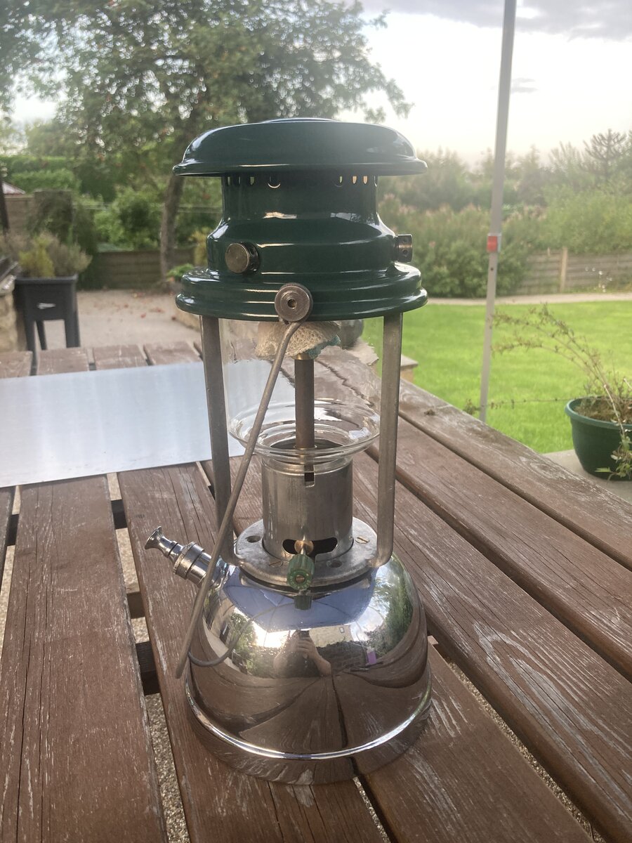

    I have always been drawn to the 310 and finally managed to pick one up a few weeks ago. Easy clean and service to get it running. I have put a repro hood on as the enamel was going on the original so that will go into storage and the repro will do the work. Clocking took a bit of work as fully nipped it was in completely the wrong place. Made a thicker washer and that was resolved. The 300X is the star of the Bialaddin line up in my opinion, but I do really like these 310!

    Only thing I’ve found with these is that it’s not easy getting into the preheat cup. The globe doesn’t lift enough and the gap in the collar is really small. Need to fashion a filler bottle with a finer tube.
  6. Fireexit1 United Kingdom
    3,536
    Yes "not easy" is an understatement. Squeezy bottle and using the little gap is the best way forward, but still "splashy" :lol:

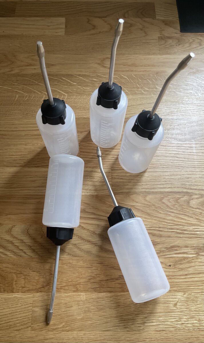

  16. Paul Burnell
    Paul Burnell Ireland Subscriber
    May 12, 2023
    176
    Ireland
    These worked a treat.....I even sealed the cap with a tiny rubber bung like you said.
    Great bit of kit.
    Thanks Bigstu
  17. Bigstu United Kingdom
    Jun 6, 2012
    47
    England , Cumberland
    Yes Paul finding these very useful Meths containers easy to control pouring :thumbup:
    like you say small piece it rubber or silicon applied to the cap works a treat to seal them
