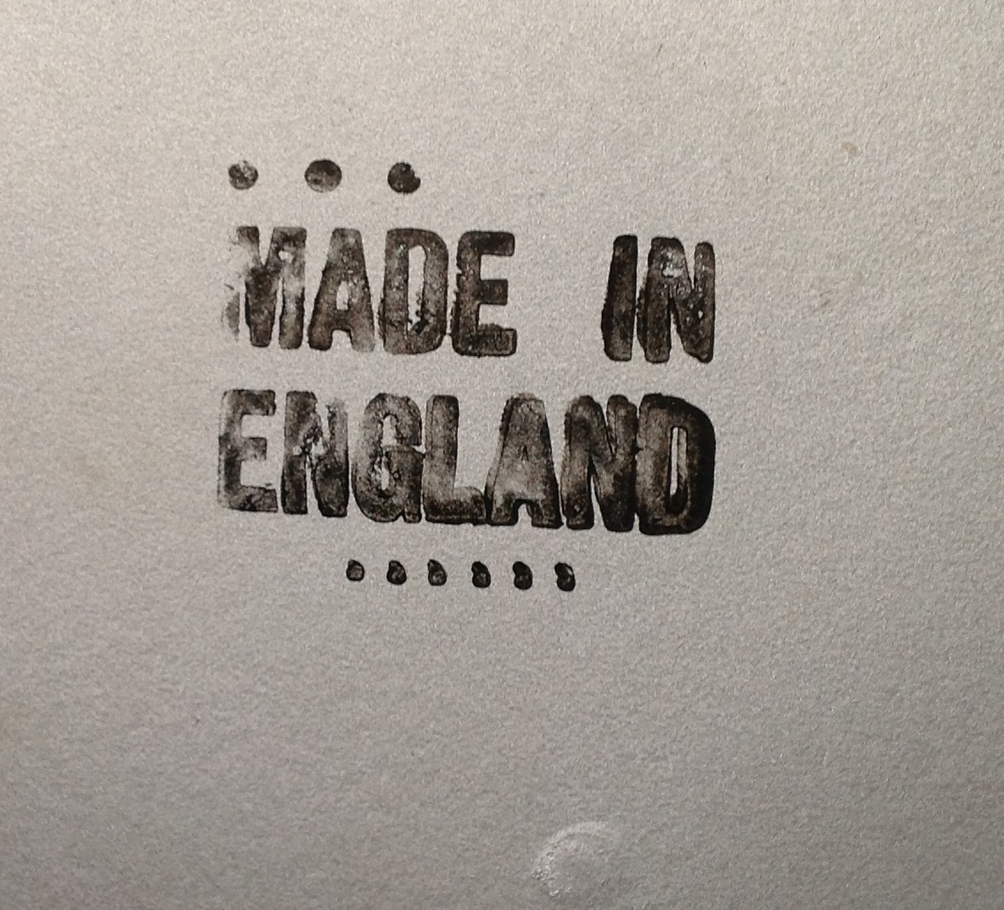

    Can you date a Bialaddin 315 by the dots that appear in rows above and below the Made In England marking on the bottom. I know they were made between 1958 and 1965 but I noticed in the gallery pictures a 315 that had 6 dots above and 5 below. Could be 1965, but mine has 3 above and 3 below which doesn't make sense.

    Here is a picture.

    If it is a date code then judging by the one above, the small dots are likely to be months and the larger ones, years. November 1964?
    If it is years on top and months below, then those two would be May 1966 and March 1963. Peter Sunderland's information (FWIW) gives the production period of the 315 from 1957-1966 so the theory is still holding water - just!

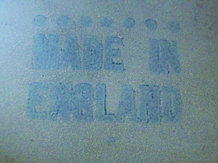

    Here's mine for comparison, this would make it June 1963.
  10. burntofferings United Kingdom
    Jul 27, 2013
    209
    Looking good for a date stamp then, apart from the one with 6 dots if they were only made until 65, but as I think they were actually made until 67 it's all looking good for the date stamp theory at the moment.

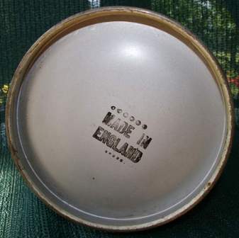

    Based on this hypothesis, my two 315's have 8+5 and 8+6, thus meaning May and June 1958. Up to now this does seem feasible.

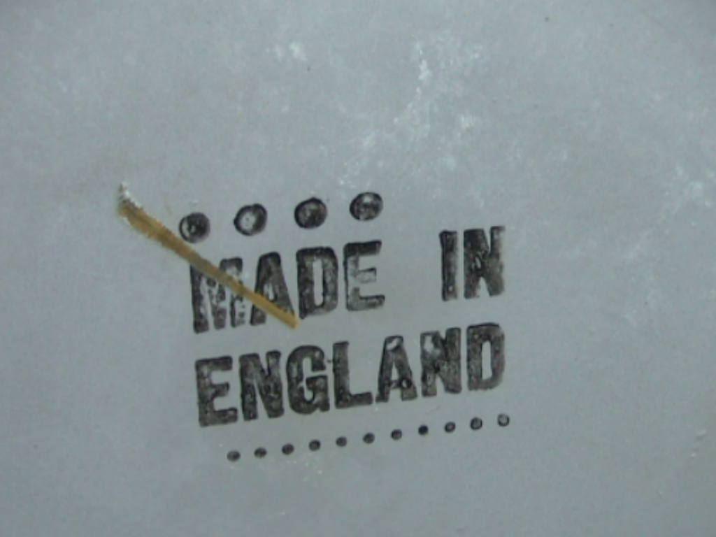

    This one would be January 1967 then? Steve
  25. David Shouksmith
    Possible, but we need far more examples to know - maybe they changed the ink colour to blue from black to distinguish 1967 from 1957.
    Still, so far we haven't found a pattern that defies the theory...
