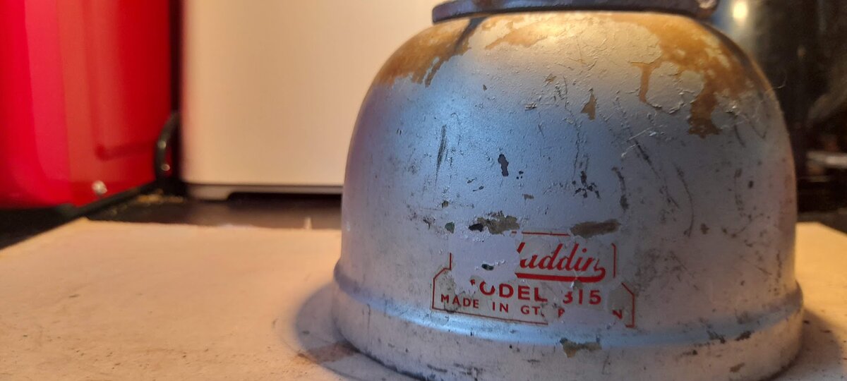

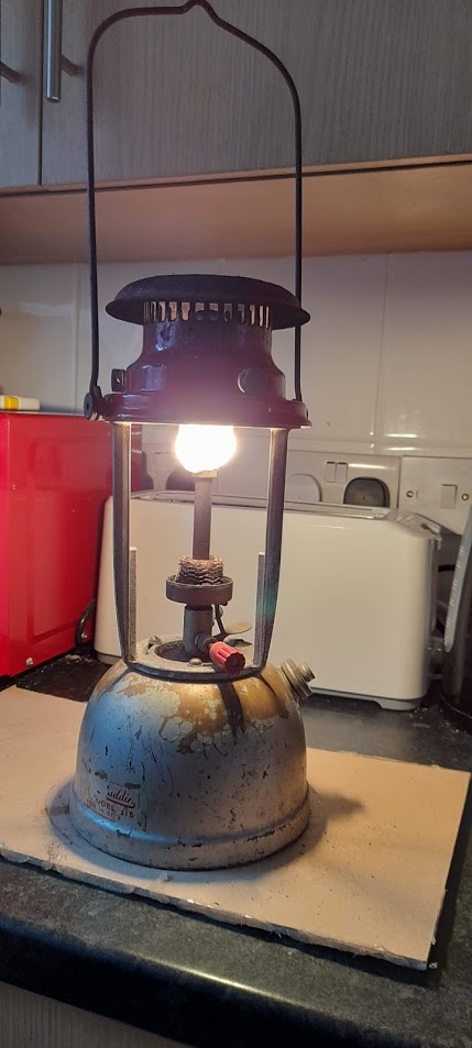

    Picked this Bialaddin 315 up for spares, and she fired up lovely first time after a brief check.
    I have plans for this.....She's a bright one!

    A perfectly good lantern.:thumbup:

    @JEFF JOHNSON Yes, very good nick, and I was surprised! Seals all good, Pump excellent, no leaks, pricker rod OK. There is a glass for it somewhere.....
  4. BigStevie
    Too good for spares! Working well.

    @BigStevie It took me by surprise, I checked the pump....OK. Checked for Needle up/down...OK, I then thought 'why not'....stuck in some paraffin, and a mantle on and fired up.....Popped into life without a flicker. Left it for half an hour and kept eye out for leaks...Nothing! Got a good one there. :)

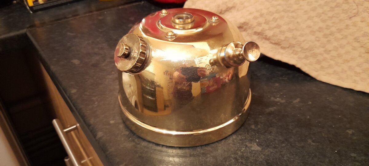

    This might be part of it eventually....What do You think?

    I depends what are trying to achieve, that tank is from a 300X. You could couple the 315 frame to it if you really wanted to, enjoy the 315 as it is or restore it. You can date it with the dots underneath. (Big year, small month) Decals are also available.

    I wouldn't swap tanks if it were me, especially as it works so well. The tank can be sprayed up and new decals are available on eBay I believe... if you want to spruce it up a bit but I'd save the shiny brass tank and try to gather enough parts to complete it in its own right. Just my two penerth!
