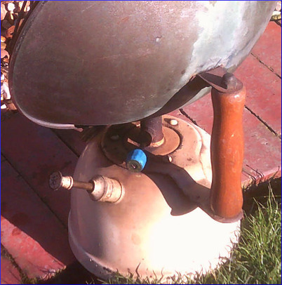

    I got a Bialaddin Bowlfire off eBay this week for £27.00.
  25. Henry Plews
    3,051
    @Carlsson
    When I've finished fettling the two lanterns that I'm busy with, I'll clean the heater and post pictures in the gallery.
    Henry.
  26. primaxel
    Aug 31, 2017
    115
    @shagratork
    :thumbup::thumbup::thumbup:
    I think i was watching this Bowl Fire...
    ... in good condition with a blue control knop.
    Congratulations!
    Regards, Frank
  27. shagratork
    361
    Durham, N.E. England
    @primaxel
    Yes, that is the one.
    It is a 'Collection Only' and the place is not far from me. I am picking it up on Thursday.
    Regards, Trevor

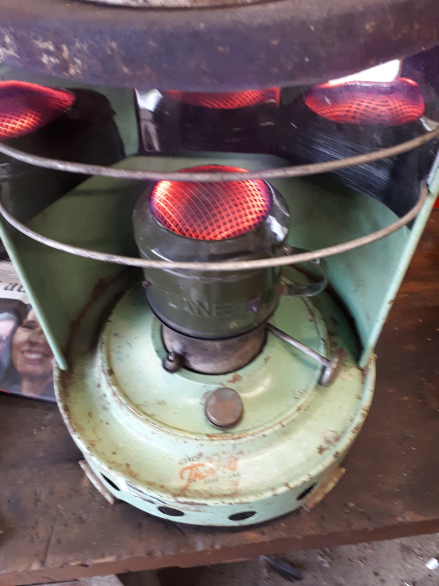

    Great for the fettle shop, Ok I know it's not pressure,but burns almost anything. Aussie made, maybe patent flogged from Europe.
    Keep warm by the light toad

    Now blue would be unusual - red, green or black, but not blue... :-k
  30. shagratork
    361
    I don't yet know if the blue knob is original.
